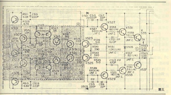

I dont think its that amp then, its a non switching AB and that sounds more like a class a amp. I found this on a chinese site though, the pick says its a audiotek from 1978, and I kinda like this scheme, the current mirrors is the way to go but I still have to figure out exactly how this implementation works.

That is close to the JVC , it is using the cm's as the wave shaper
(same as the resistors and diodes in passive version) I was already heading
in this direction in my sims using the diamond to feedback
the class a "bias stop"...
Q5 and 6 can be left out if you are only using a Standard
Type 2 EF as they are only acting as 2 more Vbe's in
the circuit... 🙂 🙂 the huang 4 ..what a name..🙂

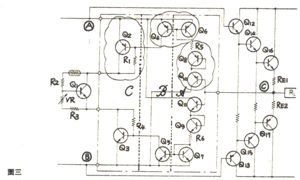

QUOTE]Homemodder - This one shows it better, isnt this the jvc scheme[/QUOTE]
thats the JVC...drawn better than the sevice manual..

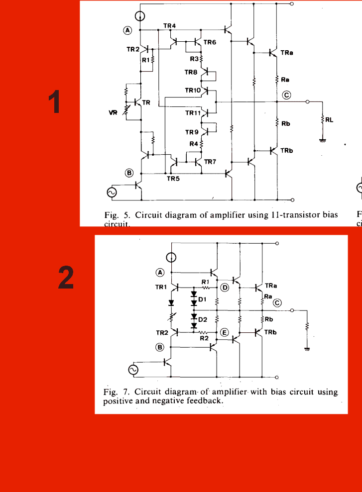

By andy - Have y'all read the AES article by Tanaka (from Sansui) about non-switching class B? It's called New Biasing Circuit for Class B Operation from 1981.
Hello, Andy... Yes, the more technical info the better.. I'm finding
clues around every corner...

Have you delved into the tanaka fig 5 and 6 , I have been successful with 2-4 , even getting 4 to behave with any load
or frequency... (I'm doing 5 in LT now).. TIA 🙂

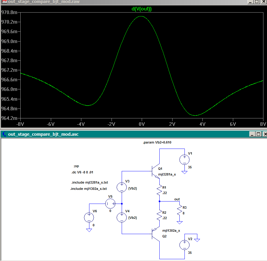

I haven't. I've lost track of the thread now, but Bob Cordell's warning is worth repeating. Just because the "other" transistor is prevented from turning OFF doesn't necessarily mean that distortion is reduced significantly. Ahh, I've found it. His comments are here.
Doug Self has an interesting way of looking at output stage linearity in figures 15, 16 and 17 on this page. You can duplicate these plots in LTspice. Doug's plots represent the incremental DC gain vs. output voltage. Ideally, it's constant. He gets these plots by sweeping the DC input voltage to an output stage in small increments, say 0.01 Volts. If you look at a swept DC plot of Vout vs. Vin for an output stage ("DC sweep"), it looks to the naked eye like a perfect straight line. But if you compute the slope of the line between each successive point, the variation of that slope is easily seen as in Doug's plots.
The optimum bias current for a standard complementary EF with 0.22 Ohm emitter resistors is 107 mA according to Self's criterion. So try an output stage with that bias, set by ideal voltage sources between the bases. Then do a swept DC in 0.01 Volt increments. To plot the slope, use the undocumented LTspice d() function. If the output voltage is V(out), plot d(V(out)). This is the slope between each pair of points. I usually put an input offset voltage in there so that with V(in)=0, V(out) is also zero.
Then try the same thing with a non-switching class B circuit. Is the slope more constant? The plot scaling needs to be the same for comparison of course. It may help to divide the slope of each plot by its value at an output voltage of 0 for a fair comparison.
Edit: This may be hard to do with the Tanaka arrangement. I haven't thought that one through.

not "crumbs" in andy's paper.. will do 5 and 7 to see whats up.
(attachment)
