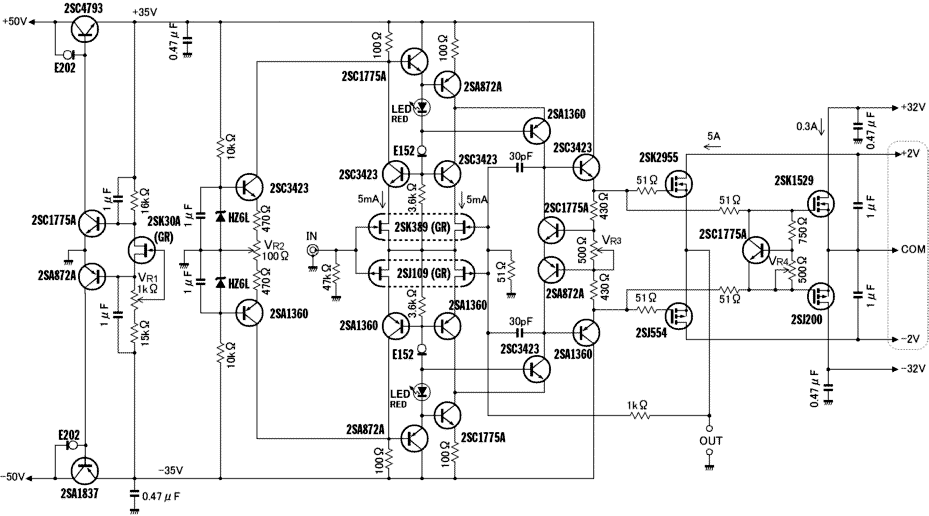

atiq,
Is yours an example schematic from one of those japanese harmonic canceling amps? Can you briefly explain it's workings?

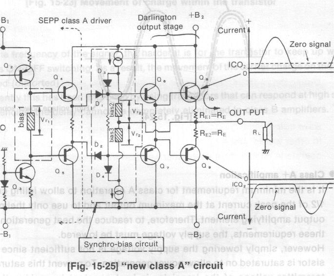

atiq19, no Im not going that route but it does look good except for even more complexity, technics have 2 schemes, one is new class a the other is class aa, I think the scheme you showed is like the aa type, unfortuneatly I cannot see the document proposed by jkenny, this might be interesting as this is the route I took but bear in mind that this is not possible without a non switching scheme in the first place, or so I found.
The design concept is to try eliminate high even and uneven order distortions in outputstages, this has been worked on by others, the easiest to see how this works is to see an example of someone elses work and what they tried to achieve and why I gave the mitsubishi amp as reference. Giving design concept schematics is like giving the design away, its easy to work from there, look at Ostripper, he got it, change the resistors to current source etc. Technics secret was out in the open as soon as they gave even the crudedest indication of a design concept schematic.

I attached the schematic from 'evolve power amp' website. yes it is japanese.
In simplest term,
lets say we have 50W output of an amp.
8.5W will come from class-A amp contribution.
42W will be taken care of by class-AB.
composite operation is compareable to class-A.
the most subtle feature is rail tracking.

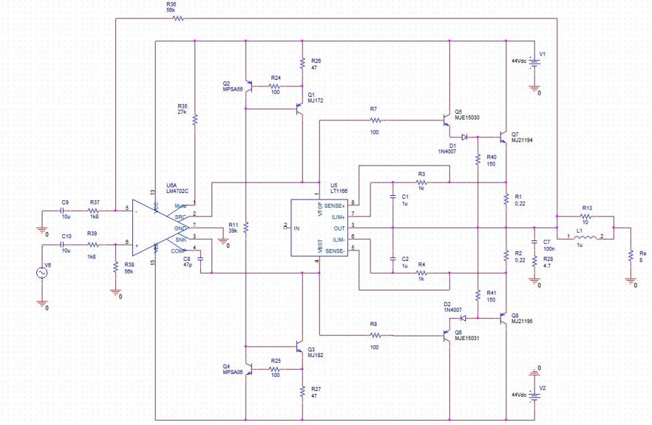

Steve -When you do your sims on the non switching output stages do you also do a stepped DC input
I do step the input waveform to simulate various levels
(.01, .1, 1, 1.77v) and different frequencies (100, 1k, 10k)
to see if the circuit "holds true". just recently I started using
(2, 4 ,8 ,16R) with capacitance.. to simulate any load
expected.
I will try stepping pure dc, it might help in stabilizing the sourcing
of the class A operation.

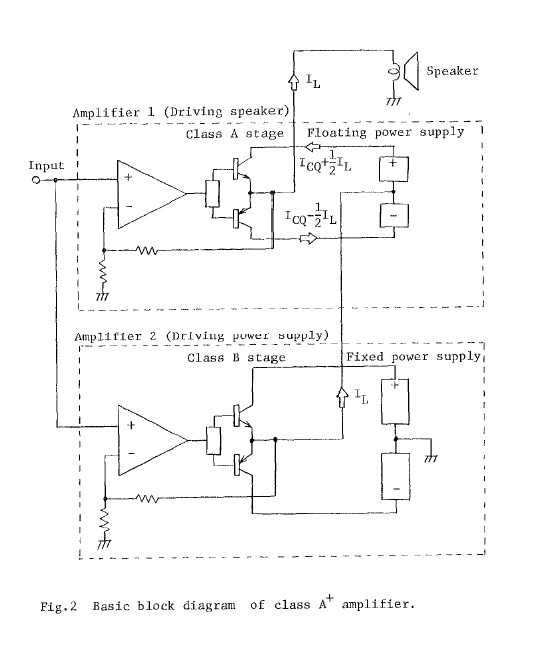

Byatiq19 - Here is the concept for Technics class A+.
I think the "new class a" does what amp 1 AND 2 do, but
with 1 Op stage...
OS
No problem atiq, I saw that conceptual schematic with the floating PS on the output - these guys can't even get their head around that concept http://www.diyaudio.com/forums/showthread.php?s=&threadid=137422&highlight=
The whole thread is wasted discussing what floating PS is😕

I have managed so look JVC AX-9 service manual. I don't think this is an elegant solution compared to Technics. I suspect it was probably a marketing hype in 80s. Who would waste 560W idle power for 100W heater?
It would be interesting to see OS realisation of Technics' technique in Frugal amp.

OS
I think there are posts here about a design flaw in the LT1166 chip - affects the sonics
edit: But I don't know how big n issue - could be worth trying?
lt1166
