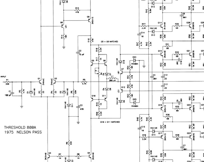

Here is another biasing (imporovised) scheme from Mr Pass. I believe this one is elegant solution and proven in threshold models:

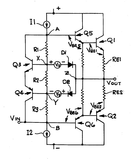

Andy, Os,
What I understand by Dynamic Xover distortion is that caused by the turn off of one O/P device & what I understand by static xover distortion is the change in transconductance as this turn off point is approached (see Bob Cordell's description below)
So just having one device slightly turned on with low bias can result in static xover distortion is Cordell's contention. I don't know which of these biasing schemes best avoids this?
by Bob Cordell - It should be recognized that bias circuits that prevent the "other" transistor from turning off in an otherwise class AB amplifier can improve the sound a bit by mitigating some of the switching distortion. HOWEVER, this is not class A and DOES NOT eliminate static crossover distortion.
My question to Cordell was what is the relative importance of static Xover distortion i.e. are we chasing the last 0.1% or is it a significant percentage? Does this static distortion appear in simulation?
By Bob Cordell - Static crossover distortion is caused when the net transconductance of the output stage changes as the signal-handling is transferred from one device, through a sharing region, then to the other device.
In Class A, both the upper and lower devices are contributing roughly the same transconductance to the signal path through the entire signal swing. Merely preventing one transistor from turning off does NOT prevent its transconductance contribution from going very small or to zero.

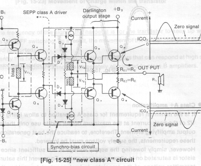

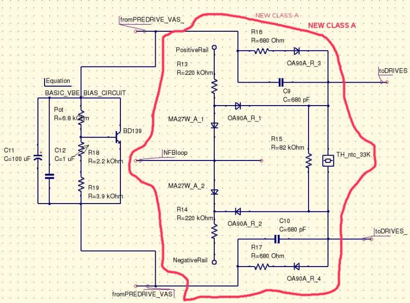

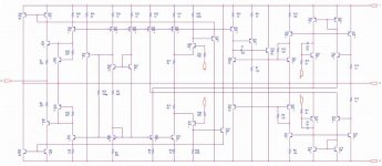

I am following this thread with great deal of interest. During the posts I saw some shematics for Technics new class A. Because some years ago I repaired on SE-A5MK2 I reverse engineer the sychro bias in the AMP responsible for new class A. I do not know if you have it or know it. Anyway I attach it (I believe it is correct.). Note that the vbe part is not the bias adjust circuit from se-a5. I added it as a conventional bias adjusting circuit. This is the think you are descussing, isn't it?. Sorry for interrapting anyway.
Kzeprf22,
Prevoius posts have shown the concept of Tecnics A+ design, where you get a floating power supplied small class-A amp with a high power (4times more) AB amp output connected to the common supply terminal of class-A.
I think we can classify 3 major types:
1. Dynamic/sliding biasing scheme as shown in Nelson pass patent, LT1166, Pioneer patent etc. The bias ckt itself generates bias in sliding mode and also facilitates somewhat non-switching function of the power transistor. This goes in Vbe multipler position.
2. The other is: you keep your regular vbe multiplier or thermaltrak diode bias (rmi-fc100) and then add two diodes and resistor at the base of the power transistor connecting to ground. This allow you to retain your normaL class AB amp as it is but adds nearly non switching operation of AB amp during class-B operation. This has been shown by OS in his Frugal amp in previous post. This was found from technics IC SV2004 series reverse engineered chip internals.
3. technics class A+. Completely different topology. Also not an AB amp although it has got class B amp embedded in it.
The non linera bias generator menat to be thermally intolerant to during its operation while playing high input programme material. However, this is in theory. In practice this also suffers from Thermal Distrotion like any class-AB amp. In this regard ONsemi thermaltrak transistor based solution like rmi-fc100 can be worth looking at for further investigation.
The dynamic biasing is achieved , generally, with some non linear sub-ckts. This non linear bias controller are not able cope well with rail induced x-over distortions during high music picks, IMHO.i.e. low bias current defeats to the high programme material demand. In this regard Technics A+ is immune to rail induced distortion.
Later..
atiq19,
The design I attached is not reverse engineer from an IC is from a big discrete power amplifier, using sychro bias (new class A). The one you mention is also (new class a)? Witch one is the correct? In the Amp I am talking about the synchro bias was between the VAS and the drive transistors.
