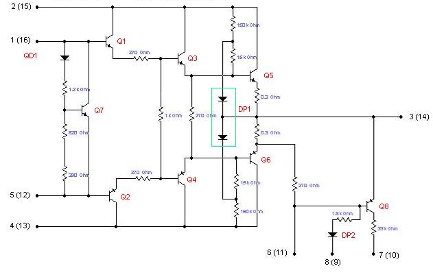

this is the reverse engineered chip from technics, sv2004. very close to synchro bias but is not primary bias generator in itself rather an add-on to the power transistor, preventing complete turn off for power transistors. You can compare this to a charge suck-out capacitor in Self EF-II but unlike the charge suck-out capacitor, this provides non switching whereas suckout capacitor facilitate faster ''OFF'' or ''ON'' of the power trannies.

clarification.
SV2004 diode+ resistor doesnot generate bias rather act similar to charge suck-out mechanism. Q7 is the bias generator.

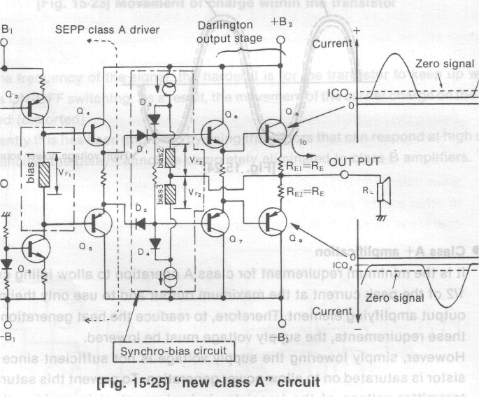

Synchro bias is bias generator and a controller for non switching function.
SV2004 can be added to any hi-fi existing class-AB amp.Presumably without much disturbance to sonics.

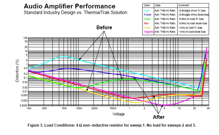

Synchrobias is meant to be dynamic/sliding bias genertor and thermal ditortion needs to be carefully considered wrt to high programme material processing.
clearly at high freq, at 10khz, the thermal intertia that affects any standard bias generator (including sliding bias) is much more prominent as shown in cyan and purple graph.
any non linear bias scheme is not free from this kind of thermal ditortion (bias scheme lags music signal change rate) despite the fact that non linear function/equation does not include temperature co-efficient (negligible).
