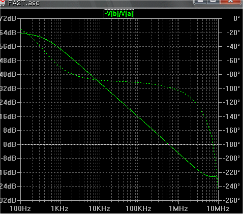

The NFB feedback, I did it a little different (like the quasi amp)
giving me that phase reserve (attached) across a wider range
of frequencies. Changes in R9/C5 - C16 one can "shape"
the margin instead of just setting it at the unity gain intersection.
OS
What unity gain point do you have on that graph, out of interest?
I just quickly adapted one of my schematics to triple and didn't seem to need much other than 47pF on both VAS devices.
I'm using the Fairchild drivers + outputs though, their models are better than the Onsemi ones.
600k for 68pF Cdom , 880k for 47pF , 39 p starts ringing
on SW 🙁 .. (1.05Mhz BTW)
The RC shunt between LTP collectors reduces UG by 100k+
but seems to make for better stability (less ring) into cap.
loads.

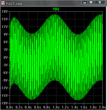

andrew I still think that you make much fuzz about the 1-5hz "band".Remember that this is at -3db.My oppinion is that we are going offtopic and without sense .If you can argument those things mathematical with real life measures I will change my cap 😀.
I want to say that if we put 1-5hz(noise,signal with low amplitude) at input modulated by music signals at the output will be:
1. in your case that noise attenuated by the input filter will be amplified by gain of amp;
2.in my case the noise if it pass by the input filter will pass at the output with an gain close to 1 !!
1.Let's take the example of FA2.At input we have 27k,2.2u so the f=2.69hz.The nfb have 1k+220u about 0.7hz. Assuming a "noise" at input 1.5hz and 2mV.In the input filter will pass only -6db(1mV,2 times attenuated) because at 2.69hz it is attenuated with~ -3db.The noise frequency 1.5hz,at least 0.7hz(zero for nfb and pole for closed loop gain amp) will pass at the output with Vlowf*(1+27k/1k) ie we will have 28*Vlowf at output=28*1mV=28mV.Vlowf is the amplitude of the low noise passing attenuated at the output of the input filter ie Vnoise/2, (-6db).So in your case we have 28mV at 1.5hz.
2.In my case input filter at low frequency set pole at 0.16/(22k*4.7u)=1.54hz.We put like case1(fa2) a 2mV amplitude at input.This noise after the input filter will have a -3db gain because we have pole at that freq.;So here will be 1.41mV (2mV/sqrt(2)=1.41) .The second pole of the amps gain is set by the zero in the feedback network(680+47u).Here pole in the amps transfer function it is at 0.16/(680*4.7u)=5hz.The noise frequency 1.5hz and 1.41mV will be "gained " with 1.So at the output we will have ~1.41mV of noise .
In those 2 cases I neglect the -3db of the zero feedback and pole in closed loop.The differences with this neglection are the same.
If still are missunderstanding I can put an mathematical transfer function in s. H(s) 🙂 .
Wich case is better ? 28mV or 1.41mV of noise 😀

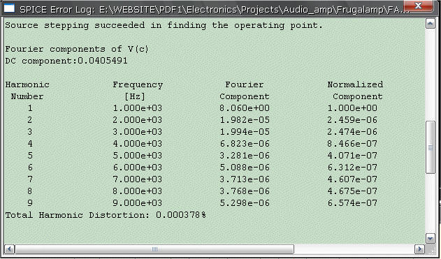

Andy C. gave me a new sine generator and distortion on
the triple is LOW.. (attached)
OS

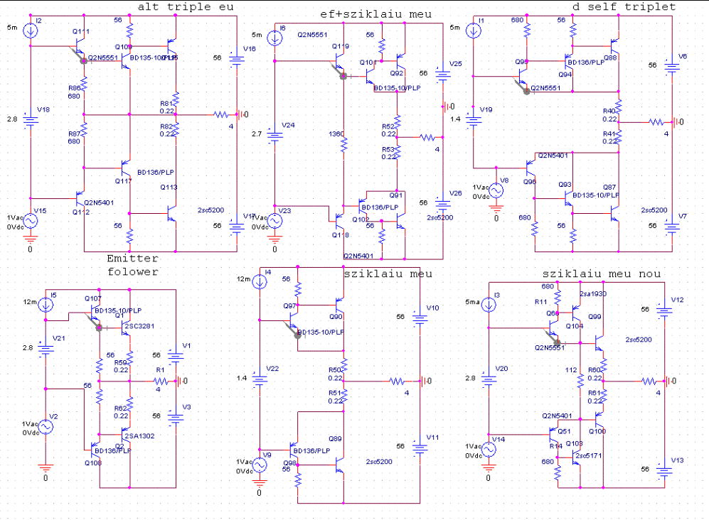

I don't understand why for an amplifier who plays only low freq for subwoofer must be an very low distortion super amp...,music in films is played not lossless ...etc;
Less distortion in triple and double final stage gives the sziklai configuration <0.0001% .I calculate and simulate and that configuration is loading verry little the vas stage unlike the ef .At the same current at output the sziklai absorbed a little current at the input unlike EF.Beside that it have gain and negative feedback(low distortion and higher bandwith). All that improves the thd and dinamic distortion,intermodulation distortion and slew rate.
Just my opinion .I like those discutions .We can learn a lot .
Cheers !
Cheers !

By catalin - I don't understand why for an amplifier who plays only low freq for subwoofer must be an very low distortion super amp...,music in films is played not lossless ...etc;
I guess I could build a project 68... http://sound.westhost.com/project68.htm
But that is a "hack" circuit , best for lamers who are too lazy
to design their own. It would work , but I am not going to hook
my $200 peerless sub to such a primitive circuit.
I've seen subs even run off of bridged chipamps, but that is a lamer
way out as well. I think a "real" amp , at least a quasi mosfet
nmos 350... good amp - NMOS 200 sounds very good with subs..http://www.adam.com.au/cgpap/QuasiWeb/index.htm
Even this would be slacking (DIY = do it YOURSELF) so..
the beast... Earthquake/ shaking killer amp...
By catalin - Less distortion in triple and double final stage gives the sziklai configuration <0.0001% .I calculate and simulate and that configuration is loading verry little the vas stage unlike the ef .At the same current at output the sziklai absorbed a little current at the input unlike EF
I am very interested in your sziklai Op stages , but was told
of instabilities associated with them. Which of the ones
you posted sound the best, load the vas the least, and are the
most immune to load impedance variations.??😕
Also any insight to how you T-comp the stages would be
helpful..
