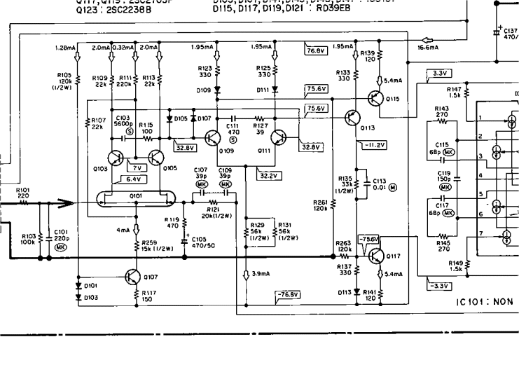

Hi, homemodder. That looks like a pioneer M90 , but more
"amateurish". The pioneer has a cascode instead of that
zener.
The pioneer simulates almost the same as the APT and
most of the harmon-kardon amps (hk870 , 6600)
with dominant H2 and VERY low distortion (.005%),
The apt , like the krill , does this with a frugal device count.
I am going to "marry" the APT and the krill , they work well
together.. .

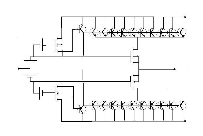

I have added a 3 rd amp which I find to sound extraordinary good to my list of best sounding Diy amps , over the weekend I finished a buzquito type with a triple but using mosfets as final outputs and cfp input. I built it for the university music professor, this amp is as good as my electrocompaniet monoblocs and only loose a little out in the bass with rock and pop music. Going to build 2 high power monoblocks for myself, then no more designing for a couple of years again, Ive had it for now, but thats after I have got one of these outputstages working properly to couple to the modded buzquito frontend, they very tricky when it comes to temp compensation. Then its back to my street racing hobby, have a new car and engine to modify.
I stay away from that Krill thread for obvious reasons , too many ego wars there and over sensitive characters, but I have some doubts about the non switching mechanism, interesting design though. As for the good sound quality which I believe it should have, I think it will sound just like a power diamond would with a conventional vbe multiplier, nearly all of the guys there have never listened to a diamond output stage before and thats the awe around it. With a darlington configuration like Steve uses as output the diamond will exhibit greatly H2 harmonics in comparison to H3.

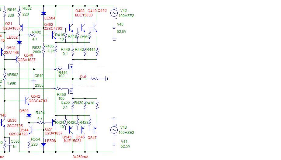

Hi blueskynis,
Have you built or tried this kind of outputstage ???? I got the ideas from some friends some months back and have been messing with this on and off, but now I want to sit down and get it going properly.
VR502 is actually a vbe multiplier, I have it as a resistor just to play around with the currents a little, the mosfets are very high power verticals. Herein lies the problem, BJTs and mosfets dont have same temp coefficient.

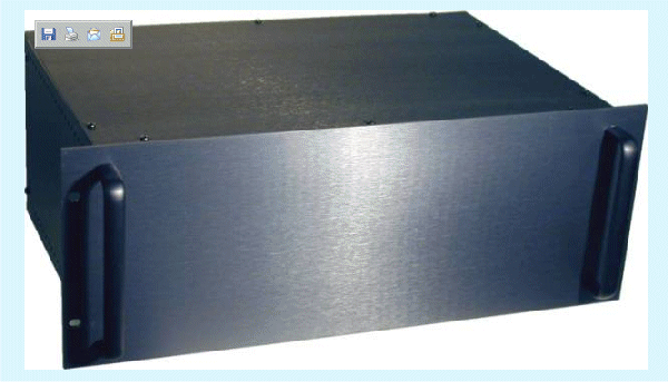

Hi Ostripper! Finally, I got back on track to build your FA1. Today, I bought an amplifier enclosure for it. Next week or so, I'll pretty it up a bit, since its "around" 60 or 70 years old. Nice red stuff with a flip top. http://www.diyaudio.com/forums/showthread.php?postid=1770024#post1770024
What do you think of it? Is it suitable?
The wood is good for temp.. you might want to line it with
aluminum flashing if you want permanance.
I want to move up to a real metal box..
http://www.par-metal.com/
these guys in NJ have by far the best price and materials
and will customize it real cheap. Bud and hammond are
the only others , bud on mouser sells a 19x 17 x5 WITHOUT
the top and bottom for 57$ and sells the missing parts for
50$ more....so no real deal..

Will reinforce. Thanks again!

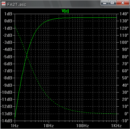

Oh, I meant R2, R15, up to a little higher figure. You see, my speakers are going to need some help with the lower bass, and I didn't want to make the nfb cap larger than the power cap/2. And, its a lot easier for me if the input cap is 1uF or even half that much. So, that's kind of what the question was about.
It looks quite doable as is, but I thought I should ask about a possible 47k option.
Edit: I didn't mean any disrespect--I asked because I just don't know.
Dan, R2/ R15 affect the over all gain of the amp.. C3/R4 and
R1/C1 are the main players for LF rolloff.
With the listed values , you get -3db at 3hz (see attachment)
with 1uF for C1 , you get -3db at 7hz. So specwise
this amp does 5hz (-1db) to 100k (-1 db).
In the real world , fa3 (same components) I can "flop" my
sub back and forth at 5hz with little drop in output.
You will have no bass issues... unless you want
to power a motor servo with it.

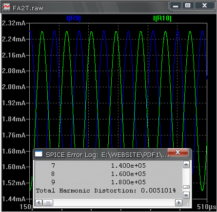

The circuit is amazing (attached) talk about LTP balance,
throw a driver or anything in for one of them, it still works
and gives .005% thd20..
I am going to SMD this input stage and drive krills with it.
2 - krill OPS's and 2- these FA2T's will be built soon.. .
