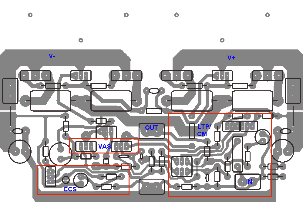

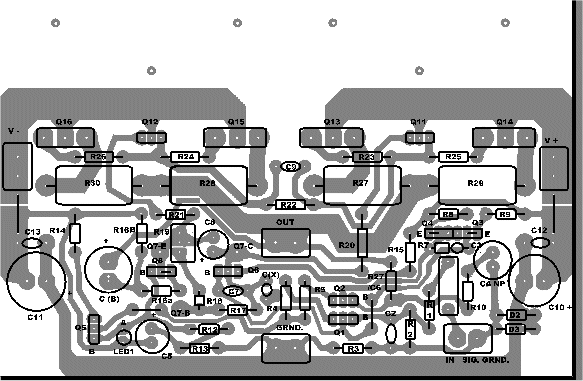

NEW 4 in 1 UNIVERSAL "NEWBIE" BOARD
It was just a little harder to design a "universal" PCB, but
This one should do nicely for all the "schoolbook" amps.
With the "A" schematic , one can build a 60 or 100w
"blameless" , with performance matching a "brother of quasi"
or any other of the same topology. Also, one could also
variate the design.. omitting the current mirror (ampslab C200)
or running off 40 volt rails.
With the "B" schematic , a constructor can use the "bootstrapped'
method of sourcing the VAS and also have the flexibility
to use or not use the current mirrors. (similar to
DX amp , aska 55 , and many.. many others.)
Common to both designs are the choice of nested or
global HF feedback , fully scalable voltage requirements,
choice of 2/4 OP devices, and a fully symmetrical layout.
All heatsinking is done with 1/8" thick 1-1/2" "L" channel .
Now all 3 layouts ...
1. FA1_AB_4IN1_FULL.pdf
2. FA2T_FULL.pdf
3. KrillOPS_PCB.pdf
ARE NOW IN PDF , complete with silk (mirror) , main PCB , layout
and schematics/ HERE ..
http://ts1/pdf1/Electronics/Projects/Audio_amp/Frugalamp/
TO-3 and MOSFET versions and the BOM's (FA1 is done already)
are due to follow.
OS

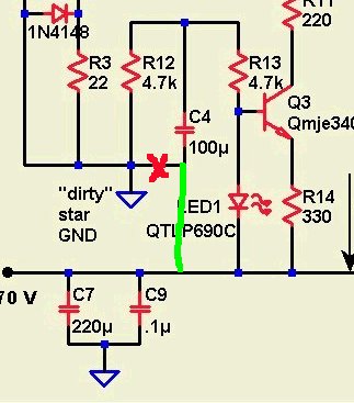

I just looked at both c4 /schema and c4 PCB and it is attached
to "sig grnd." on the other side ...r10 , NFB and the base of
Q2.. that seems right. C4 is the DC component of NFB .. so
to (clean) ground it must go...
Look at self's book or any similar topology..
these are working models , so I hope there are no errors.
If you meant C5 that is "aka doug self" ..proper. (CCS decouple)

By the way, nice amps you are building
I thought you were referring to FA1 (C4).. that was the
misunderstanding.
I try to make them easy ,with no questions or errors .
BTW ,FA1 has been running for almost a year. and
2 a month.
Many more amps to come.. all free.
