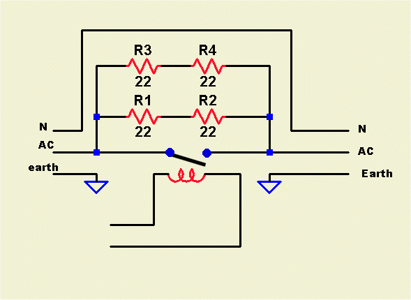

by andrew t. - try a set of 4off 5W 22r resistors in series parallel or 4off 5W 4r7 wired in series.
You mean this.. (attached)

yes that 4off 22r plus the DC resistance of the primary windings limits the peak start up current.
If you had 120Vac and primary=1r0, then the start up currents peaks at 120/[22+1]*1.414<=7.4Apk This lasts for a few fractional of a ms and falls rapidly to the working current in the transformer.
Set that relay delay to ~ 200ms to 300ms.

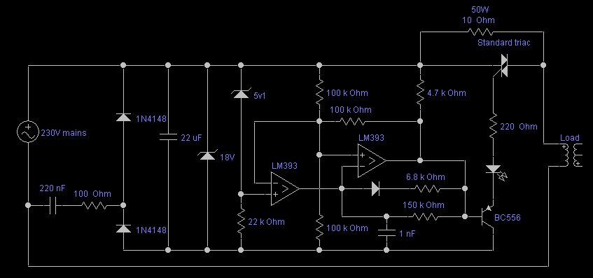

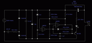

Below is the one I'm using. Thermistors have the advantage over resistors in that they can withstand the current through if the relay doesn't close - resistors will NOT.

Like jaycee said, the current draw is not constant and also the thermistor get pretty hot. The simple circuit I posted will short the thermistor after the inrush current. The delay is small but notable (I thought it would be less) before the relay closes.
Here's the one I'm using:
I have 2 small relays in parallel (redundant).

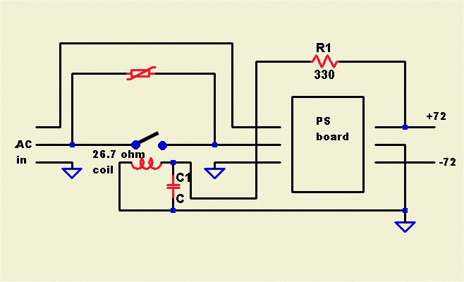

Still building.. slow, but perfect.
Yes, I like the circuit.. but it does not fall into the scheme of things.
I am going to trigger my softstart , DC detect , overcurrent from
the same 4017/ optoisolator circuit I have developed.
This will only require that the softstart is buffered by a darlington
to enable turnon delay.
For temp , I use this..
R3 is the relay, In real life, I need the big trannies because I
blew the "magic smoke" out of a 2sc2682 darlington. It was fine
for 5 minutes but the poor little device could not stand the load
(potter brumsfield 5V relay needs 200ma to fully activate), but the
mje runs cold indefinitely. (C1 is temp for delay- r2 will be the
input from the control board.

AOK .. ready for a psychoamp..
After 24 hours of "burn in" (large lamps on the 75volt supplies and 15 ohm resistors on the 12v supplies) , all runs smooth
and cool. The softstart relay (at 160ma / 4.9v) does not overheat
the mje15030/2sc1845 darlington and comes on exactly 2 seconds after the mains are engaged. 🙂
Board 1 (last post).
A power hog of a relay , but 30A @ 125v (overkill)
The readings are 7.2A.. inrush through the thermister .. 1 second
to +-75v on the main rails , main relay then engages.
Had some fun with the LM317/337. These are real good regulators if properly implemented.
With 10R load (1.2A), only .002v fluctuation (not bad)..
(Board 2 last post) With 6A bridge , 3A toroid secondary, short
circuit protection. The VSOP op-amp front end should be very
happy with this PS (overkill again)
I do not know everything
review the following schematic , please tell me of any errors.
(for safety's sake)
One bit of indecision is the hookup of both toriods secondaries to the common star ground , I have seen conflicting opinions
regarding this...? it all works ,no fire

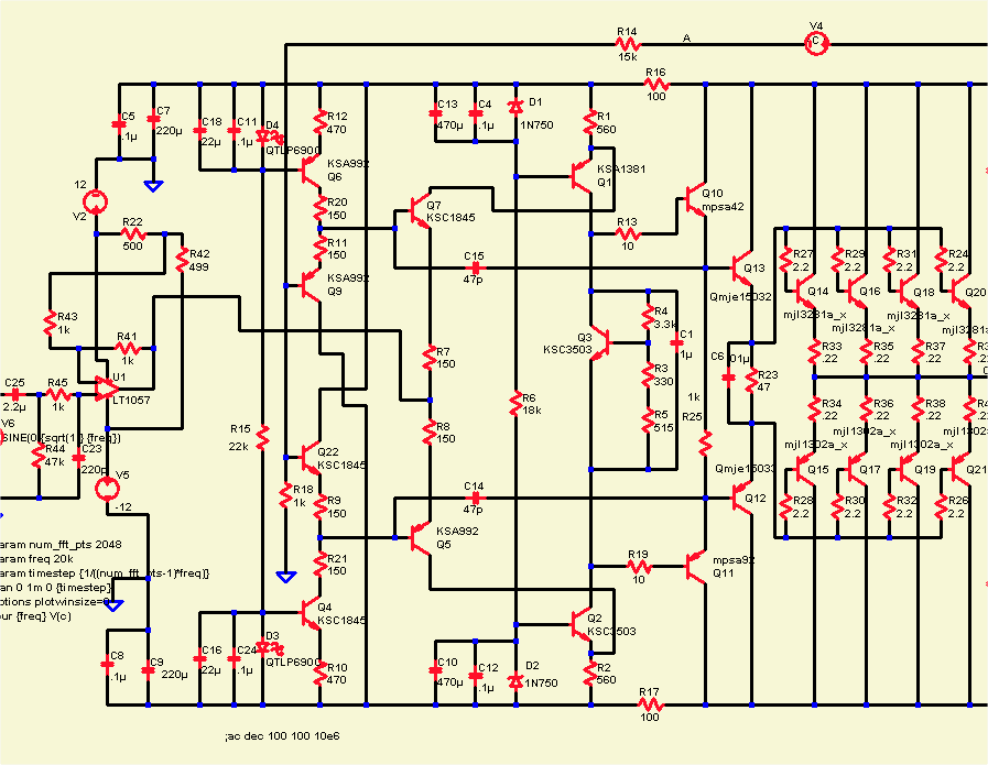

For the main amps , I think the VSOP is the way . I prototyped
it , forgot the miller caps and it still did not oscillate ..OMG
