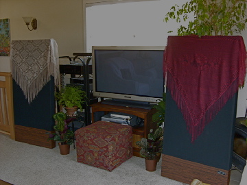

OS what are those speakers? Sony?
What's up with those damned montana indians?! When I was 23 I rode a honda 450 motorcycle from maine to alaska and back. I went through canada on the way to Ak. and mainly through the USA on the way home.
Riding through browning montana, I was also chased by indians... a whole pick up truck full of em. They eventually ran me off the road into a ditch.
OS what are those speakers? Sony? What's up with those damned montana indians?!
They are sharp's , Next , i'll unleash the genesis on them.
