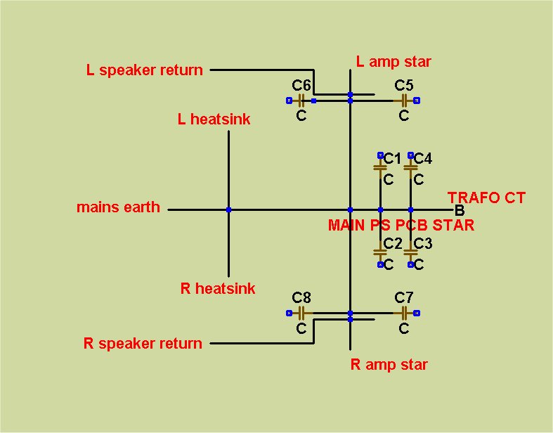

While everthing sounds better than my greatest expectation (OMG , the headroom) I am still chasing ground issue. A little Hum was there , I pulled my hair out :bawling: and found that taking the speaker return individually from the star of each amp reduced it a lot. Attached is general layout of grounding , If anyone could post pix's or diagrams (I did search , found some aussieamp pix of grounding and read self and rod elliots articles). I now have to put my head inside the speaker and strain to hear the hum , but I can still hear it...... 🙁 is this a unreasonable expectation.??

By Jkeny - Try a 100nF cap across the grounding resistor R7, some have reported this lowers the impedance to ground at high frequencies!
I will have to research this ... ahh, will just put it in and see !! Daniel gave me a LOT of audiophile bypass caps (big thanks) ,muse ,wima's, HQ poly's. I have already replaced any dubious ceramics or used devices in the amp.
My wife has suggested that I have become to much the perfectionist (fanatic),seeing me stick my head into the woofer. 😀
As far as that goes , I can not hear hum at 1 meter , not at 1/6th meter..... I have to put my ear right to the dustcap of the woofer and eliminate any environmental noises to percieve it. Is this in the ballpark of what I can expect ,or am I getting some EM picked up from my monster toroid?? My hearing is still good at 44 (can hear the earthworms "suck" back into their holes as I walk outside at night) so maybe I am chasing ghosts.
I also tested my ripple rejection by slamming one channel (300w+) while putting my ear to the speaker dustcap in another room (25ft. cable) ,while muting the test channel. This seems to confirm that I have very good PSRR, as I heard no sound out of the test channel AT ALL.
Objectively , I measured for both DC and AC at the OP , DC was 1.5 - 2 mV , AC was not measurable on the lowest scale - <.1 mV.
Edit: searched for 100nf signal ground cap - Chipamp people say use a ceramic disk ! 😀 the one place one can/should use one in an audio amp. 😱
OS

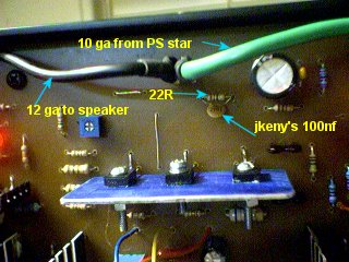

No changes to circuit , except the 100nF cap and the addition of quick connects to the 2 amp's star points(no more iddy biddy PCB terminals).
http://www.mouser.com/Search/ProductDetail.aspx?R=63067-1virtualkey57100000virtualkey571-63067-1
These are sooo tough , much current and VERY hard to break off.
10 and 12 gauge wire from speaker and the main star will be more desirable.
OS
HUM GONE !!
Stealing the grounding techniques of a few aussieamps I saw and Jkeny's 100nf cap combined for ABSOLUTE silence. I learned that the amps stars are the best place for returns when 2 amps are powered by the same supply , not at the common supply. :whazzat:
I am sure it helped to "supersize" everything (quick connects , 10/12 ga wiring). Without the physical grounding changes, the cap attenuated the harmonics of the hum (buzzzzz) , so I left it in to augment my physical changes.

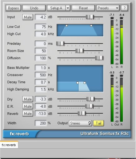

Yes that "sense of space" is completely fake
I have my own way to do that , BEFORE the amp. (attached)
