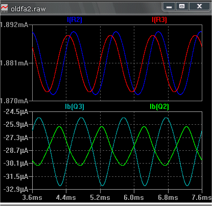

By rafael luc - Make in its first stage, 20Khz. Phase in R3 and R2.
Did that, (attached... first plot) phase is closer but still 10-15 deg., but take a look at Ib Q2 and 3 (second plot) .. totally out of phase. I never really looked at the phase relationship of this amp.
I do have a sim of the "original" symasym. It does the same thing.
I have also replaced the ground referenced cascode with a 15k resistor and noticed the LTP becomes unbalanced along with loss of detail at HF (in listening tests).
I have also tried 10 different compensation schemes that simulated with sufficient phase margin and open loop gain to
come up with what I have. I have also done these "real" to see what audible effects they resulted in.
OS
Noted that original symasym, has a peak at high frequency.
In his circuit should not have to 2-Cap Miller
I think with a cascode, one side is "faster" than other (just a theory). I have also the theory that VAS not working in differential mode.

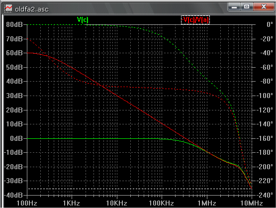

BTW.. here is OLG and bandpass plots (attached)

My circuit not ready...
I posted this to show the graphics
OLG way too high
OLG 30Khz -3dB(~80 fase margin), closed-loop 1.2Ghz :D
the two capacitors(C3 and C6) are the compensation.
no input circuitry
I still not did

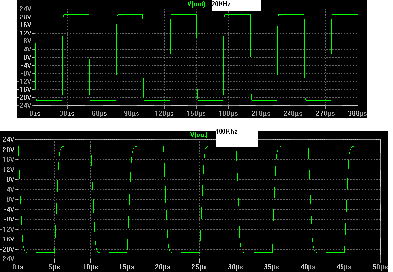

Stick a square wave into it
I'm working on it, did not sway with resistive load, but presented with capacitive load.
My output is triple darligton and I must optimize, not ready

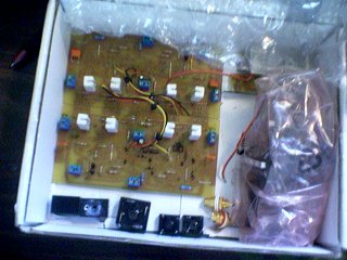

DAN , DAN .. you didn't have to send me that many parts.. :)
Anyways , thank you.
I am giving you the 2 supersym prototypes/+VAS HS's with a nice placement diagram / BOM and tips. Also, 4-3300uf @ 100v caps, 2-10A bridges , 1 - 35A bridge (you could go dual mono or single supply), 2 HS's for little bridges , and 2- GOLD RCA input jacks.
(attached) I would of gave more caps but the weight was too much.
You will have no problems at all , I could have these stuffed and running in an hour, but take your time. I am listening to the "big bro" now and it both takes the blameless's and the OEM's to the cleaners. These don't have the drawbacks of the "iddy bitty" symasyms , bass is strong , but the HF performance is still there with a hell of a lot more headroom. As I stated before, separation is on a dual mono level , I think you will really like these.
OS
