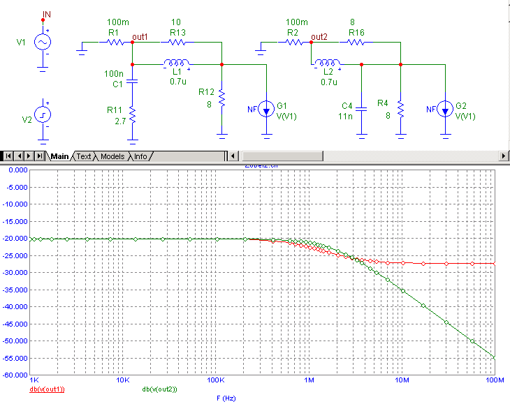

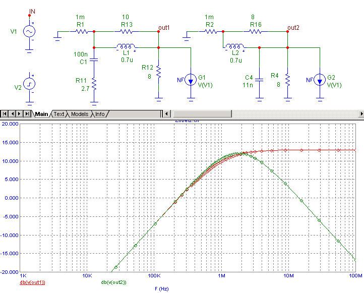

post 741 Zobel
Hi OS,
I believe you might need to think about your output Zobel network as in this thread🙁post118)
http://www.diyaudio.com/forums/showthread.php?s=&threadid=125679&perpage=25&pagenumber=5
Do you wish to try thermatrak in your new Frugal Amp?
Cheers
