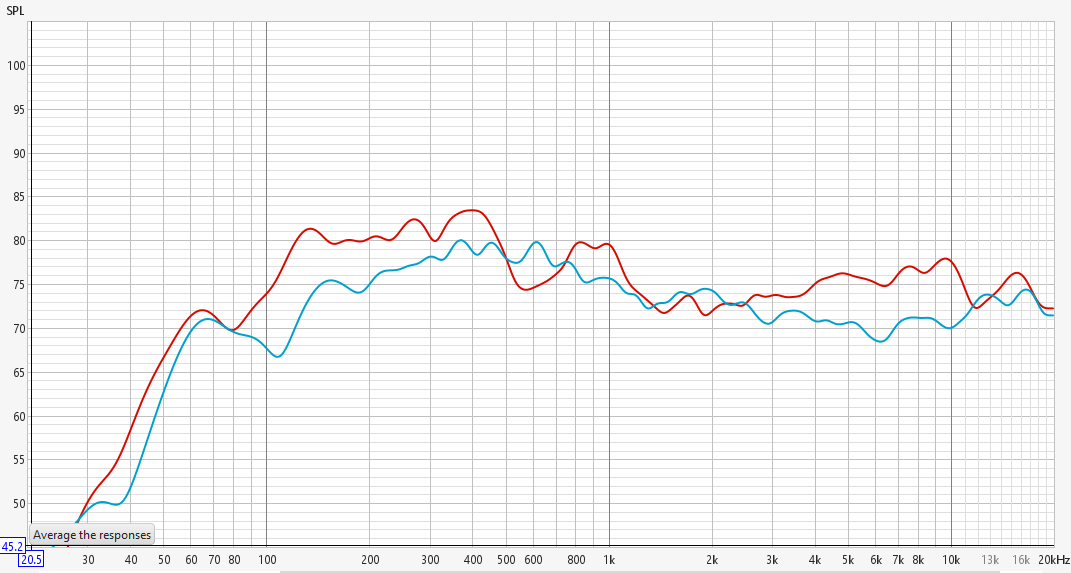

I have a DUAL CL172 with 1.5inci dome midrange. I have made some changes on filter.
New filter vs original:
I also have the measurements but the results are not relevant.

Red before modification and blue after modifications. The absolute SPL is not calibrated and the measurements are very influenced by the room.

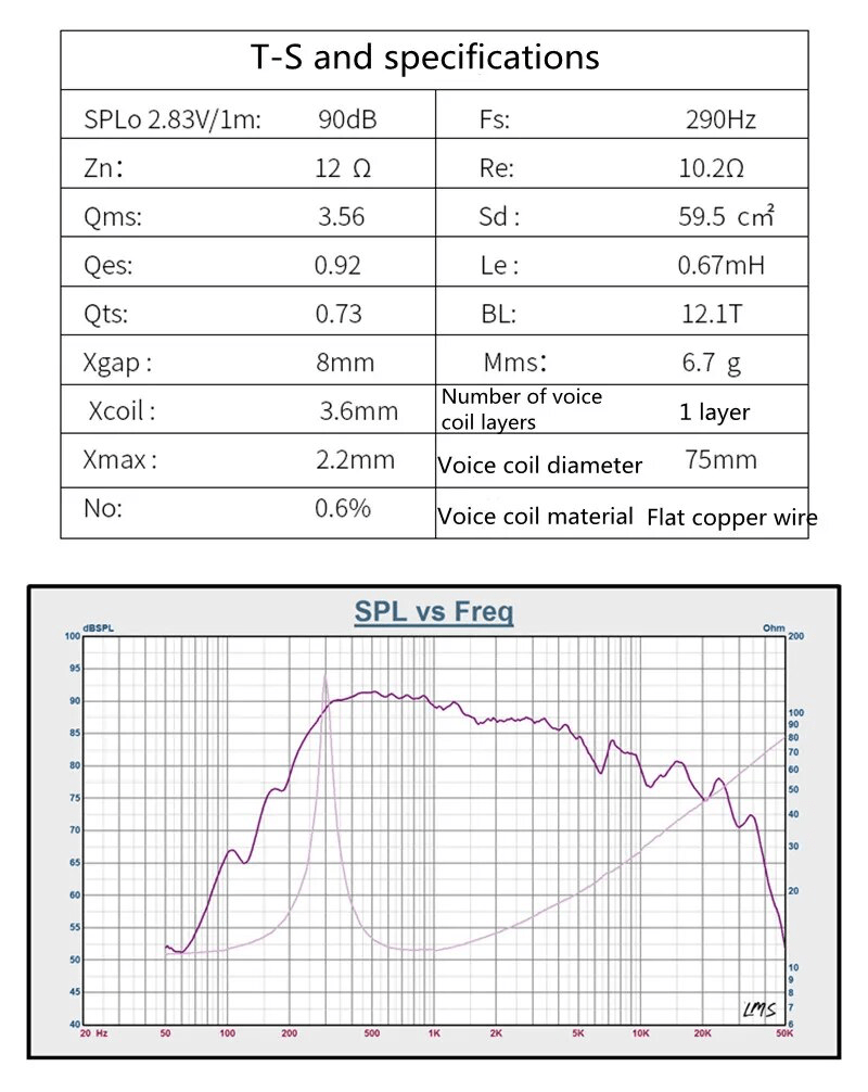

Datasheet says Qts is 0.9, so not much to gain.
Looks like an ATC replica, but the efficiency is too low to be worth the price over the scanspeak unit, unless lower Fs is important:
In the UK, by the time I have paid postage and then added import duties and VAT a proper Volt VM752 is about £25 more expensive. Won’t be me testing it for sure.
