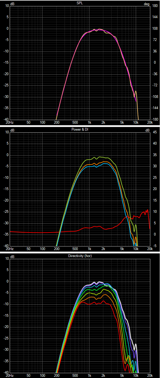

well da beast Fs 280hz 5,3kg Sd 57.8 ! size 200mm

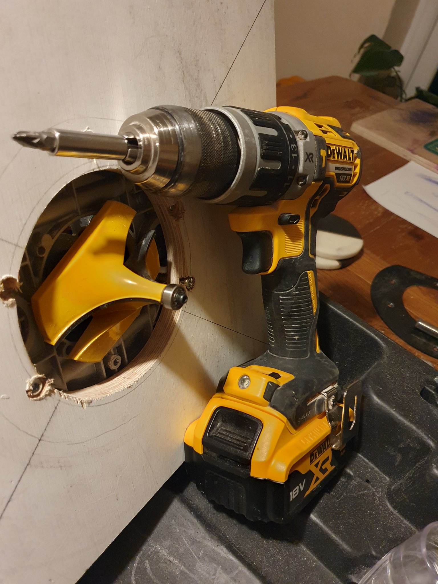

has anyone tried horn loading their mid dome in a similar fashion to the atc or volt ones ? I'm about to try using a 1.5inch roundover bit on the router to see what happens . Still not happy with my circle cutting and am struggling to find a circle jig that will cut small enough circles for the tweeters as well as mid domes . drill for scale !

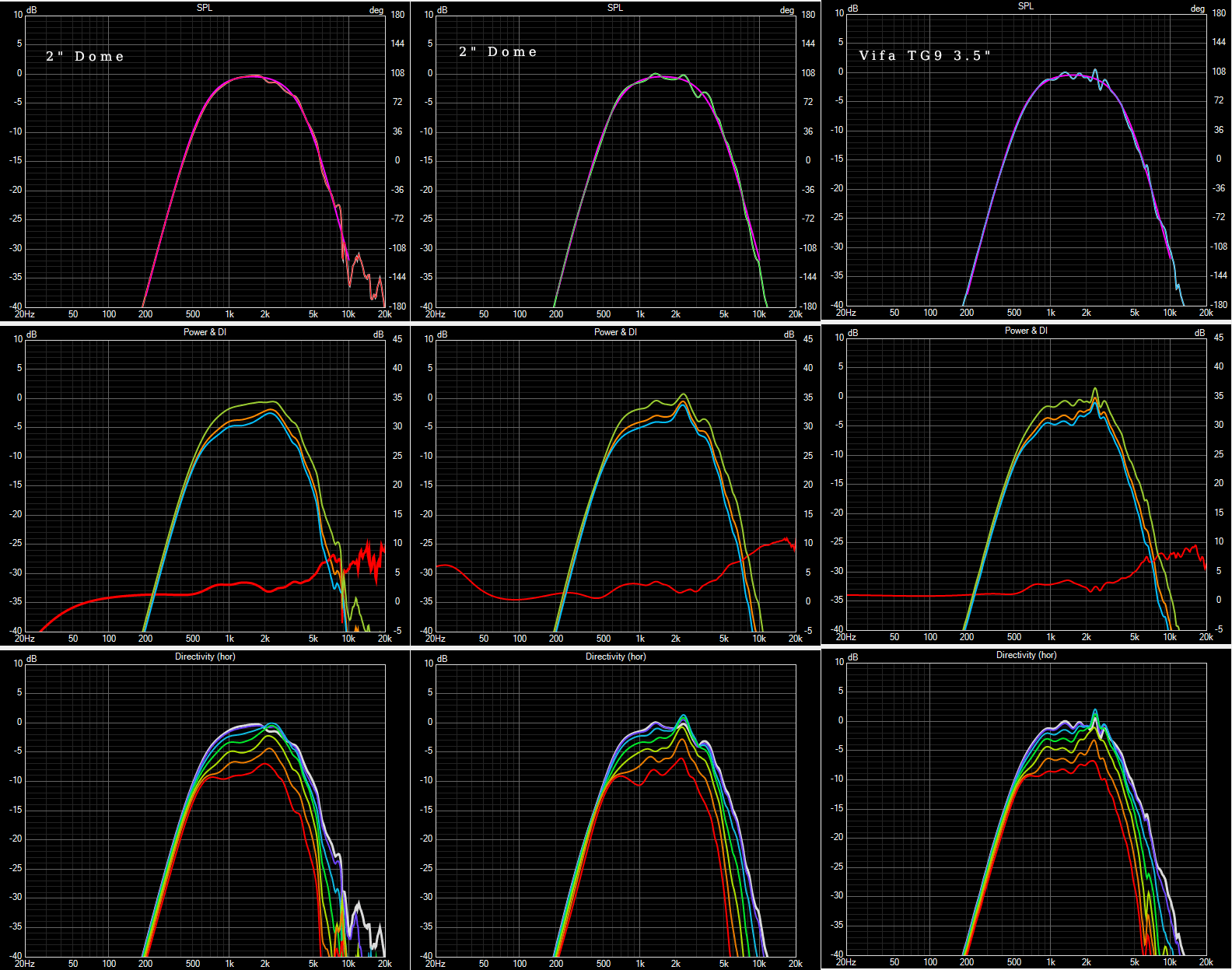

A dome has lower directivity/wider dispersion than a cone.
The dispersion of a 3” dome is similar to 2” cones.
Disagree, the dispersion of a 2" dome is similar to a 3" cone. Of the handful of drivers I tested in the same cabinet, same location, two were 2" domes, The peerless above as well as Morel EM1308. Both these domes match the dispersion pattern of a TG9 when equalized for the same response. Wavecor WF120 is every slightly more directional at 4" size, but not really enough to care about.

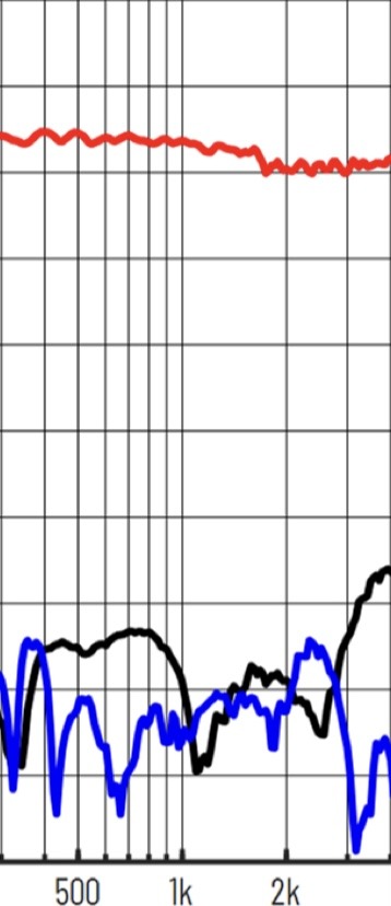

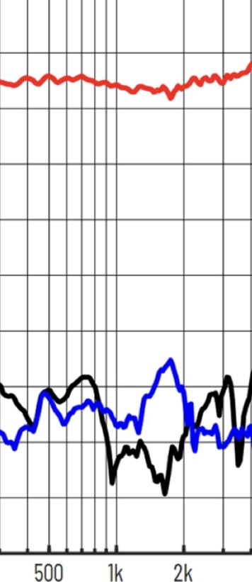

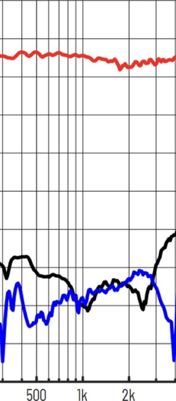

Purifi PTT4.0 drivers; 4” drivers, actual cone diameter 3.33”. Outer frame diameter 5”.
Purifi PTT4.0M aluminium 4” midwoofer with small 2.9mm x-max and 86dB sensitivity
Vs
Purifi PTT4.0M paper/fibre 4” driver with same 2.9mm x-max and 87dB sensitivity
Vs
Purifi PTT4.0X aluminium 4” woofer with large 8.8mm x-max and 84dB sensitivity
Here are measured at @94dB SPL; images cropped to focus on “midrange” frequencies between 300Hz and 4KHz:
Fundamental red, H2 black H3 blue. Each large square represents 10dB.

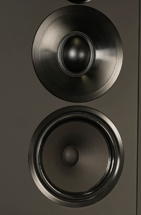

Folks have tried and there‘s been both success and failures…..the horn loading provided by the waveguide will add compression to the dome itself so the dome material and suspension have to be able to take it….if not, the results are typically rocking modes and other response anomolies……a fair tradeoff for some who need the deeper extension and lower distortion the waveguide provides acoustically.
