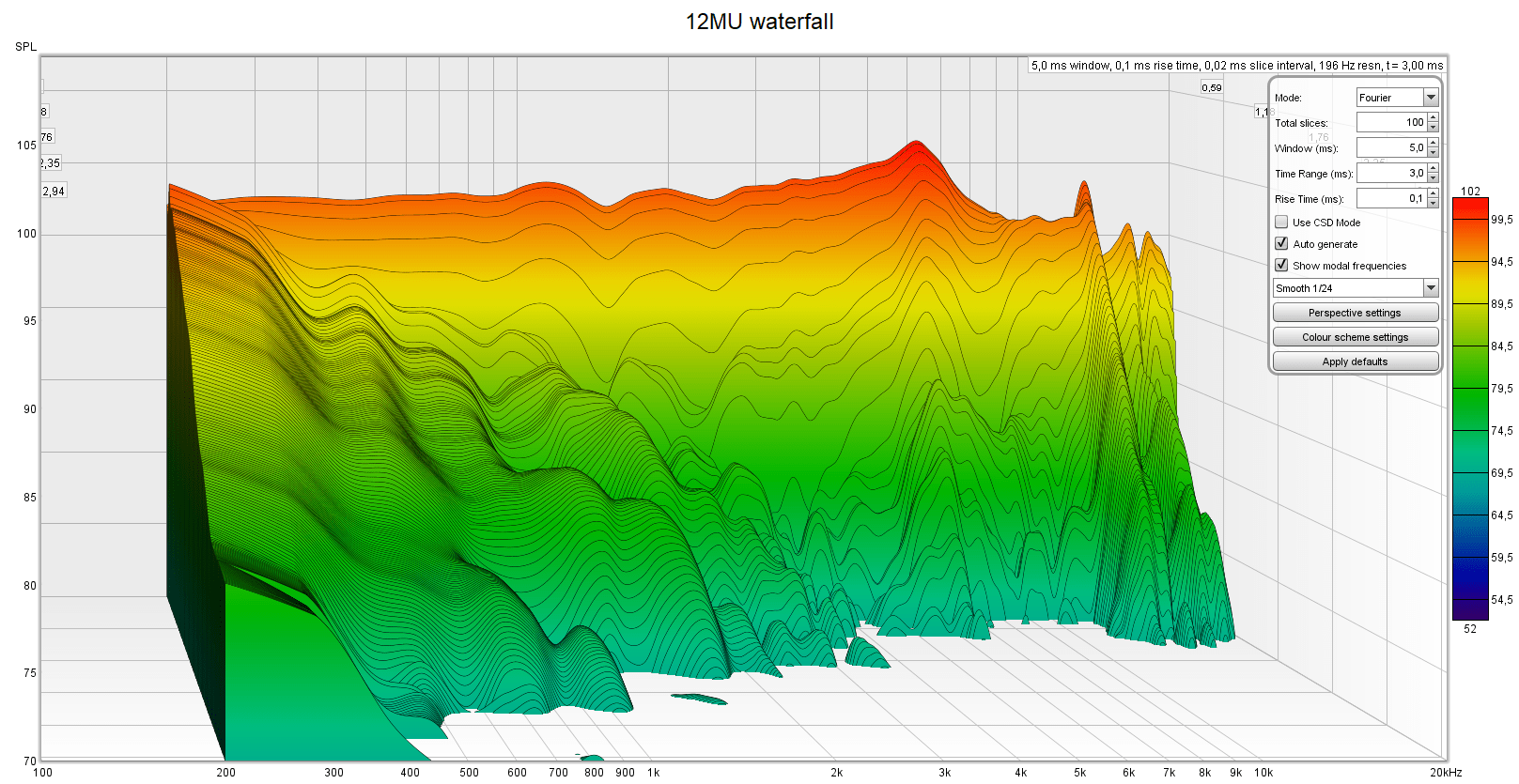

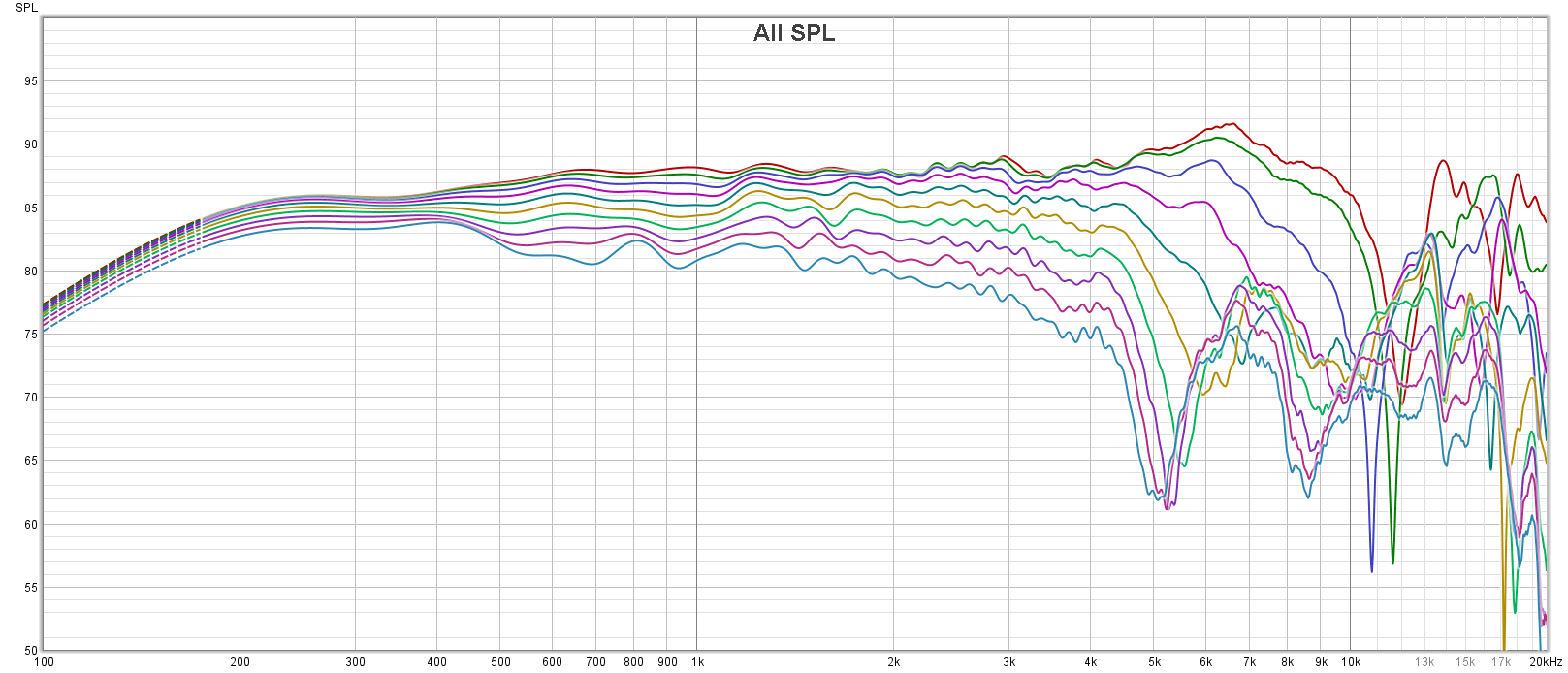

OK thanks that looks really nice to my eye would you say there were 2 break up modes at 6 and 15k ? these should be well out of intended range
. is that correct ?
. is that correct ?

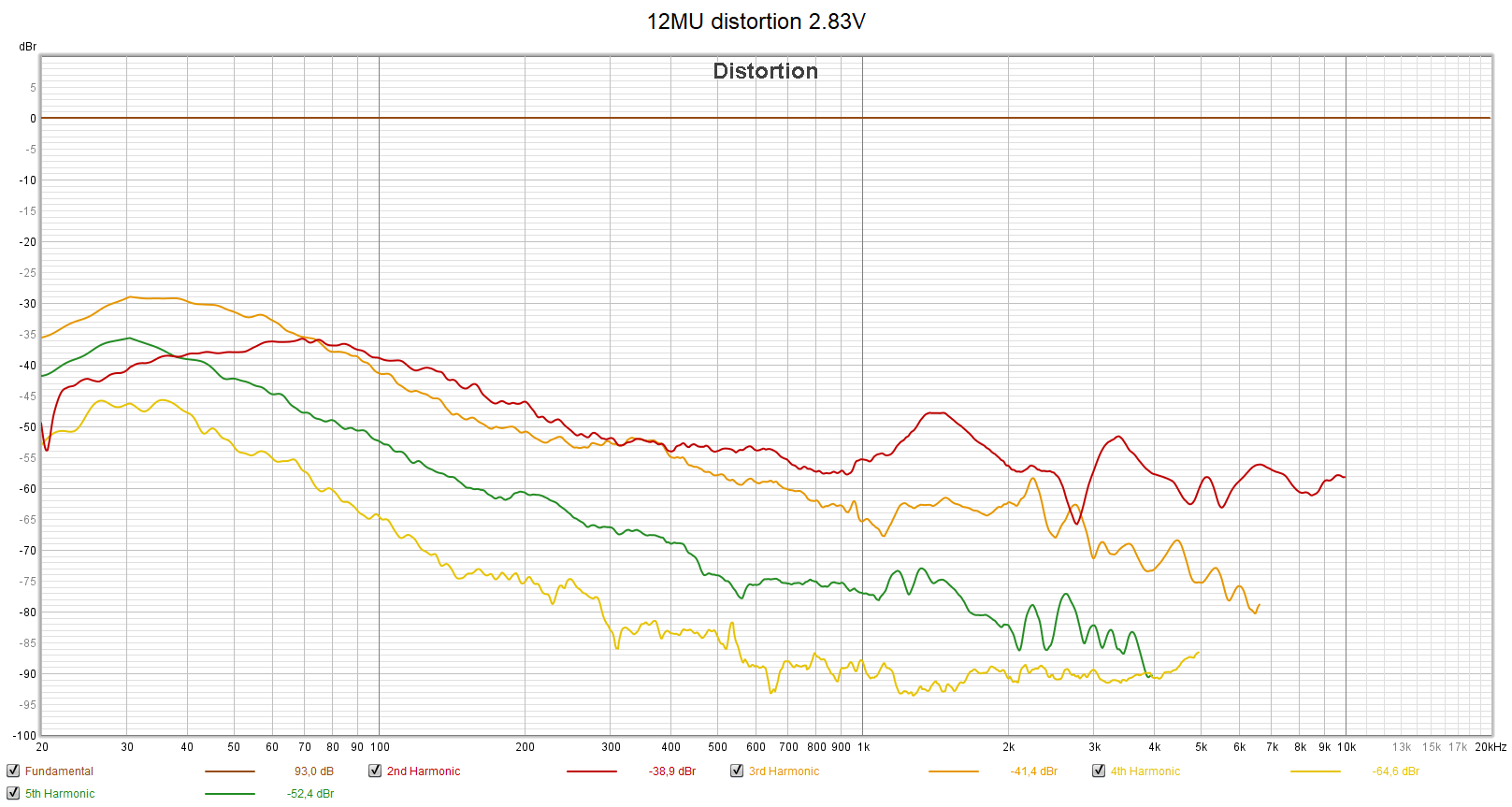

That's THD comparison but I would be curious to see IMD comparison. One of the contributing of IMD is current and in the midrange frequencies the M would use less current (@ given spl) so one would expect the M to have lower midrange IMD.I’m with @PKAudio
As for whether higher sensitivity matters or not?
Well given the same SPL; it’s not clear that the higher sensitivity driver necessarily has the better performance. At least for well designed drivers.

On other advantage for the M is the maximum SPL. If I had to chose between these drivers knowing that xmax is not required in the targeted fréquence, I would go for the M paper because of SPLmax and maybe better IMD but sonically there are probably all equally excellent.

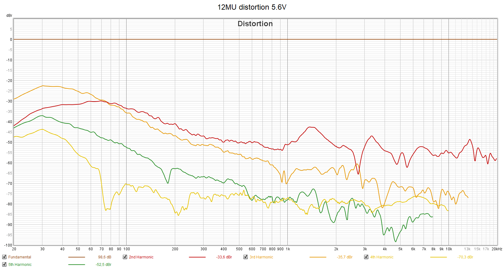

OK brilliant can I see your design quickly6k is just mild well behaved breakup, easy to linearize. I used it LR2 4kHz. The distortion this time for 5.6V.
