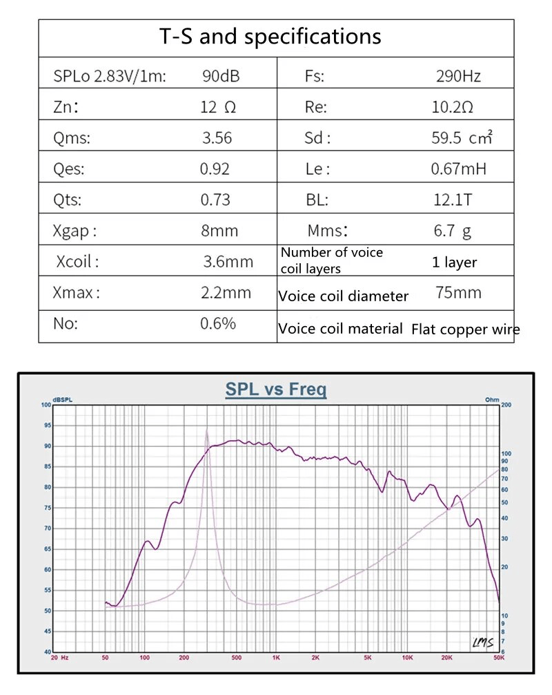

You can see how the high VC inductance rolls off the upper end prematurely. Worthless driver IMO, just like other Chinese knock off products.Looks like an ATC replica, but the efficiency is too low to be worth the price over the scanspeak unit, unless lower Fs is important:

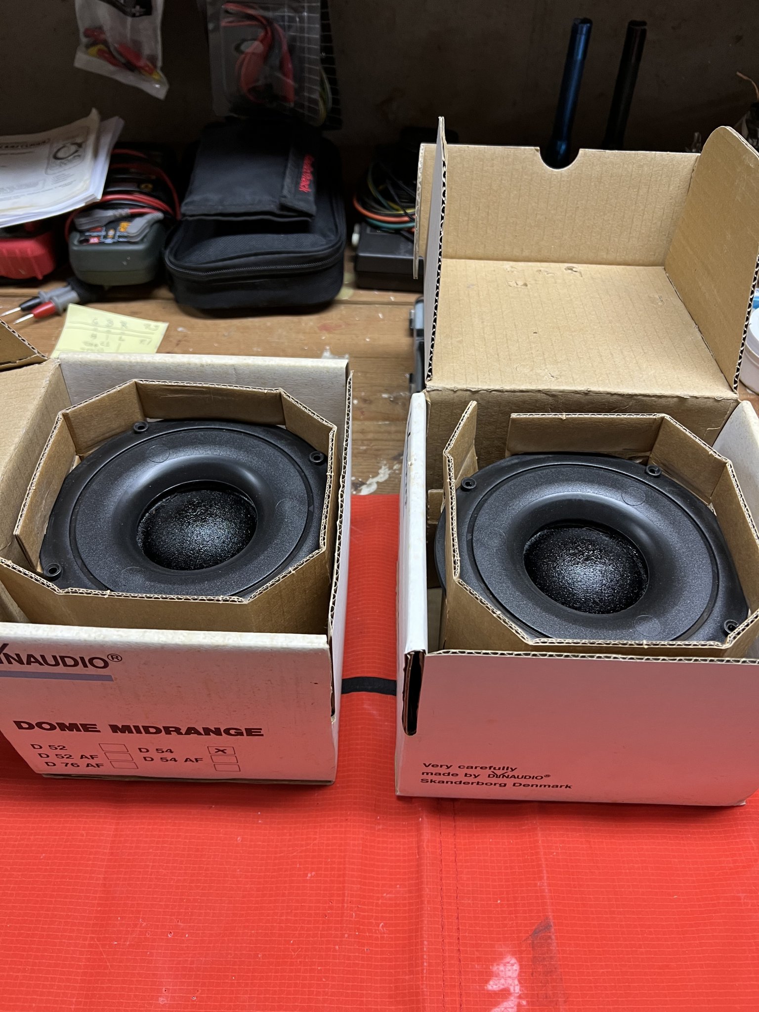

Well I've got a couple mc2 amps I'm pretty sure that's what they use . got a software based crossover . it's just if it's worth paying out for a volt middome .I'd love a compact powerfull 3way with middome bought a dynaudio d76 hoping it would be as good as the atc /volt haven't got round to finishing my test box yet
D76 is a very good mid dome, but they age horribly based on the ones I've owned. Dynaudio dome mids utilize a very tight VC gap, which implies that any minute amount of VC sag over time will likely cause the VC to rub or buzz. You'll see this as high odd order HD in the lower mids, especially around the dome's Fs. I had 2 of my 5 brand new D52AF do this to me right out of the box.
nightmare.! so I run a sweep and look for high odd order distortion lower down ? the only thing that might help me is there new old stock so they're been stored dome up . I'll email dynaudio and see if they can do anything to help if they are sagged .

@jccart Just run a 200 - 400hz sine wave @ ~ 2V and listen for distortion. It should sound clean and pure without any overtones or buzzing (sort of like a square wave).
If you do here anything bad, apply very light pressure on the surround all the way around the dome circumference. If one location makes the buzzing go away or become alot less, you have a shifted and/or tilted VC. There are a few things you can try to get rid of the problem, but many times you're facing a repair, needing to send it to Dynaudio for VC replacement.
They probably can still repair these old domes if the motor is in good shape. I had them repair my two bad D52AFs, but it wasn't cheap.

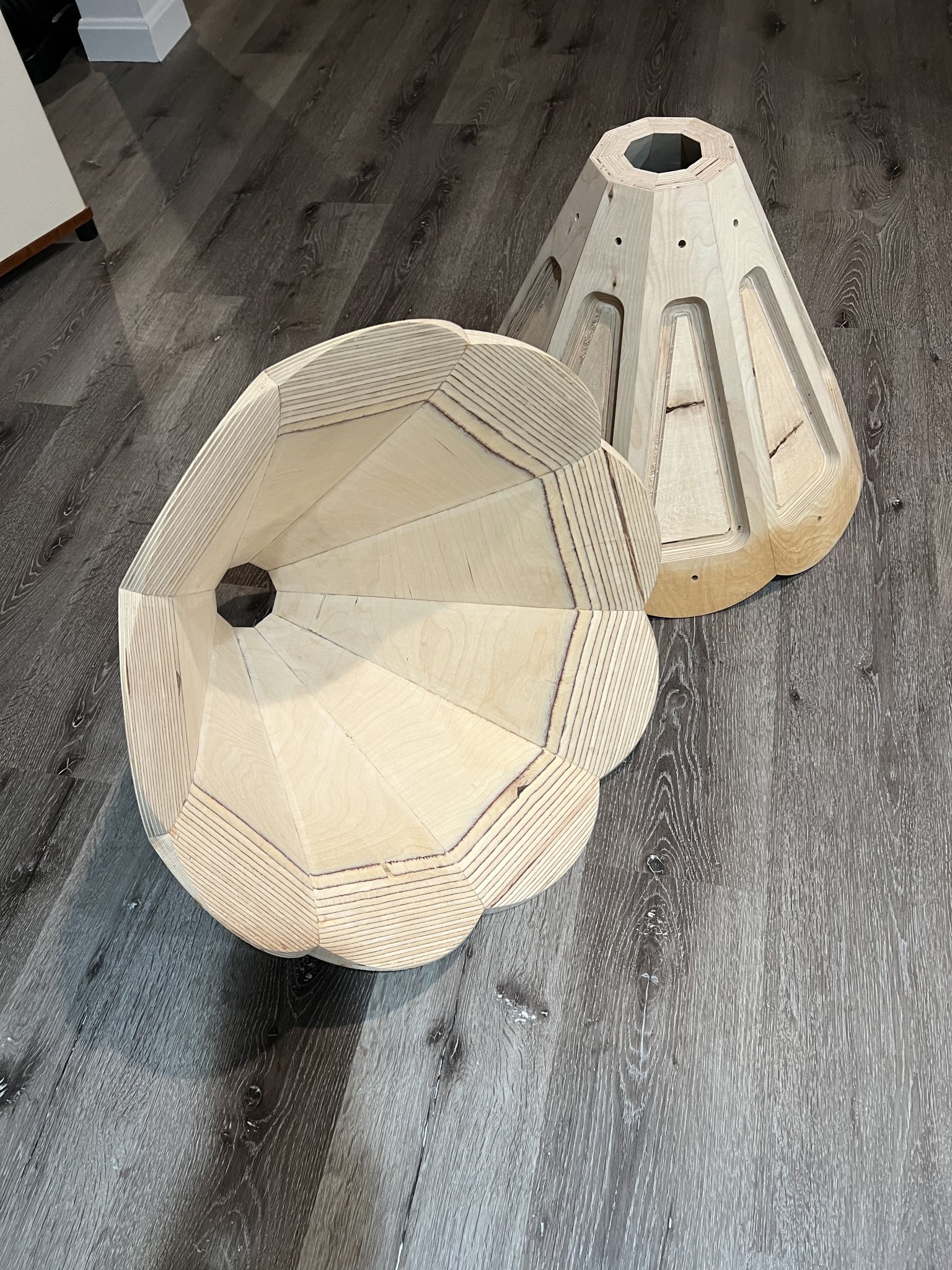

I have some conical petal
horns that were a gift as well. They have 3” throats, about 16.5” long and 22” mouths. I’m wondering if there is a good 3” dome I could try with them?
Otherwise I’ll have to find or machine an adapter for a 1” or2” CD.
