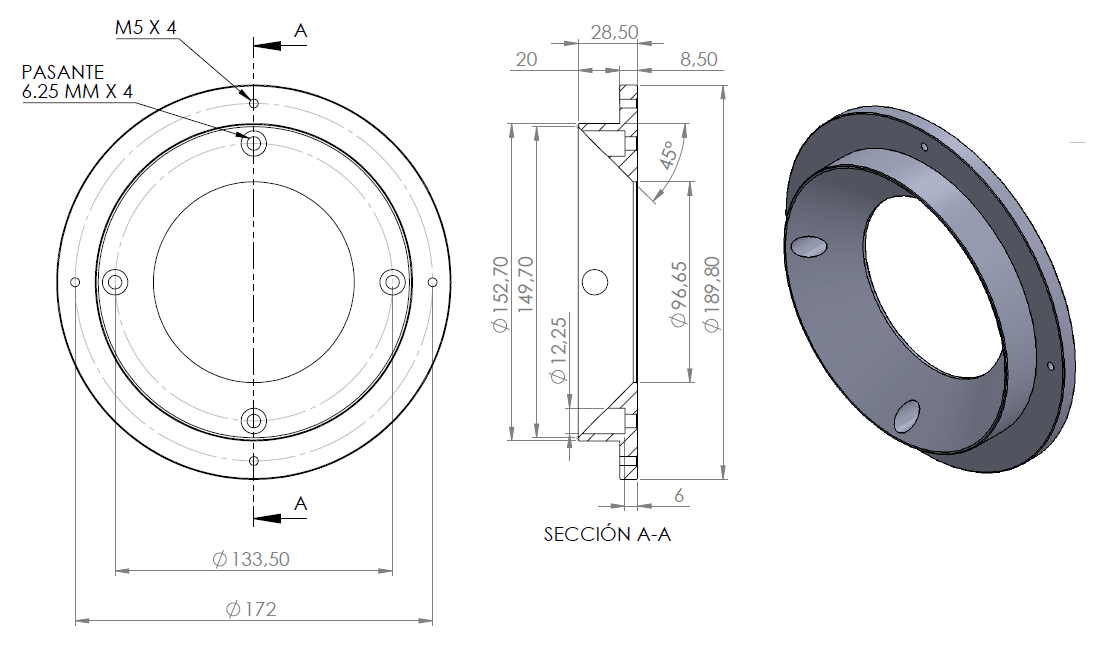

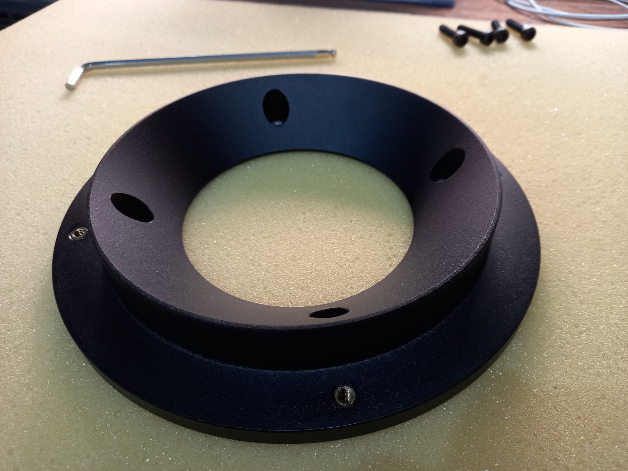

The Volt already comes with a truncated horn/wavguide…whatever that’s worth…I would hope its removable?
Yes, the waveguide of the Volt 752 is removable. You can make your own but, the mounting flange and the WG are both in the same block.
