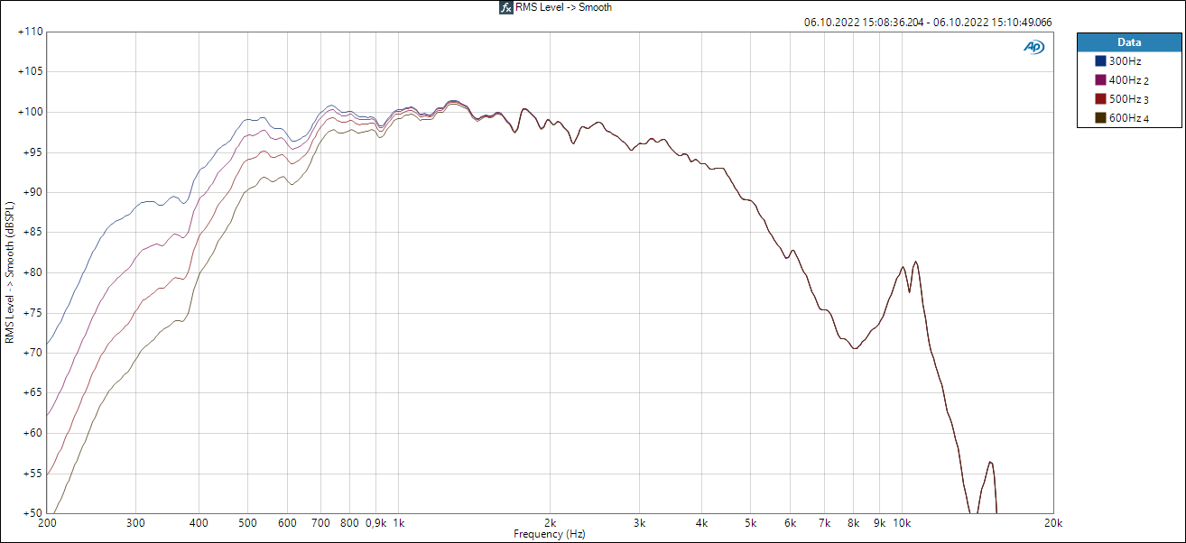

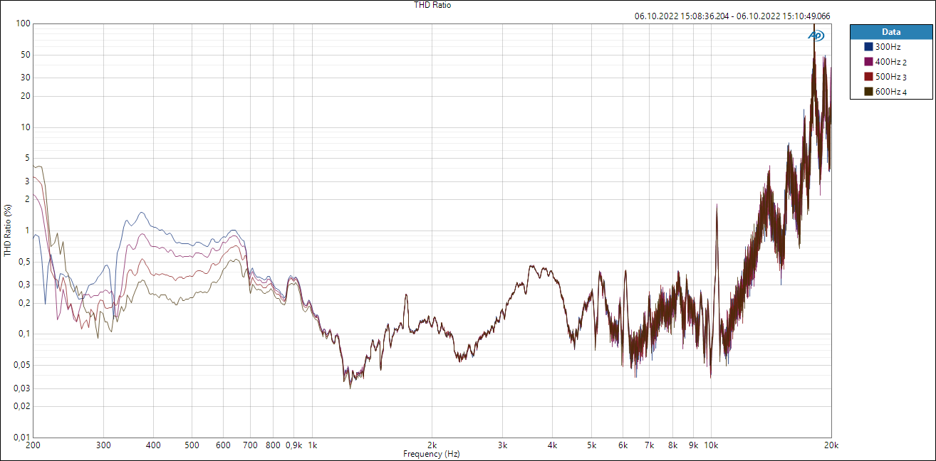

The owner of the system I heard mentioned BluesMa was planning a M142B but issue in the B supply chain lead to canceling that plan. It would be a lot more expensive too - much more than the M142T! What I heard was the M142P. The owner is moving into M142T, which is the same one I'm thinking through.
I asked Bliesma and they aren't planning an intermediate sized dome between M74 and M142. So it's down to required xo and SPL needs. HiFiCompass shows 500Hz is lowest xo suitable for M74, and preferably 600Hz. M142 down to 250Hz.
My midbass is a SLOB with 8x 6.5" per side like xrk971' XSD but with different drivers. It goes naturally to 470Hz where it drops. I could push them to 550Hz, maybe 600Hz, but I need to test how they would sound. The M142 starting at 250Hz sounded very good but I don't really need to xo that low. But M74 needs a xo that might be too high for me.
FWIW, xrk971 SLOB work amazingly well. You could look into a similar setup with smaller drivers and achieve 550Hz xo. I just happen to have built with 6.5" already. Even with 6.5" it does get easily to 470Hz and probably to 500Hz too.
