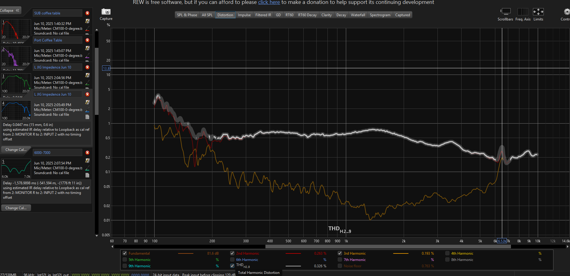

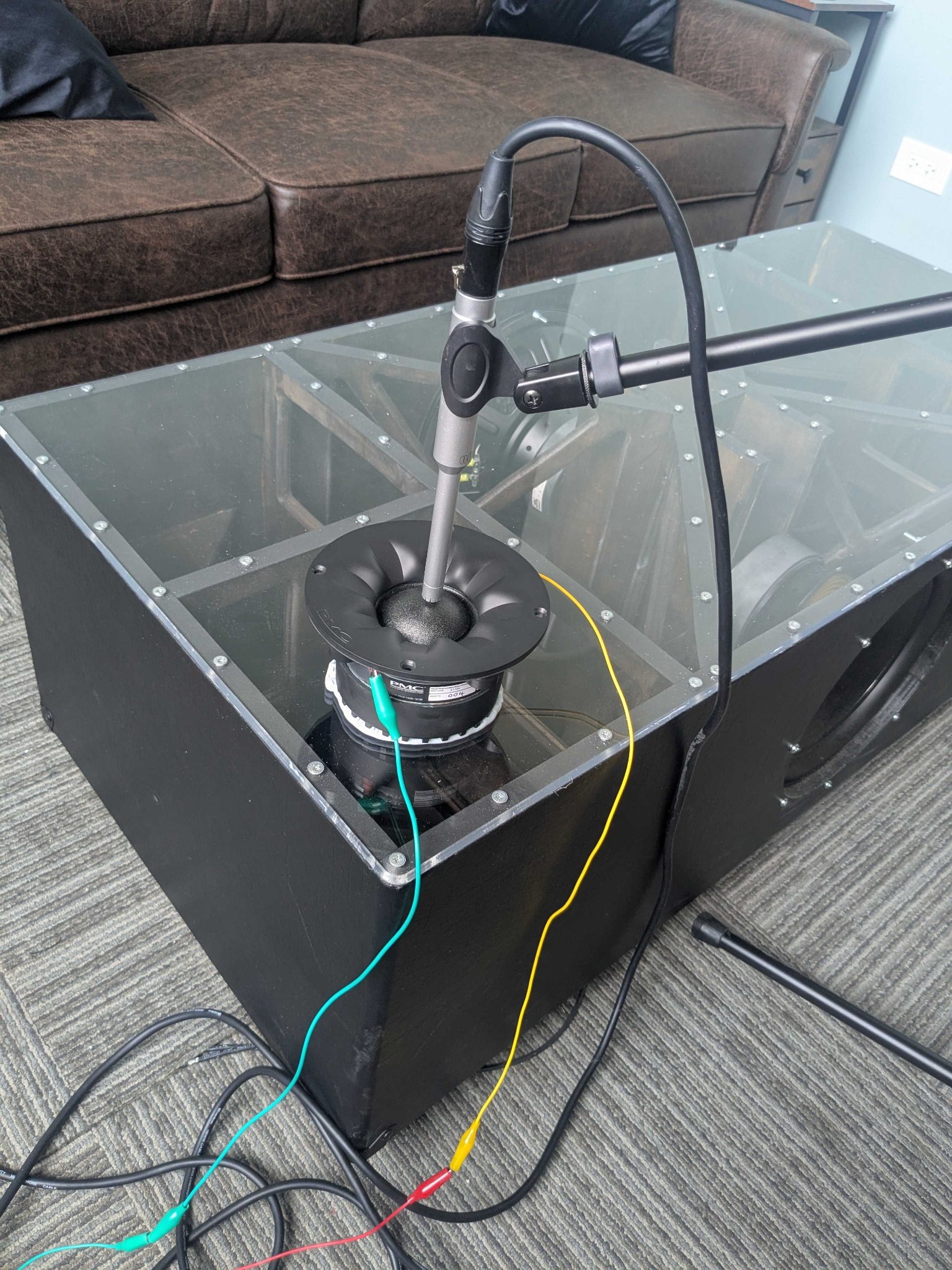

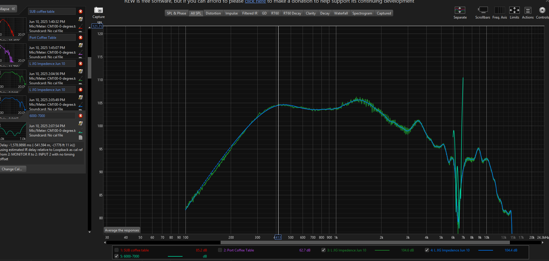

Finally got around to measuring the 55mm PMC dome.
I ran the sweet from 100hz-20khz near field. Picture of the setup is attached. Nearfield measurement
That dip from 850 to 1200 might be a little annoying.
No matter what I did there is a dead spot at 6500hz. Straight up dead. Almost like they built a notch filter into the unit somewhere in there. Kind of crazy. I even took a measurement from 6000-7000 just to be sure. Yup, dead spot. Strange
This response is not really what I expected. Now onto the REALLY crazy part. What you've all been waiting for....... the distortion.
You can interpret this graph however you want but I'm seeing no reason why you could use this from 250hz right on up to 5khz. This is a straight up mid range. Not an upper mid range. A full range mid range in a 55mm dome format.
Check out the distortion between 1k and 2k. Crazy low. I think this is why I like the sound of it so much. To me, that 1000-2500hz range is the most annoying place to have distortion. A lot of speakers I don't like because they cross cones right above that range. They let the cone mid play that while the cone of the mid is already starting to break up. This just sounds bad to my ears.
Are they worth the $380 I paid for the matched pair? To me, 100%.
Your mic is beyond "near field", it is within the horn/waveguide.
Interior boundary reflections from the horn walls could account for the cancellation null ~6500.
At any rate, if you want a representation of the mid dome waveguide's response, it should be measured in the far field, as the last two posts suggest.
If the driver's SPL level was 105dB at ~5mm, SPL at 1 meter would only be ~57dB.
Distortion of a fraction of 1% at such a low SPL could be expected from almost any driver.
Looking forward to seeing some far field measurements.
Yup, I definitely did mess that up lol. I should have remembered this after I did all that waveguide research on the planar mid this winter. This is what I get for trying to take a measurement quickly between meetings.
Eventually I will get it flush mounted in a board and try to take axial measurements. My summers are pretty busy so it might have to wait a little while
... Make a quick baffle from cardboard - better as noting. Tape the edge of the driver to make a smooth transition. And put everything on the floor. Good enough for a quick check.
Or just save the cardboard and tape ...
...put the driver on a pillow on the floor and measure 1m directly above it, you will get a reasonable infinite baffle measurement.
