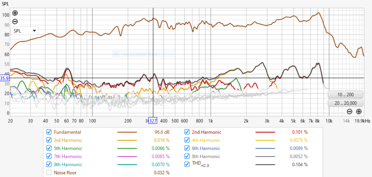

Actually, it sounds good enough to run it way higher -- 3 khz -- if you're not obsessing about directivity. My 4 ohm samples are quite linear; between 800 and 3.2 kHz, it's probably +,-2 dB.
Here's an on axis sweep in REW (with no smoothing other than what REW automatically applies) --
Note, the above curve with the driver on a 15.5" wide open baffle, Hence the early roll-off below ~250Hz.
