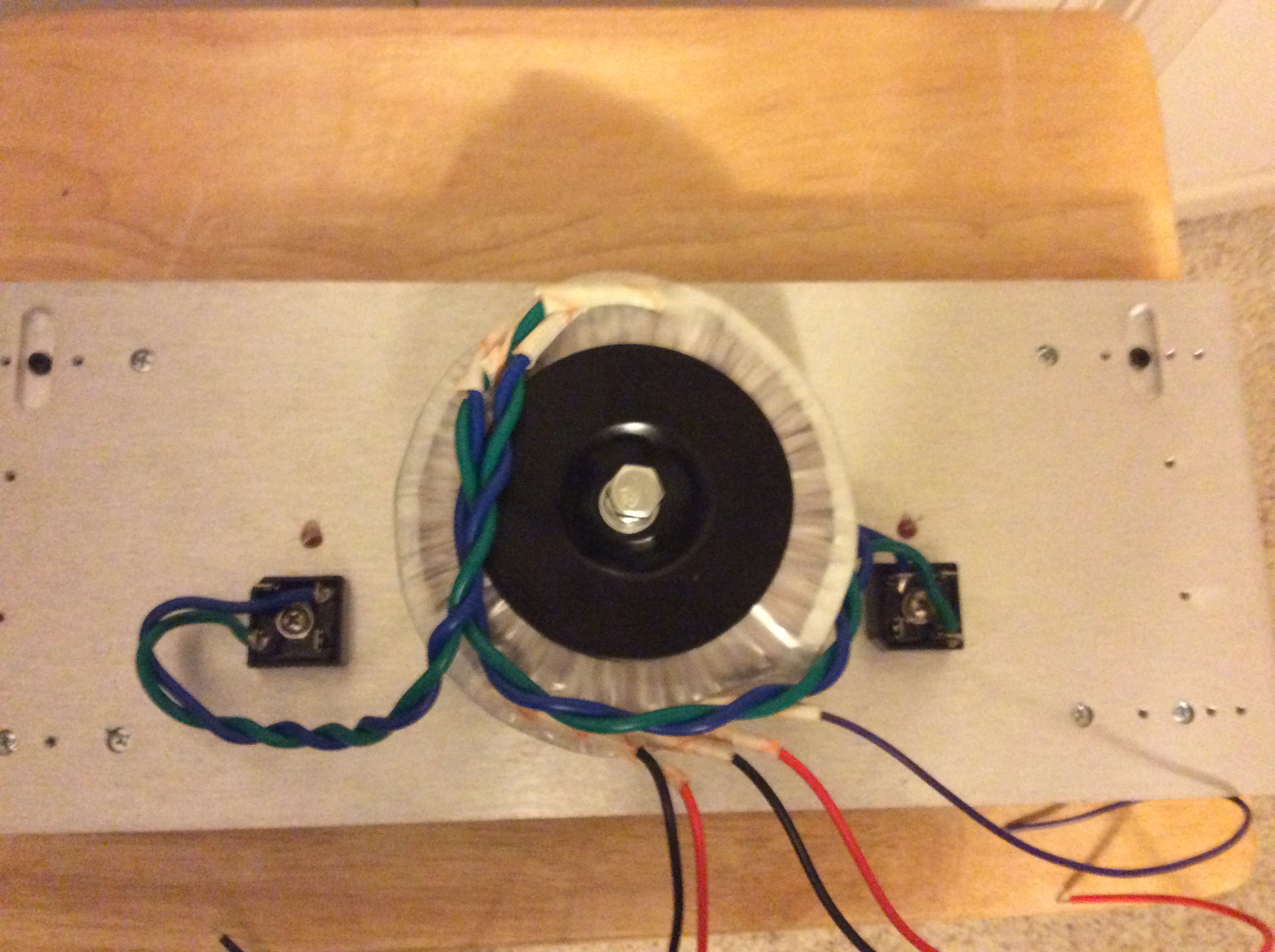

Regarding the power transformer, I believe our builders will save some time and effort by choosing one with built-in electrostatic shielding and a magnetic shield band, such as the Antek AS-4218. It is also important to include the 400VA steel case for this toroid. I used a 400mm deep chasis which allowed the transformer to be bolted to the base plate near the front of the amp, and had plenty of room for the diyAudio universal PSU board. I have had no issues with hum.
I believe 6L6 used the Modushop deluxe 4U chassis, which is 300mm deep. In this case I would recommend bolting the transformer to the inside of the 10mm thick front plate. This allows greater physical separation from the Edcor signal transformers, and appears to be a favorable orientation to reduce magnetic interaction.
Start of my build using a 300mm chassis
Drilled and tapped front plate to bolt the toroidal without drilling thru entire plate.
Remotely mounted Leds for + - supply and tapered the front side (pics later)
Bridge rectifiers sinked to faceplate as well

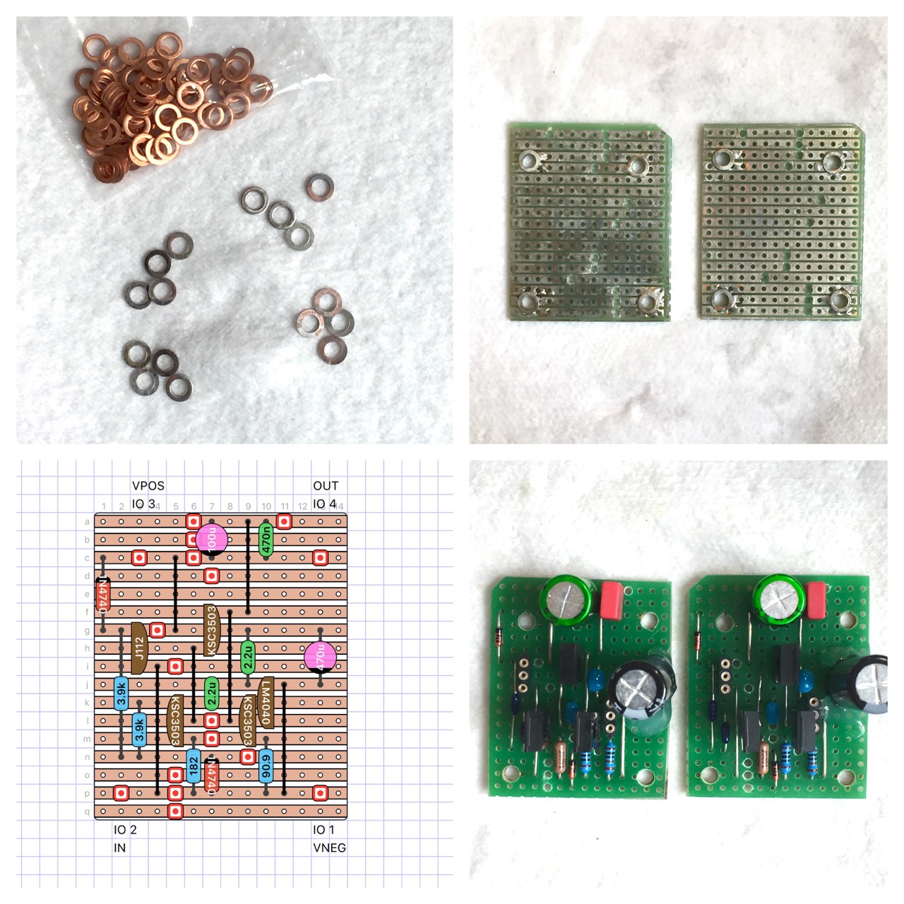

I finally received the parts that I needed to try a more robust mounting / connection scheme for my M2x IPS veroboard prototypes. The first board set that I tested was a version of the Mtn View that I've been itching to try for a while. The main goal of this update was to test an alternate voltage source to replace the infamous "do not substitute" red LED. Along with the new voltage reference, a few other component substitutions were made to ensure best performance and stable operation. I am happy to say that the sound of the new boards meets or exceeds what I had hoped to accomplish. The updated Mtn View conveys a sense of ease and flow to the music which invites extended listening sessions. While the boards took a few hours to settle in, once they did, they were a delight to listen to. Though I miss the cheery glow of the red LEDs, the sound of these boards more than makes up for their absence. I think that garyalex and I may be hearing very similar things with Mtn View vs Tuscon.
The new voltage reference is an LM4040C20 (2.048V, 0.5%). This is a part that is commonly used for precision analog to digital converters, and should be easy to source. The new voltage requires that R3 and R4 be changed to 182 Ohns and 90.9 Ohms respectively to get the desired bias currents. D1 and D2 were changed to higher precision Zener diodes, and I reduced the values of R1 and R2 to 3.9 kΩ to increase the available bias currents for the zeners and voltage reference. J1 remains a standard J112 and Q1 – Q3 remain as in the original. By running the zeners more in their "sweet spot" for current, I hope to ultimately create more stable current references for J1 and Q2.
The good news is that these part substitutions may all be performed with the original Mountain View PCBs. Please note that the LM4040 operates as a zener diode, and has its anode and cathode reversed from the LED. You may think of this as the TungstenAudio treatment for the Mtn View IPS – optional, but fun to try.
My own prototypes proved to be a lot of work to build, especially with the use of copper washers to reinforce the mounting holes, but have given me a means to try out many other ideas without having to do custom PCB layout and fabrication.

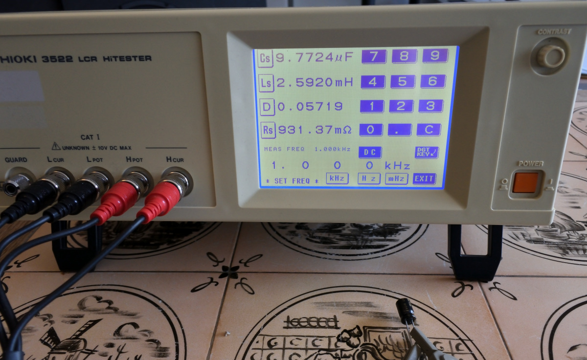

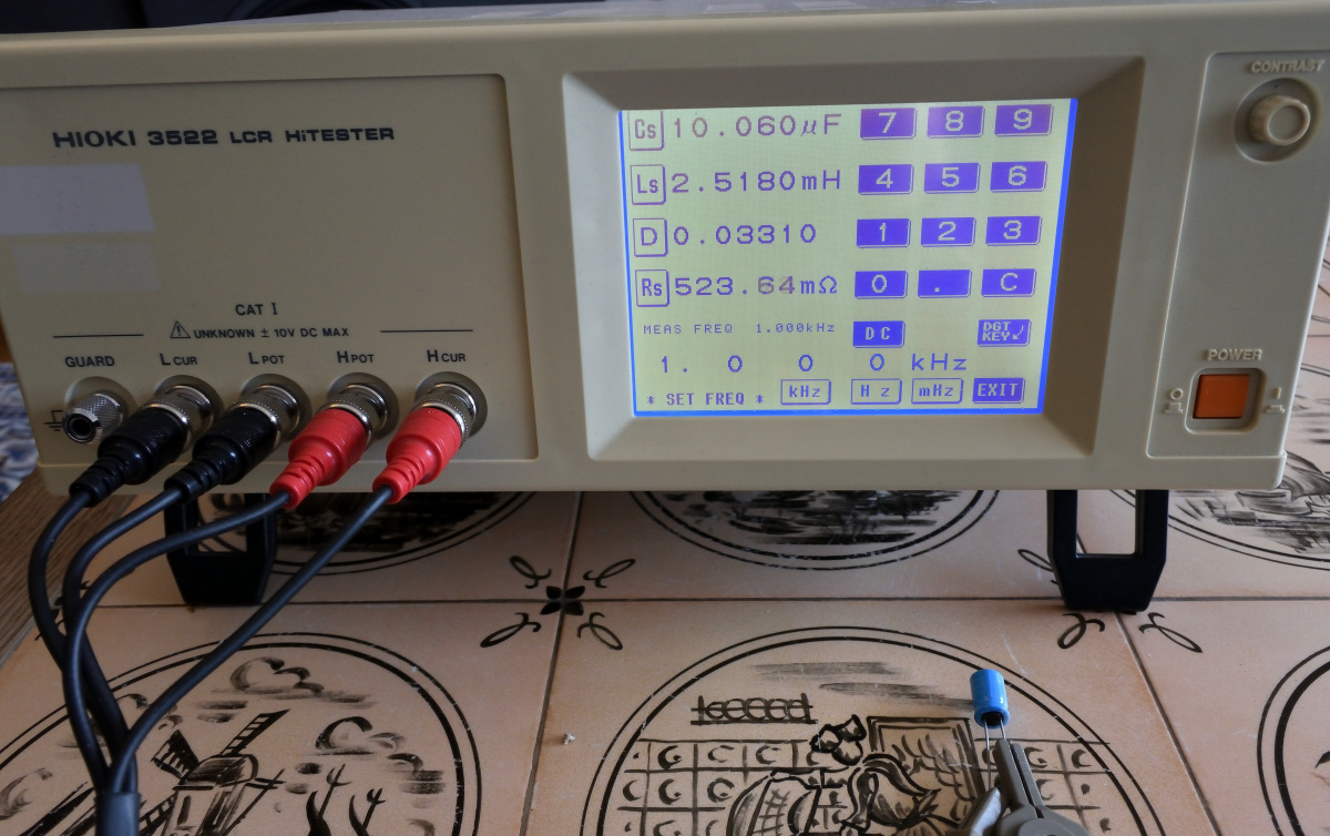

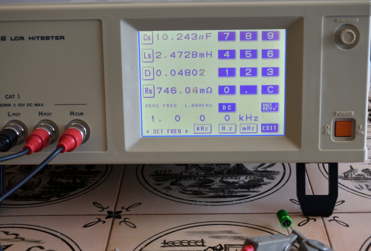

About the M2X 10uF signal coupling cap:
I made a measurement on 3 different Nichicon 10 uF capacitors:
ES (Green Muse) 10u/50V
KZ Muse 10u/100V
BT (industrial 125 C type) 10u/50V (blue color in picture)
I was surprised that the industrial BT seems to have much better specs than than the others (especially when compared to the KZ which should be the top audio cap series from Nichicon). The "picture" is the same also at 100 Hz and 100 kHz.
So......what do we pay for when selecting a "Muse type"?
For the "Korg" I used the BT's.....with very good results (at least to my ears).
I wrote to Nichicon (Japan) to get their view.....but never got a response :)
