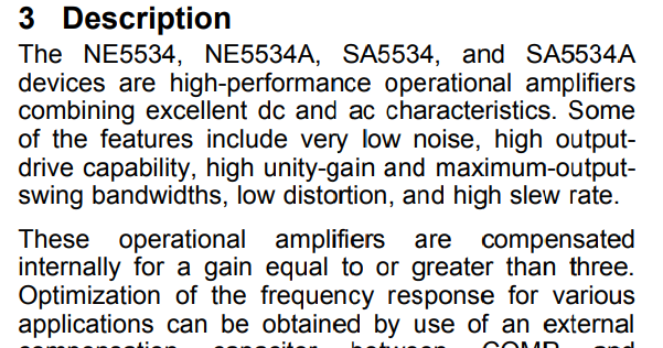

Might want to make it also accept the famous NE5534A opamp. Unlike its cousin the dual ("5532"), the single 5534A is not stable for gains less than 3, unless you add external compensation. Datasheet verbiage attached. Now people can ask and answer the question, how much worse does (candidate XYZ) sound than the 5534? How much better?

As a first-order solution, the feedback resistor (100Ω in the vero drawing) can be increased to 10k. In this case I would also recommend increasing the input resistor (22Ω in the drawing) to 100 Ohms.
I did notice that there is a more extensive compensation circuit that is intended mainly for offset-voltage nulling. In our application, we may simply include the output coupling cap(s) to prevent any DC voltage from reaching the Edcor. The links in the TI datasheet to extra documentation proved to be unhelpful in simply compensating for unity gain operation.

I recommend adding the required extra bobs and jiggeys to the board, which externally compensate the 5534A so it will work correctly as a unity gain buffer and function just like all the other M2x daughter cards. In this case "work correctly" means: won't oscillate.
If that's too daunting you could always make a DIP-to-DIP adapter (or SOIC-to-DIP adapter) that uses a 5532 dual which IS unity gain stable, and scrambles the I/Os so it matches the OPA604 single-opamp pinout.
Of course sick baxters like me would reverse bend the appropriate leads of the 5534A DIP so they stick up instead of down. Insert the down pointing leads into the DIP socket and solder bodge components to the up pointing leads.
Crude but effective. Need a high quality DIP extractor tool to swap the contrivance out, though.
