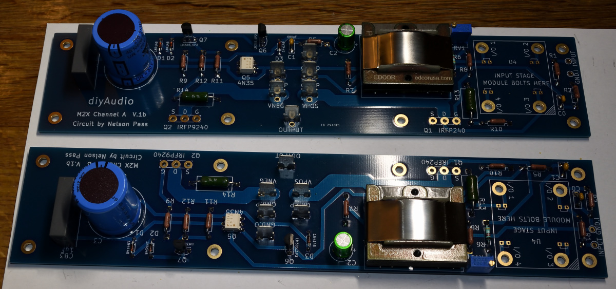

My M2x, Mountain View installed.
Should I ground the EDCOR cover to chassis ground?
The transformer I have has a purple shield ground, this should go to chassis ground also?

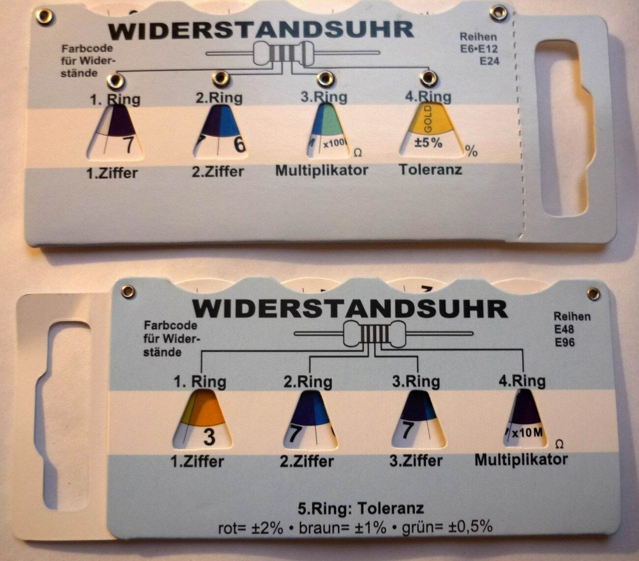

Resistors: little colour code helper
There is a nice little colour code helper for resistors, where you can dial up the colour bands and read the resistance value:
attachment.php
Available here, for example:
VITROHMETER: Vibrometer for resistor series E6 to E96 at reichelt elektronik
... or also on the big auction site.
I am still using the exact same one my dad had lying around when I was a kid 🙂
Claas
P.S.: ... but in the more recent past, I also have adopted the practice of measuring every resistor before soldering it in ... 😛

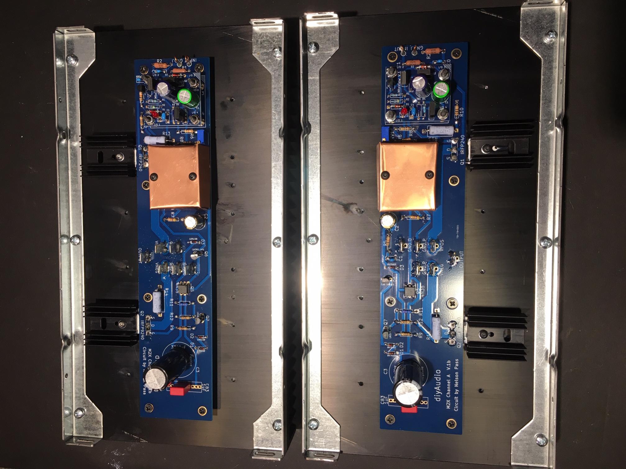

Now I am one step further. Components mounted on both amp PCBs. Edcors shielded first with 3M copper tape like they show on Edcor web:
EDCOR - MXcs Series
….and then a layer of mu-metal shield. This way I get a shield also on backside of Edcor. I assume this will be enough shielding. If not I can always build a mu-metal box and put on as cover.
I mounted C0 (220 pF). You can also see the "alien" 39,2k which is not Vishay Dale.....but only Vishay…...which should have been 37k!!
Next step is assembling the HiFi2000 5U Deluxe mono block chassis and built the PSUs (have 2 x 500 VA trafoes and L-brackets for it.....and also a magnetic steel-shield around them. Also the steel rondel is a speciel steel that act as a magnetic shield). As boxes are made for stereo amp I have much room to place trafo far away from amp board. HiFi2000 made special mono back panel still with cut outs so DiyAudio Store special kit fits.

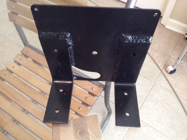

Elwood625,
Can you post a pic (front view) showing how you mounted the L-bracket for the toroid doughnut + steel enclosure. That's a pretty heavy toroid and particularly heavy with the steel enclosure!
Edit...or perhaps you are just mounting it to the future front panel, doh!
Thanks,
Anand.
I had to build something similar on mine

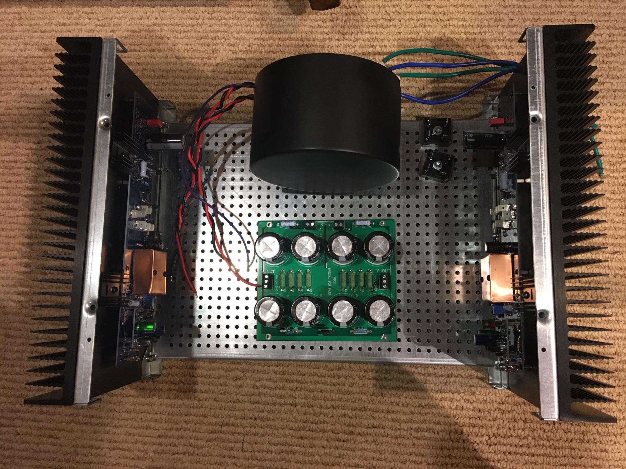

I found that using a steel case around an Antek AS-4218 worked well for my M2x. I also positioned the main channel boards toward the rear of the 400mm deep chassis, which gave some extra physical separation. The Antek AS series toroids have both electrostatic shielding and a magnetic shield band around the outside, so that certainly helps as well. My M2x is so quiet that I need to pay more attention to how I route the interconnects from my preamp.
Meper, looks like you did a fine job wrapping the shielding tape around your Edcors. I was cautious about breaking the tiny wires, so I left mine alone.
@TungstenAudio
Great insight - thank you! Not completely relevant for this build, but for a moment I was pondering "go big or go home" with the AS-6218 for no good reason at all other than the newcomer attitude of bigger must be better.
The real question - do you have any insight why Antek does not have cases for anything larger than the 400VA? I read the specs to the best of my knowledge, and I can't see why a larger transformer would not require equal shielding, but they're not offered. It's a bit off topic, but it will satisfy my curiosity. I was also looking larger b/c the cases for the 400VA are out of stock, and I was seeking instant gratification...
Looking at the AnTek Products website, I don't see any AS series transformers larger than 400VA. That means that the 500VA and 600VA toroids that some use are unshielded. It seems that AnTek intends their larger transformers to be primarily used for industrial applications rather than audio. I successfully used an AN-6450 for a Hafler DH-220 build several years ago, but that used a special power supply consisting of about 11,000 uF followed by a cap multiplier, followed by 18,000 uF on each rail for each channel.
I think the 400VA toroids are a good size for the FirstWatt clones. The one I'm using in my M2x exhibits the rated 18 VAC at the inputs of the discrete rectifier bridges, and I'm getting +/– 22.6 VDC on the main channel boards. I'm also currently preparing the chassis for an Aleph J that will have a pair of 300VA AS-3220 toroids in a dual mono configuration. I plan to run the Aleph J just as hot as the chassis will allow. I've skipped the steel cases for those transformers for now, but have left room for them if they become necessary.
