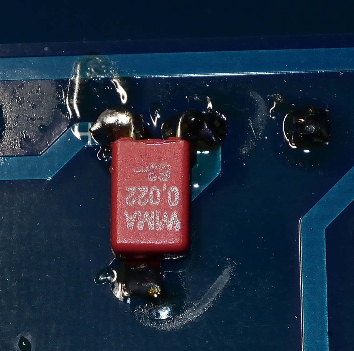

I have not cleaned the boards yet as you can see from the bypass cap at the backside. It bypasses the 10uF green nichicon (if it makes a difference I don't know but hopefully it will not harm anything). Think I will buy some Isopropanol and try to clean the stuff off. I took some care not to touch the fine wires when wrapping the tape around the Edcors. I also checked afterwards that there was still connection and no shorts.
