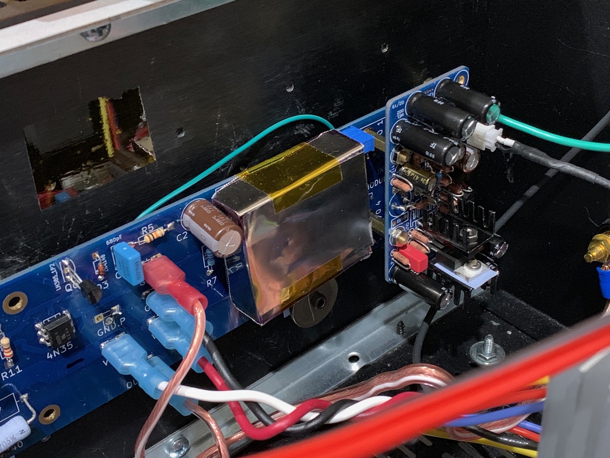

So I hooked up the three sets of daughter cards I've completed so far with V+ to pin 3 and ground to pin 1.
Results:
Tucson = 0 mA current draw
Mountain View = 10 mA current draw with the LED illuminated
Austin = .25A

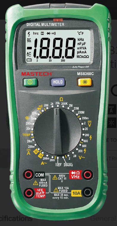

None of those sound correct when setting V+ to +23V and V- to -23V, but I agree that the Austin measurement is by far the most worrisome. A correctly functioning Austin card should draw more than 1mA but less than 10mA. 250mA means something has gone wrong quite badly. My initial guess is that one or more of the transistors wasn't installed correctly. For example in my very first Austin prototype, I accidentally swapped an NPN with a PNP. Turkey no worky.
Maybe your multimeter has different ranges (perhaps with different test lead female sockets) for different levels of current measurement. The meter below offers one range for 0-20mA, another range for 0-200mA, and a third range for 0-10000mA (ten amperes). But you need to move your test lead from bottom left to bottom right, before you can measure on the ten amps scale. Make sure you've selected the appropriate range when measuring a small current such as Tucson's supply current. When using the OPA604 opamp, Tucson should measure somewhere between 7mA and 15mA. Not zero.
_

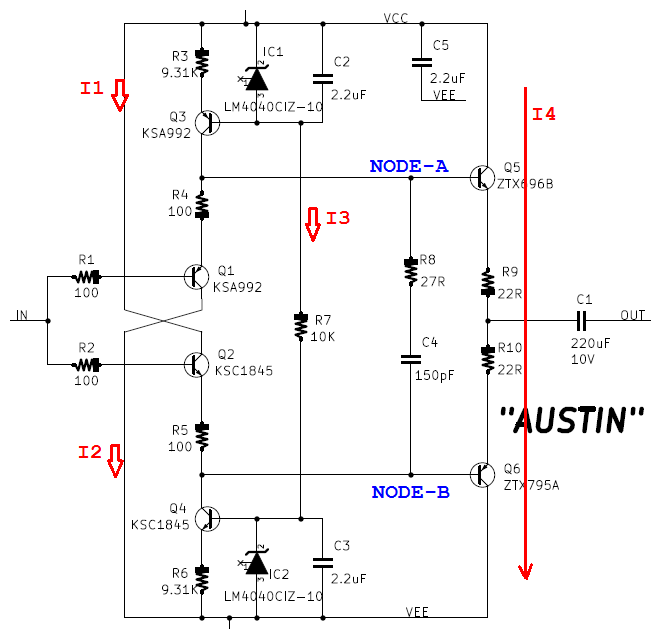

My experience with listening tests is that it takes time to find out if you like an amp or not. Usually several days. An amp that sounds very good first time you listen can cause listening fatigue after some days. The mood you are in also have something so say. Amount of earwax…...humidity…..temperature...…..can also change the sound (e.g. speaker suspension and speaker material). Rubber gets softer with temperatur which causes the resonans frequency of an e.g. woofer speaker unit to drop a bit.....etc. etc.....not easy to perform an objective listening test.
In case anybody wants to analyze the Austin circuit and hand calculate its current draw when VCC is +23V and VEE is -23V, I've attached an annotated schematic below.
Austin's supply current is the sum of four individual contributions:
- I1 is the current which flows through current source transistor Q4 and input follower transistor Q2
- I2 is the current which flows through Q3 and Q1
- I3 is the current which flows through the bias generator, IC1 + R7 + IC2
- I4 is the current which flows in the output stage, through Q5 and Q6
Please enjoy!

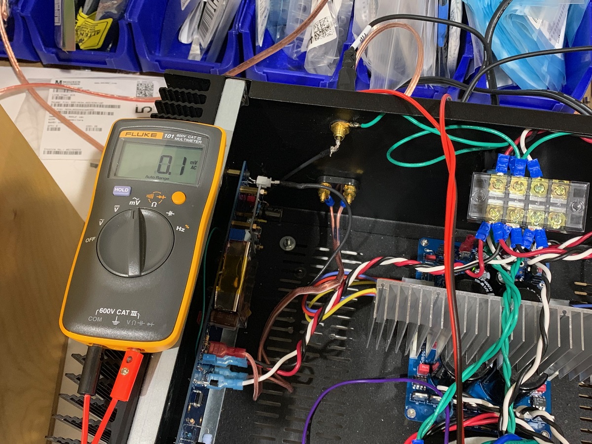

Hi Mark -
I retested the daughter boards using my Fluke 88 which has a mA selection for DC and AC, results:
Austin 1 = 8.26mA
Austin 2 = 8.30mA
Tucson 1 = 4.49mA
Tucson 2 = 4.36mA
Mountain View 1 = 23.81mA
Mountain View 2 = 23.89mA
I'm very glad I followed your advise to test on the bench, I had swapped the base and Collector pins on Q2 & Q4 causing the high amp draw.
I hope to test the power supply in chassis Monday, which leaves just the amp boards untested. Those I will power up one at a time for testing.
When I 'm ready to adjust RV1, is DC offset the only measurement necessary for proper adjustment?

The second stage ("VAS") is not an entry point for supply noise, leaving only the first stage ("input buffer") and the third stage ("power output stage") as possibilities. And both of those are unity gain followers in the original M2.
_
_
I guess a push-pull design with a +- supply is better to reject PS ripple than a SE design. But it seems a 9240 transistor is not a perfect "mirror" of a 240 which would have been the best case for rejecting ripple…...in the output stage.....logical thinking?
But I always think of this Niels Bohr quote when I try to be logical:
"No, no, you're not thinking; you're just being logical"
He was probably a clever man.
I cheated and used an IRFP9140 transistor, same as one Wiley Zen Mod. Perhaps it was the logical thing to do, but the amp sounds wonderful.
The Melbourne input daughterboard has been tested with the M2X. It works very well and the sound is excellent. Wide, wide soundstage, superb imaging, deep incredible bass. No noise or hum. Important to tie Melbourne GND to PSU star GND, not local GND on M2X. Also needs to be DC coupled to prevent oscillation from LC tank circuit created by output coupling cap and Edcor. Also, tie RCA panel jack GND to the star hub GND on PSU as well and cut the GND connection from the M2X input to the RCA jack. That solved a huge ground loop hum problem. This is useful on the basic M2X with a Tucson even.
Melbourne Daughterboard for M2X
Anyhow, the Melbourne is now verified to work inside the M2X, and provides a nice 15.6dB of gain that is useful for weak sources like phones and Mp3 players, Amazon Dot, etc.
