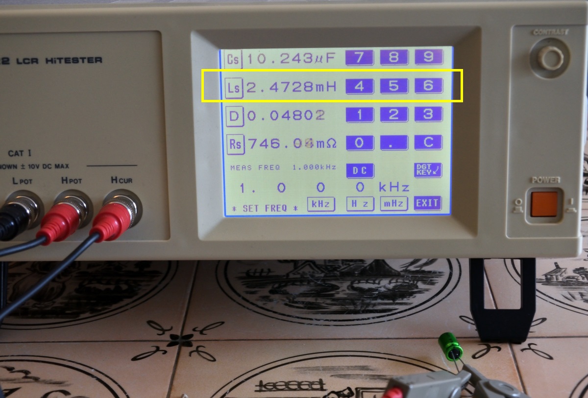

I made a measurement on 3 different Nichicon 10 uF capacitors
Hi MEPER, congratulations on deciding to make some measurements yourself! A brave decision which I admire very much.
I find one aspect of your photographs a bit confusing, see yellow box in Figure 1 below. It's hard to understand how a 10uF electrolytic capacitor could produce a reading in the millihenries (1 x 10^-3) ?? Usually electrolytic capacitor measurements give an Equivalent Self Inductance ("ESL") in the nanohenries (1 x 10^-9).

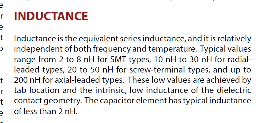

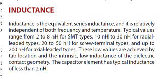

Figure 2 is a snip from the document "Aluminum Electrolytic Capacitor Application Guide" by Cornell-Dubilier, a manufacturer of high quality electrolytic capacitors. It says nanohenries not millihenries.

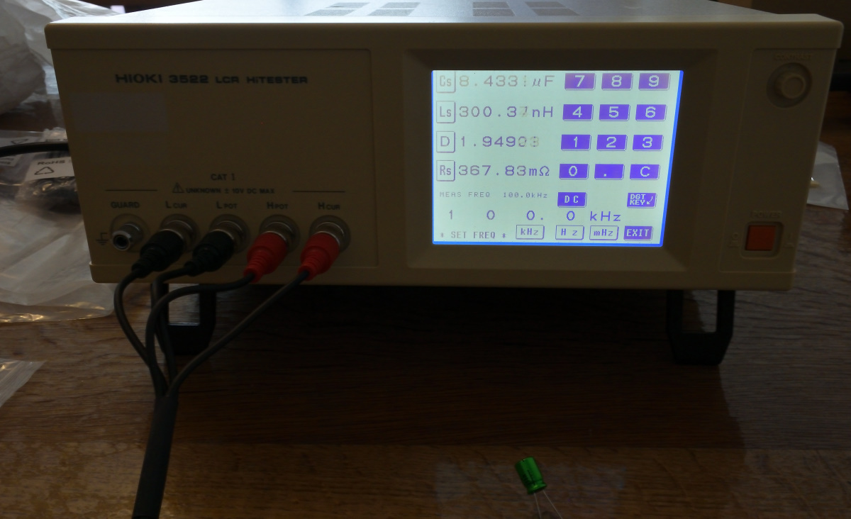

Also I had some fun last year measuring electrolytic capacitor ESL myself, using a slightly weird mixed-signal (analog + digital) test jig I built:
Measuring the "ESL" inductance of electrolytic caps (at 10 MHz!)
Again the results were nanohenries, not millihenries.
Could you explain a little bit, why your measurements say millihenries? That is about a factor of 10^6 (one million times!) different than expected? Thank you!

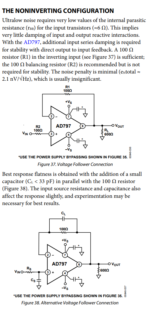

Remember that all five of the input stage daughter cards shipped with M2x, including Tucson, implement a "buffer", which is a noninverting amplifier with a gain of 1.0.
When we look at the manufacturer's datasheet for the Analog Devices AD797 we see the information copied below.
It tells AD797 customers that if they want to operate AD797 as a noninverting amplifier with a gain of 1.0, they must add two resistors R1 and R2, which are not included on the Tucson PCB. And if you want best response flatness, you should also install capacitor CL, and then experiment with its value "for best results".
This is not impossible but it is cumbersome. Since the Tucson PCB does not include "footprints" for any of R1, R2, or CL, you must add them as "bodge" components, after cutting the appropriate PCB traces. It is not impossible, it can be done, but I myself will not be trying it any time soon.

I looked in the manual for the tester to see if there was any hint. The examples where capacitance was measured Ls was not selected. Up to 4 parameters among many can be selected on screen for a measurement. The tester does not know which component tested. It tries to match to an equivalent circuit by doing "some" measurements. If I go down to 50 Hz Ls shows 900 mH and if I go up to 100 kHz Ls is about 300 nH (picture). So think more info is needed on how the tester measures the different parameters. Maybe Ls is not "meaningful" for testing larger capacitors. As far as I could see voltages/current was within limits.
They do write this:
Rs effective resistance in series equivalent circuit mode (Ω)=ESR *2
So think Rs can be "trusted". I also thinks it matches data sheets from previous measurements.

A bit more on how it measures. It seems to be a simple series or parallel circuit the tester tries to "adapt to". For larger capacitors the series values are recommended…..like Cs, Rs, Ls etc....Cp, Rp, Lp can also be selected to be viewed.
The 3522-50 unit analyses the test sample in terms of a pure inductive
component (L), an equivalent circuit construction composed of a pure
capacitive component (C), and a pure resistive component (R), and calculates
as though these components were connected in series, or alternatively
connected in parallel. Therefore, it is possible for the user to select either a
series equivalent circuit mode or a parallel equivalent circuit mode for this
conceptual connection together of these L, C, and R components.

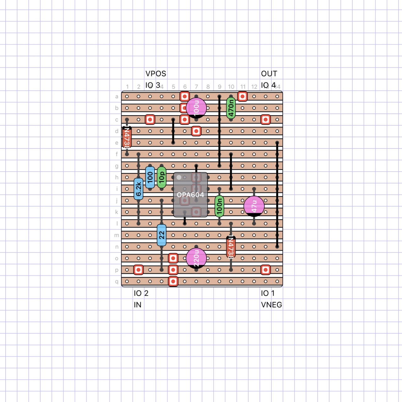

With the recent discussion about opamps for the Tuscon IPS, here is an updated layout of the through-hole version on veroboard. There are a few DIP-8 opamps that appear interesting, including the MUSES03, OPA134, and the AD797, besides the OPA604. This board includes provisions for the resistors and capacitor that are recommended to operate the AD797 at unity gain. For other opamps, the 10pF cap can be omitted, but the resistors are probably Ok to leave or replace with jumpers. There is room for both an electrolytic and film bypass cap for the output AC coupling, but if the opamp has sufficiently low* input offset voltage, those may also be replaced by a jumper.
* I like to see less than 1 mV input offset voltage before I omit the output coupling cap.
