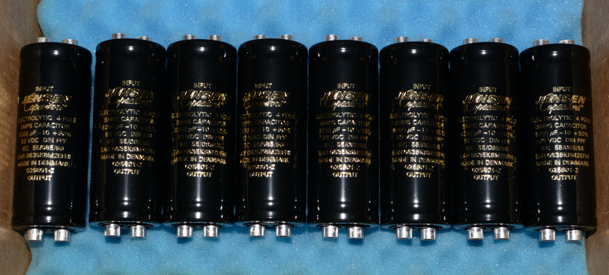

My M2X build is progressing slowly with build of 2 x universal PSUs (I build mono blocks) and the plan is to add a RC link using Jensen 4-pole caps. I use the large 5U chassis so plenty of room inside…..so why not have some fun? :)
A Jensen white paper on 4-pole caps for those interested:
http://jensencapacitors.com/CustomerData/Files/Folders/4-pdf/5_4pole.pdf

I have not seen the 4-pole used anywhere but I know Jensen sell a few each year so someone are probably using them. The link at Mouser are to caps which are rather small?
The Jensen at the picture are quite large (8200 uF / 63 VDC). The plan is to use them as the last link in the CRCRC chain. CRC from universal PSU PCB and then the extra RC using 4-Pole as the "C". Just to see how low I can get ripple/noise…..even that I know it is not necessary….and that M2X amp has very good ripple rejection.
^ Be mindful of the current rating of those Jensen 4-pole caps. They are true feed-through in the sense that the full power supply current is conducted through the 'plates' of the capacitor. Current rating is a function of the diameter of the capacitor, as the only way to increase current capacity is by increasing the area of the plates.
I remember reading an account of someone who tried these in a high current amplifier, and found that the Jensens got very hot and started to smell bad after just a couple minutes of operation.
Ok.....I will check the current limitation. I will have two in parallel for each MX2 board (so four pr. board.....two for +24VDC and two for -24VDC) And if last in chain the ripple current will be very small. It is almost DC at that stage so assume that current draw is almost bias current…..so less than 2A?
I was assuming that these 4-poles could take "some" current…….
It is the DC current rating to watch with these caps. This is a case where the constant bias current of a Class A amplifier makes component selection more difficult. Having two of the Jensens in parallel will help with the current handling, provided that the current is evenly distributed between the two.
