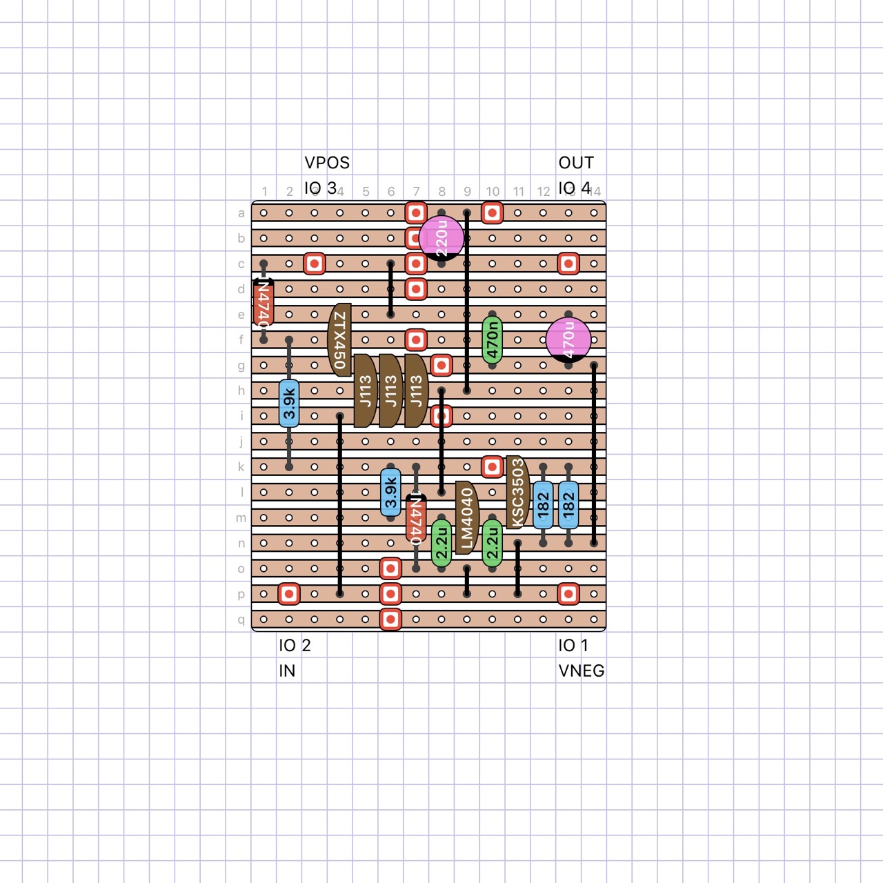

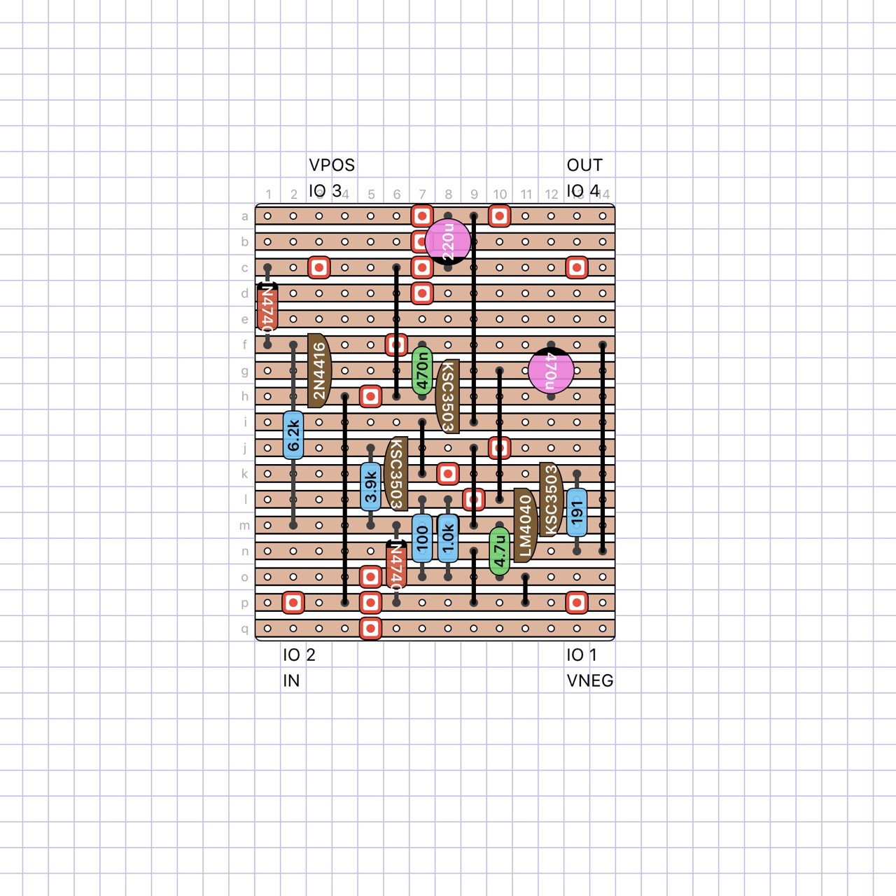

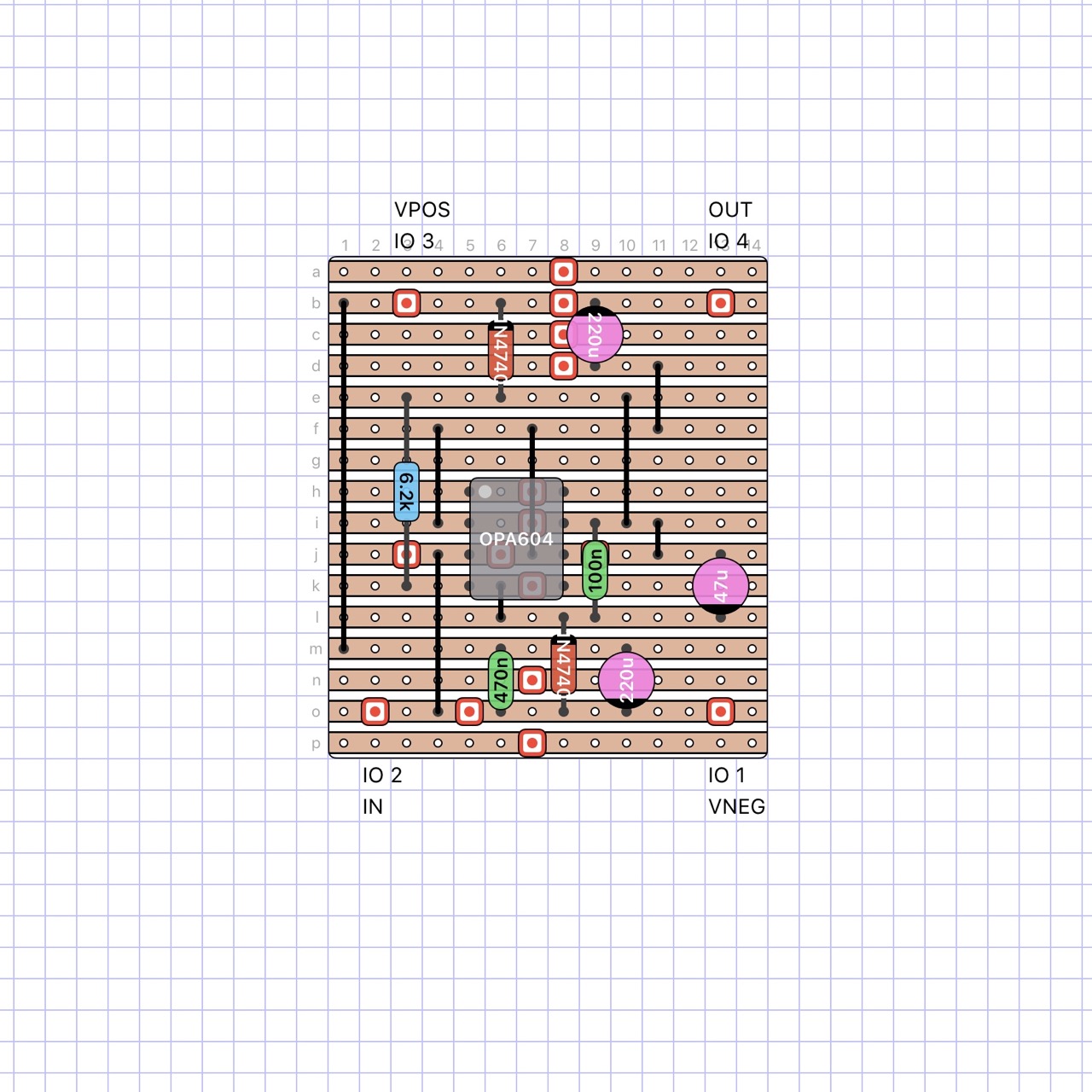

I have drawn up a few IPS designs using 'Vero' or stripboard, including ones for Mtn View and Moffett Field. I actually started with a through-hole version of Tuscon, so I could build the SMD version using the OPA1611, and have a second pair of boards to use for the OPA604 and compatible DIP package opamps. I've included some screenshots of the board layouts, which are all currently un-verified. I am familiar with this style of board construction, having built a few custom pedals for my bass guitar. It is definitely an advanced technique, compared soldering components into a fabricated PCB. But then if a bunch of guitarists can do it, shouldn't be too much trouble for some of the more intrepid amp builders.
I have taken the liberty of substituting a LM4040-2.5V reference IC for the red LED that is used to bias the current sources. I adjusted the emitter resistors to get the same(?) current used in Mtn View. The Moffett Field design incorporates the ZTX450 "bias dropper," and has the current source set for 20 mA, but may be adjusted by tweaking the parallel 182Ω resistors. I can make more information available once I have verified the board layouts. (Mtn View has a hidden trace cut underneath the 1.0k resistor.)
Might want to doublecheck the datasheets of the semiconductor devices in your veroboard layouts. The 2N4416 (middle picture) comes in a TO-18 metal can, not a TO-92 plastic package. There might also be pinout discrepancies in some of the footprints but it's hard to tell.
Since veroboard is single sided copper whereas M2x daughterboards are doublesided, you will have fewer opportunities for the daughterboard to make a reliable electrical contact with the mounting bolt. You might want to consider using Mouser part number 534-7318 to give yourself more opportunities to connect solidly. Solder the wire to the PCB and slip the annulus over the bolt, either below or above the daughtercard. Perhaps both?
These are small enough to go in the same electroplating bath with your mounting bolts, nuts, and star washers, if you decide to plate them with rhodium or gold.

Yes, I need to amend my description of the Mtn View veroboard design. In addition to showing a 2N4416 in place of the J112, I also had the 2.048V version of the LM4040, not 2.5V. The emitter resistors in the current sources are set for the 2.048V reference. I have used 2N4416 JFets before in other veroboards. Their metal case pinout is easily adaptable to fit an inline pinout that will match the J112 & J113. The 2N4416 is now available from Linear Systems, and NAC Semi has them in stock. More expensive than the J112, but very good performance. I am in the habit of using three hole sockets for all the small transistors, so it's easy to swap devices. I am still using a 2.5V version of the LM4040 for Moffett Field.
The LM4040 references are available in several voltages and initial precision ratings. For a 2.5V reference, there is also the LT1009, which has better thermal stability and an initial tolerance of 0.2%. Of course these are more expensive than the red LEDs, but hopefully more widely available. If they prove to be suitable for the Mtn View IPS, then it is possible to use them in the existing PCBs with careful installation in the two hole footprint for the LED, and appropriate values for the emitter resistors.
I am concerned about achieving a reliable electrical connections through the mounting holes. Drilling these holes in the correct locations is one of the most difficult aspects of making the boards. I used a bench top drill press and three layers of masking tape to hold two boards in place on a larger piece of MDF that helped the drill bit stay true to the location. Unfortunately, the board I'm using has holes on 0.1" spacing, not metric. I will look at the Mouser part that you mention to see how it might work.
