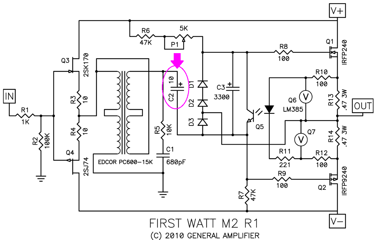

Attached below is the original First Watt M2 schematic, with "C2" circled. In this schematic, C2 acts as an AC coupling capacitor between R5 and D3. Is that the capacitor you are talking about? Does M2X have a 220uF capacitor between R5 and D3?

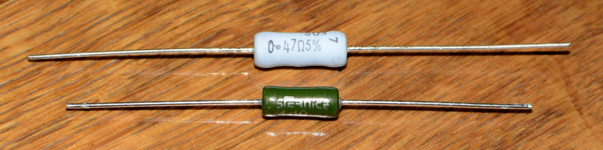

I have two types of .47 ohm 3W power resistors. The usual Panasonic MOX type and Vishay wire wound glazed type that is a bit more robust and has lower temp. drift (75ppm/C vs. 300 ppm/C). When I measure on a bridge they have about same data up to 100 kHz. The wire wound has a bit lower serial inductance…...which was a bit surprising….but noting to "talk about". You prefer the MOX type as source resistor for the output mosfets for subjective "audio" reasons?

I think deafbykhorns is referring to C1 on Ishikawa.
That capacitor is talked about in the .pdf in post #1, as well in the thread on post #2 and #4.
(Dont install it and just use a bit of wire if you like.)
That's exactly what I was looking for, wasn't sure why it was used except to protect the Edcor. Couldn't 220uf cause some phase shift or should be calculated on output impedance of source?

For the 0.47 ohm 3 Watt output resistors named "R13" and "R14" in Nelson Pass's Original M2 Schematic (identical resistor IDs in the M2x MainAmp schematics attached to post #1 of this thread),
the key thing to do is buy close tolerance (5% or better) in a 3 watt rated resistor, while still fitting into the footprint that's on the M2x PCB. I suggested KOA Speer Metal Oxide resistors (link to Mouser sales page) because they're cheap and plentiful and meet the criteria above. Oh and they're also not wirewound, so I don't have to listen to the same old tedious arguments about the stupidity or wisdom of using WW resistors in that position. If diyAudio members want to "discuss" (argue) about wirewound resistors, please go right ahead with my blessings, but I won't be participating.
I will say that for a completely different project which is not named M2x, I've selected Vishay "PR03" 3 Watt Metal Film (not metal oxide) resistors, because they are a little better thermally. Their thermal resistance theta, in degrees C per watt, is a wee bit lower than the KOA Speer Metal Oxide resistors linked above. But this might be totally irrelevant for the M2x since R13 and R14 on the M2x MainAmp board don't feel warm when I touch them. Do they feel warm when YOU touch them?
If you have the expertise and the equipment to measure 0.47 ohms, plus or minus 0.005 ohms, then I suggest you buy more than 4 pieces of those resistors, they only cost 25 cents each. Then select matched pairs for each amplifier channel. This cannot possibly hurt, and it might possibly help in some way, so: why not do it??
Ok....I will try to match two 0.47 ohm 3W resistors. I don't think I will be able to hear any difference between different technology resistors. Some may even like carbon resistors. Often 5% resistors are much better than 5%. It is probably hard to make them so different with todays production methods. I have a HIOKI LCR tester I can use for matching.
