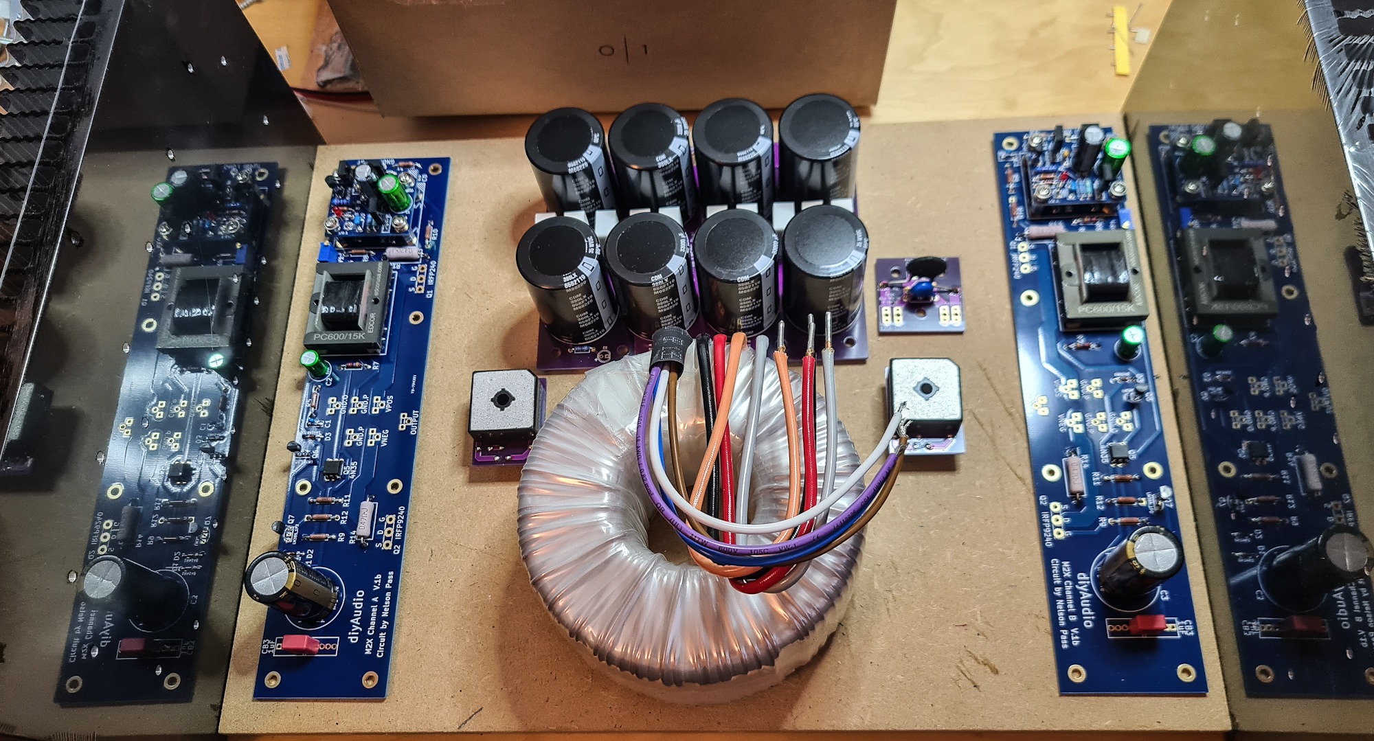

Zen, can you explain this logic before I mistakenly move forward with moving my PS into an outboard enclosure myself?
I built two power supplies for my first build planning for a dual mono build but then after hearing how good my F5 sounded with one, I didn’t install the second. Now that I’ve been listening for many months I’m curious.
What changes when a dual mono PS is moved from inside the enclosure of the amp boards to an outboard enclosure set nearby (beside the longer wires)?
take it as CRC
first C is with rectifier , in PSU case
then umbilical is R
then final C is in amp case
logic of things is that power reserve is near channel pcbs, or else there is no benefit if you have it remote, introducing another R in between last C cell and channel pcbs (unnecessary length of wire)
motor runs are , as I said , cherry on top, but they're minuscule power reserve; you need mF for that, not uF
again, simple logic
same as is - whichever voltage regulator you're using for low level stages, it is always best to have it either incorporated on same pcb with active stage, or nearest possible (in case of separate reg pcbs)
for best results, power traces always need to be shortest possible
then umbilical is R
again, simple logic

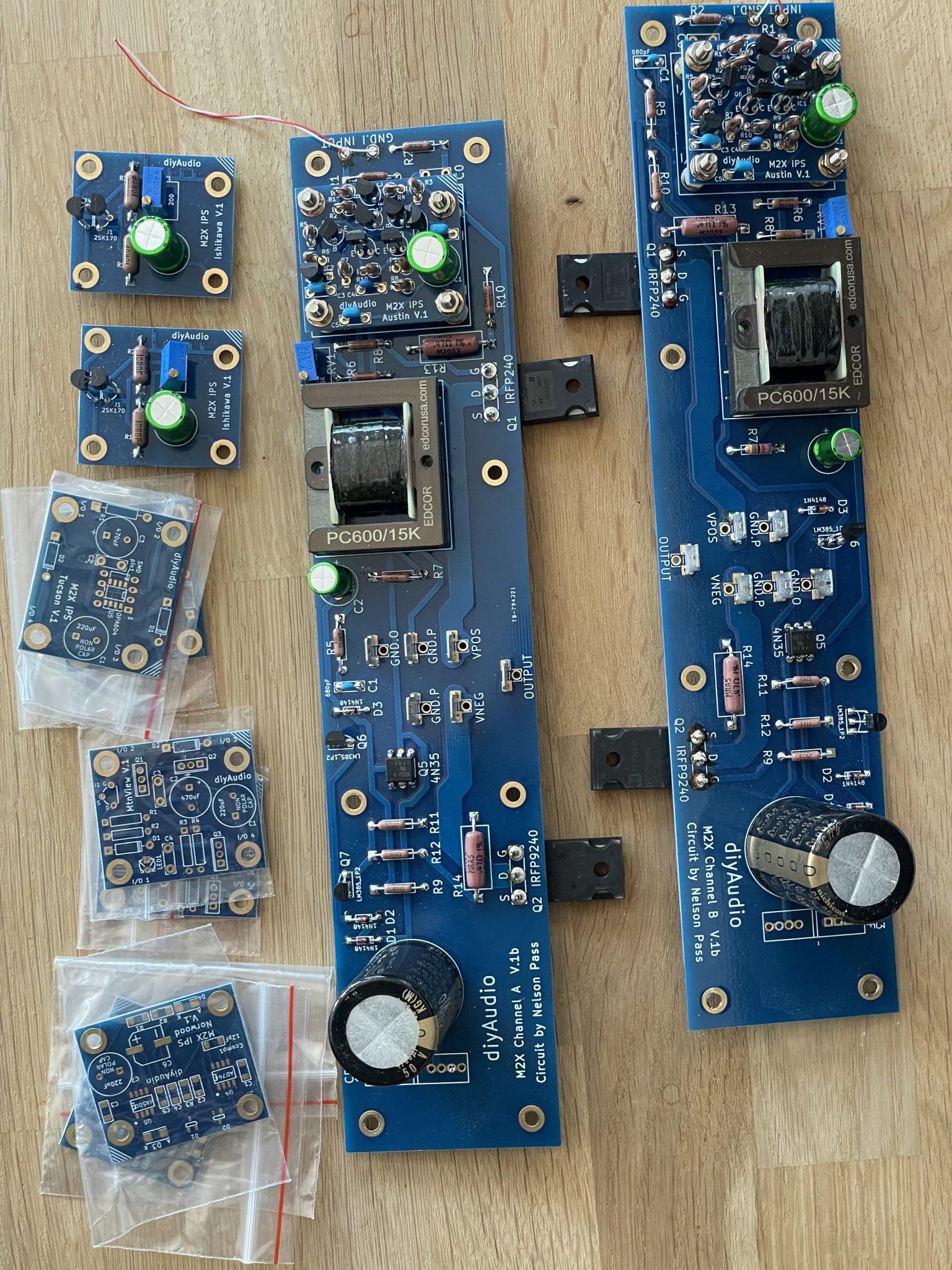

// Just because it will be for a M2X //
Can not get OPA604 anywhere at the moment, looked for alternative without being so sure, thought TL071 might be worth a try as a stop gap and this, from the Ship of Theseus thread, is helping i guess https://www.diyaudio.com/community/...ngeable-amplifier-modules.383745/post-7108786
If not appropriate, please tell me.
Though it might help others at some point, hence put it thereIf you're worried about your unproven Nimitz destroying your precious Norwood daughterboards, stuff and solder your Tucson boards and use dirt cheap opamps (I suggest TL071 which is plentiful and costs less than $1). Give Nimitz a chance to wreck your Tucson boards -- they are expendable. If it doesn't, leave Tucson in the amplifier for a week or two just in case trouble manifests itself gradually. Finally when you've got plenty of confidence in Nimitz, swap Tucson out and swap Norwood in. Done.
