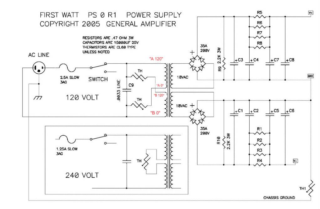

Hi Plott,
since you are in 230V country, probably something like 1.6A to 2.5A T (slow-blow) should work. As to sizing: the lowest value that only blows at switch-on once every three months or so. That's how I size my fuses. I suggest buying a 10-pack of 1.25A, 1.6A, 2A, 2.5A each. For example, at TME or Reichelt.

Maybe this other thread might be of some utility
Not thrilled with CL-60 inrush limiter in USA/160W Class A First Watt designs
since it discusses M2x mains-fuses blowing due to inrush current at power on.
In addition to the first post of the thread, also have a look at post#17 , post #25 , and post #41

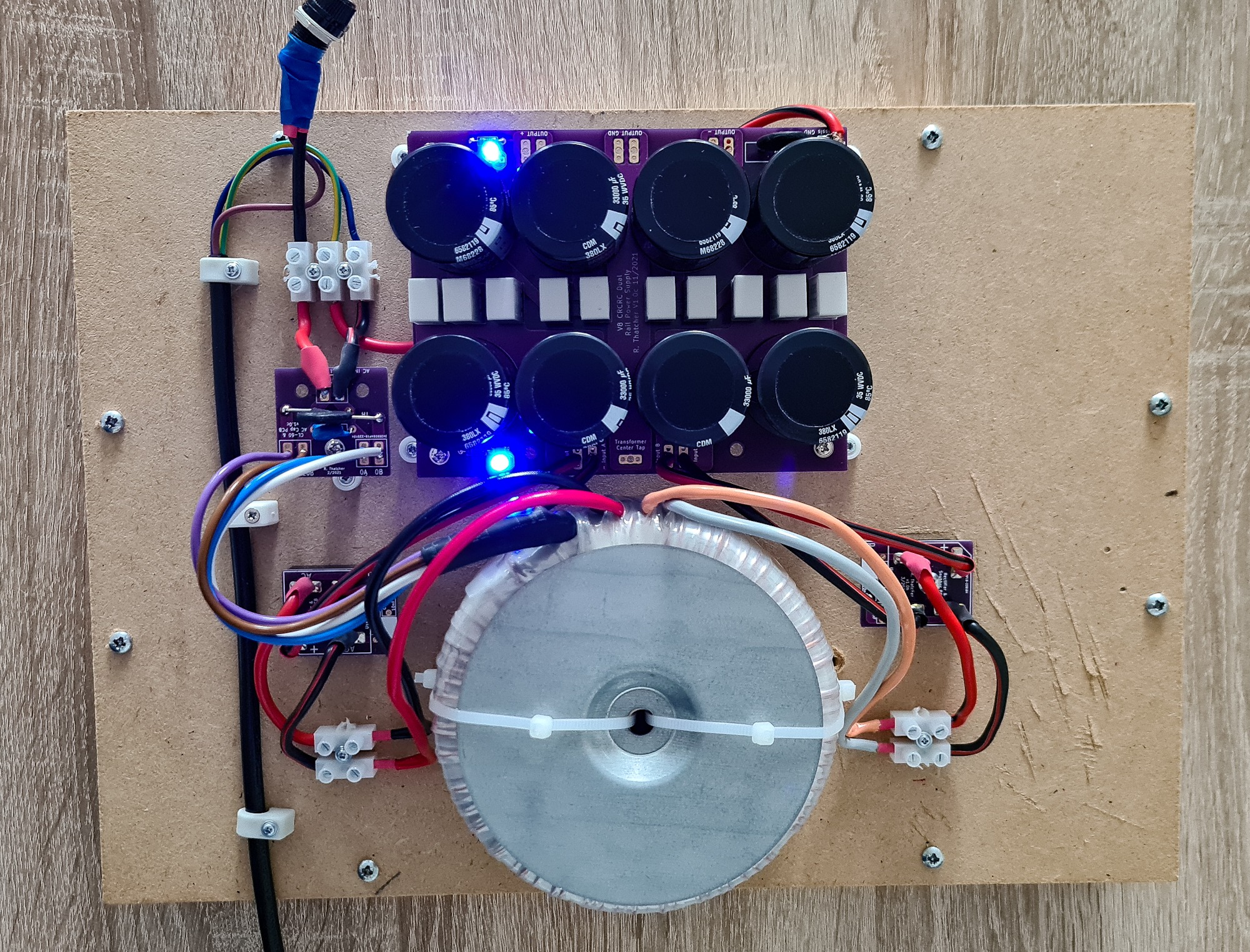

Ya I guess it's just a quick easy way to get a ballpark number for folks that have chosen a transformer thats sized appropriately for the circuit being powered, i.e. not using an 800W rated transformer on a puny 160W load. A bigger transformer will have a larger magnetic structure to fill with energy (inrush current, even with no load), saturated impedances are smaller. That inrush shoots up once we hang a bunch of big reservoir caps off of it. Decades worth of cussing and discussing on dealing with that problem of course... I use a pair of NTC's in series with the primary to deal with the inrush, and then bypass those with a second switch after a few seconds so as not to throw away any secondary voltage, and avoid scorching hot parts running in the chassis all the time. Crude, dumb, and lazy.... I know, I accept the dumb-ness, just sticking with what works for me ("normal" sized fuse that never blows)...Thanks William - I thought it's about the current consumption of the amp which is independent from the transformers VA rating. I can use the same amp with a 400 va and an 800 va transformer, but the amp needs in both cases the same amount of current.
I know, I know the chassis will arrive in two days, I just wanted to know whether the PSU works.those MDF bards are great for bridges cooling, so feel free to proceed with full amp, like that

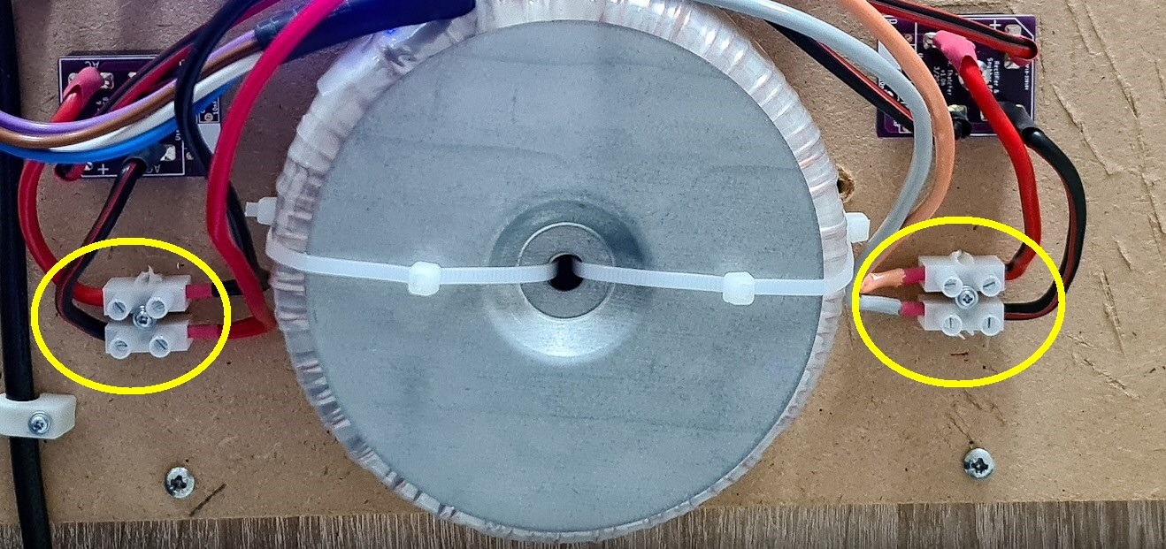

Yes, I'm planning to do that. For the snubber-parts there is a dedicated place on the bridge-pcb.It appears you have a convenient place to add C+RC snubbers across the transformer secondary windings, now or in the future. If you ever get the Quasimodo itch and want to implement critical damping in your power supply.

The whole PSU will be doubled, with two 300va Anteks, 4 bridges and two cap banks. This thingie was just a test run for the cap banks.
Here is the bridge-pcb, I'm sure you know it:
When you 'test' the power supply, you really need to have a load equivalent to the amplifier current to see that the power supply is behaving itself under working conditions - I suggest you connect a 16R load to emulate a current rate of approx 1.5A thru the load to check the power supply is functioning properly.
Regrettably, this isn't a standard procedure for many diy folks and, IMHO, it should be ....

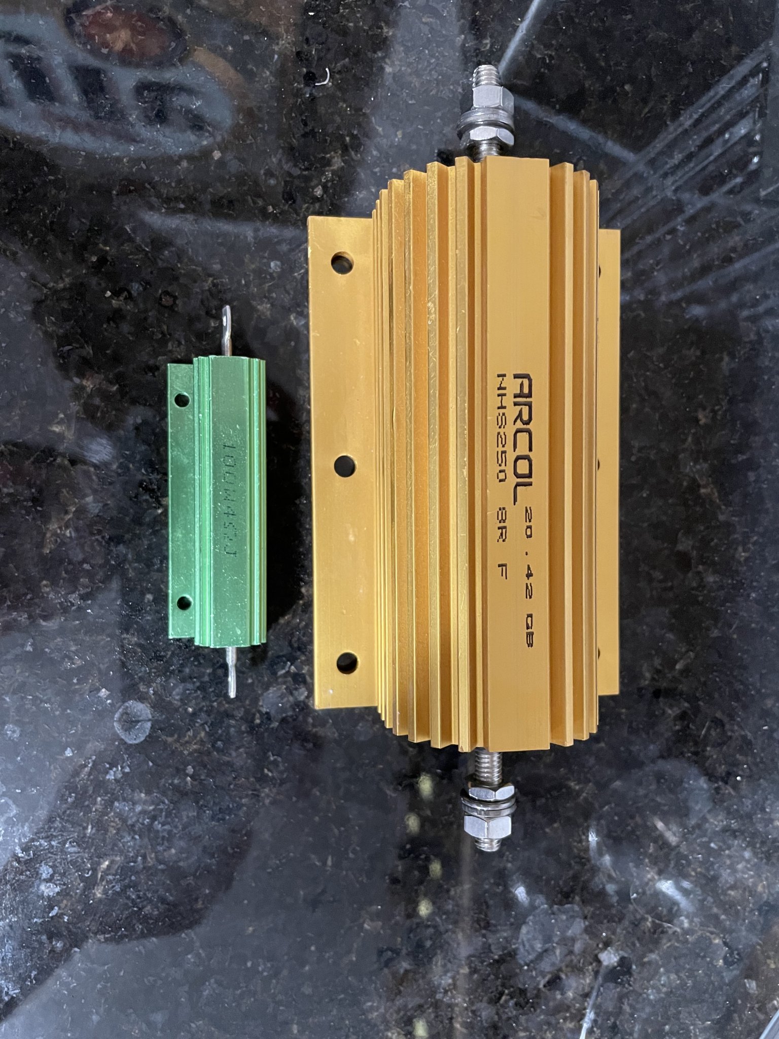

Hi Plott -
I'm not sure if they're readily available near you, but a few 250W / 300W non-inductive load resistors from a reputable source are nice. I also got a few 4 and 8 ohm 100W resistors (inductive) for much cheaper on a reseller site. I like the larger ones for work with (with heatsinks) for power amps. The little ones (even with a heatsink) get pretty warm / hot even during a standard 1W distortion measurement. I got a couple of the ones linked below except in 250W format. For the price difference, I'd go with 300W. The 250W remains nice and usable up to 75W (with a heatsink), which is the highest I've ever tried (so far). Just a couple ideas.

Pic of a good 250W vs. a reseller 100W.

Edited to add - this type comes highly recommended from another trusted user, but I haven't tried them myself. To my knowledge, they're not available in 4 or 8 ohm, but 10 ohm is certainly usable.
