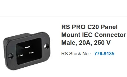

I try to avoid using connectors we commonly use for audio signal for power connections. Nothing preventing you from using appropriately specced XLR connectors though.
https://www.neutrik.com/en/products/audio/powercon (Search “powercon”)
https://www.amphenol-aerospace.com/products/power-products (search ”circular aviation”)

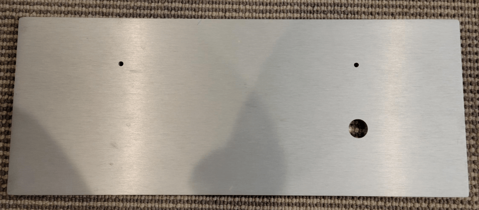

I have a lightly used 4U aluminum faceplate with two holes for LEDs and 1 19MM hole for an MFR# MC010920 push button on/off. Ideal when used with Mark's soft start CB.
I offer this for shipping costs, which have been $22.00 for the other ones I have moved on.
Send me a VM if interested.

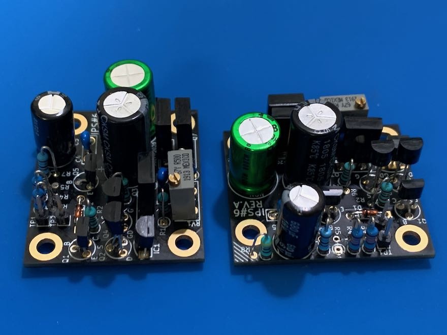

Anybody enjoying the IPS6 cards as much as I do?
My M2X works very well with my MLTL Single Driver (Fostex 167E) speakers with the IPS6 inside. I followed MJ's instruction to set the boards properly and then bliss all the way!

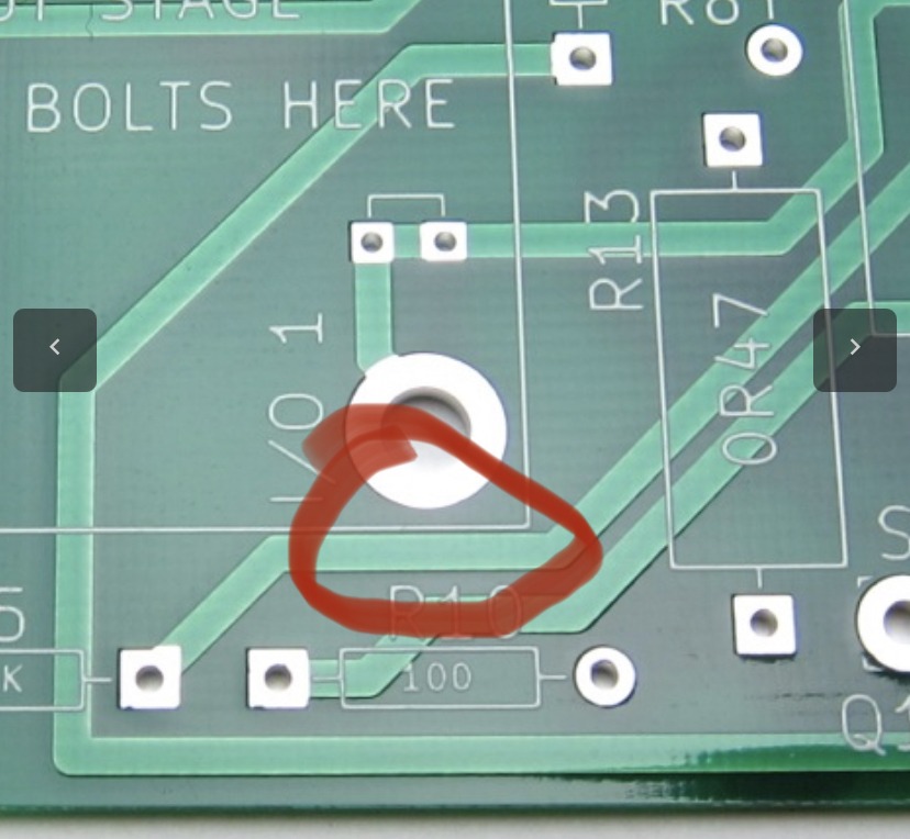

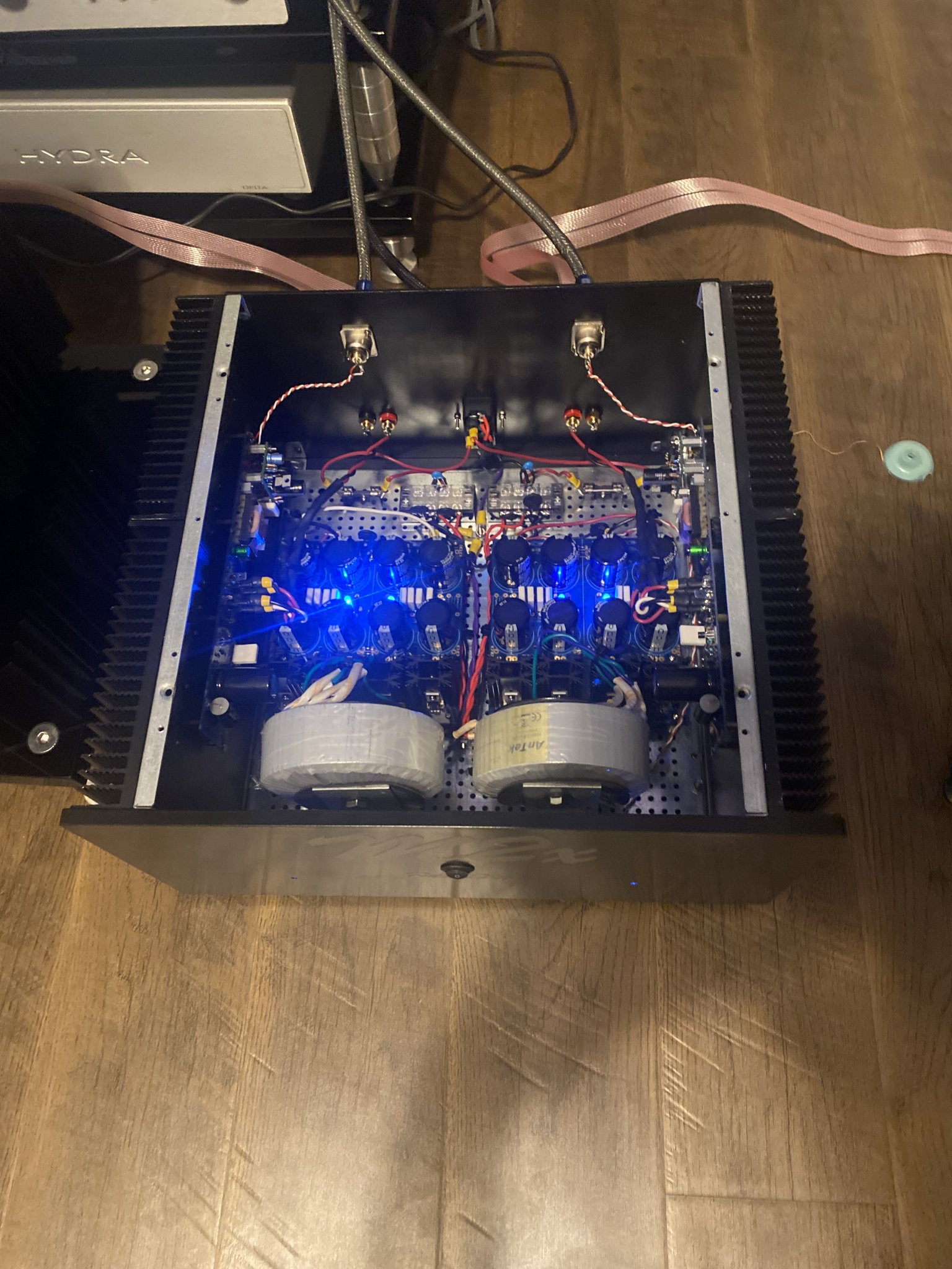

Could use some guidance on my M2x. I recently finished a dual mono version but having issues on the right channel. It hums and has no music playing, and the d44h11 and AD797 on the Cedarburg boards get VERY hot to the touch.
Here is the information and troubleshooting I have done so far:
- I swapped input boards to test on the other channel and confirmed both Cedarburg boards work fine.
- I confirmed +/- 25 Volts at the board
- I checked the 4 posts of the input boards and get, +25V, -25V, -1.05V (but keeps climbing up), and -1.5V
- I reflowed the solder on the boards
- I confirmed my washers were not touching any of the parts on the input board
- I confirmed the 4n35 is on correctly
- I checked and confirmed all parts look correct
- I am able to easily set DC offset on the board down to 0
Any help is appreciated!!!

What is your source driving the M2x? Have you swapped R and L cables from the source ruling it out as the issue?
Might have found my issue. The lock washers I bought were a bit too large and I noticed the bottom right daughter board post had the lock washer sitting a bit low and it was tightened onto the trace below it that comes from R5.
This wasn’t a problem on the other board because there weren’t any close traces.
I’m going to buy some smaller lock washers tomorrow and swap them out. Hopefully that solves my issue.
I should have known better and search more for the smaller ones….
Here’s a picture of the area I am referring to.
Congratulations on a beautiful build! Those black PCBs look sexy as hell with ENIG gold traces.
I happen to think IPS6 is doubly delightful. First you get the tweak-lover's delight of matching the JFETs and dialing the 20-turn trimmer pot for perfect balance. Next you get the music-lover's delight of listening to the rare and delicate beauty of a (very) high gain transconductance amplifier, driving an Edcor interstage transformer.
*transconductance amplifier means it's a voltage controlled current source, whose open loop output impedance is extremely high (> 100 Kohms). All the other IPS cards are voltage controlled voltage sources, and they drive the Edcor transformer very differently.

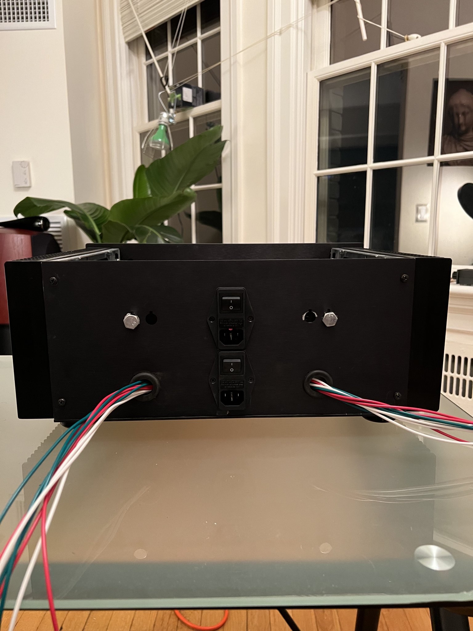

Has anyone tried DC-specific IEC connectors for the umbilical connection between amp and external power?:
https://www.newark.com/schurter/3-104-044/power-entry-conn-rcpt-8-8a-294vdc/dp/99AC3565
https://www.newark.com/schurter/3-101-786/power-entry-conn-plug-8-8a-294vdc/dp/99AC3564
They're super inexpensive, and likely to support anything I build in the future. I think I'm going to give them a try.

For my dual power supply, I used IEC connectors with the pins the opposite way to "normal" leads.Has anyone tried DC-specific IEC connectors for the umbilical connection between amp and external power?:
I'd enlarge the holes I'm currently using for pass-through:
The theory being that a 240v lead will not plug in.
Something like this.
If that is at the power supply output, the exposed pins are not safe. If the power supply is on with no cable connected, a person can get zapped.
Another suggestion is to label non-standard power outlets and amplifier power inputs with the type of power out/in so there is no confusion when the power supply is separate from the amplifier.
Be safe.
Be safe.
Or use Speakon or XLR 5-pin for the DC power. Extremely safe and reliable. XLR's current rating is way beyond the demands of M2.
For clarity.If that is at the power supply output, the exposed pins are not safe. If the power supply is on with no cable connected, a person can get zapped.
Be safe.
Those are input sockets on the amp, so not live unless the plug (Which has shielded sockets) is in place.
Plugs are on leads hard wired to the P/S. 🙂

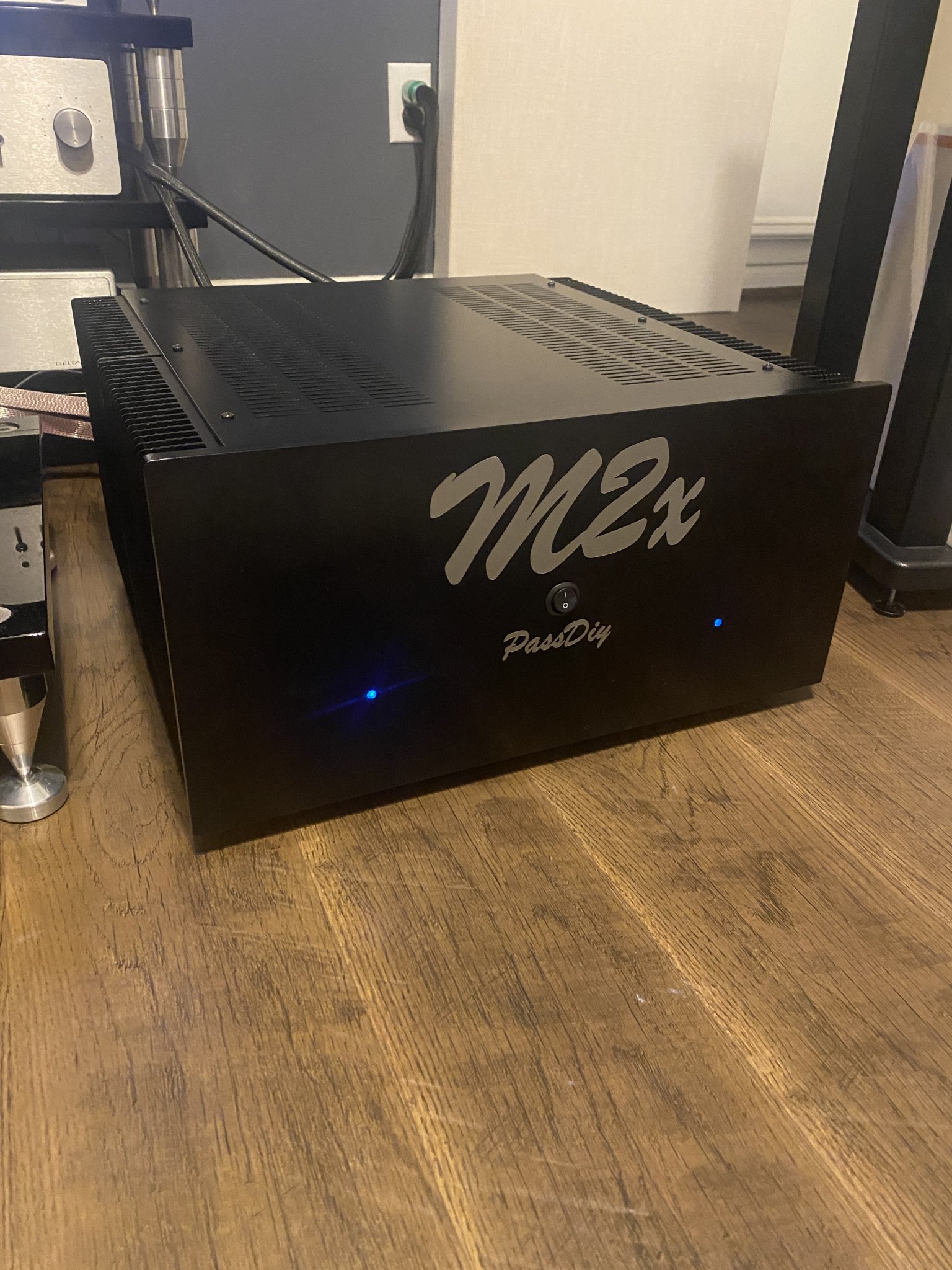

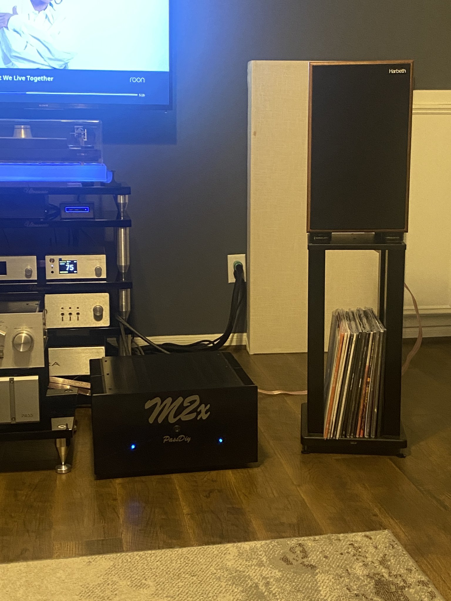

Another M2x is born! Dual mono rocking the Cedarburg boards!
I corrected my right channel hum issue… just had oversized lock washers on the right channel daughter board posts digging into a trace on the board it shouldn’t have been.
