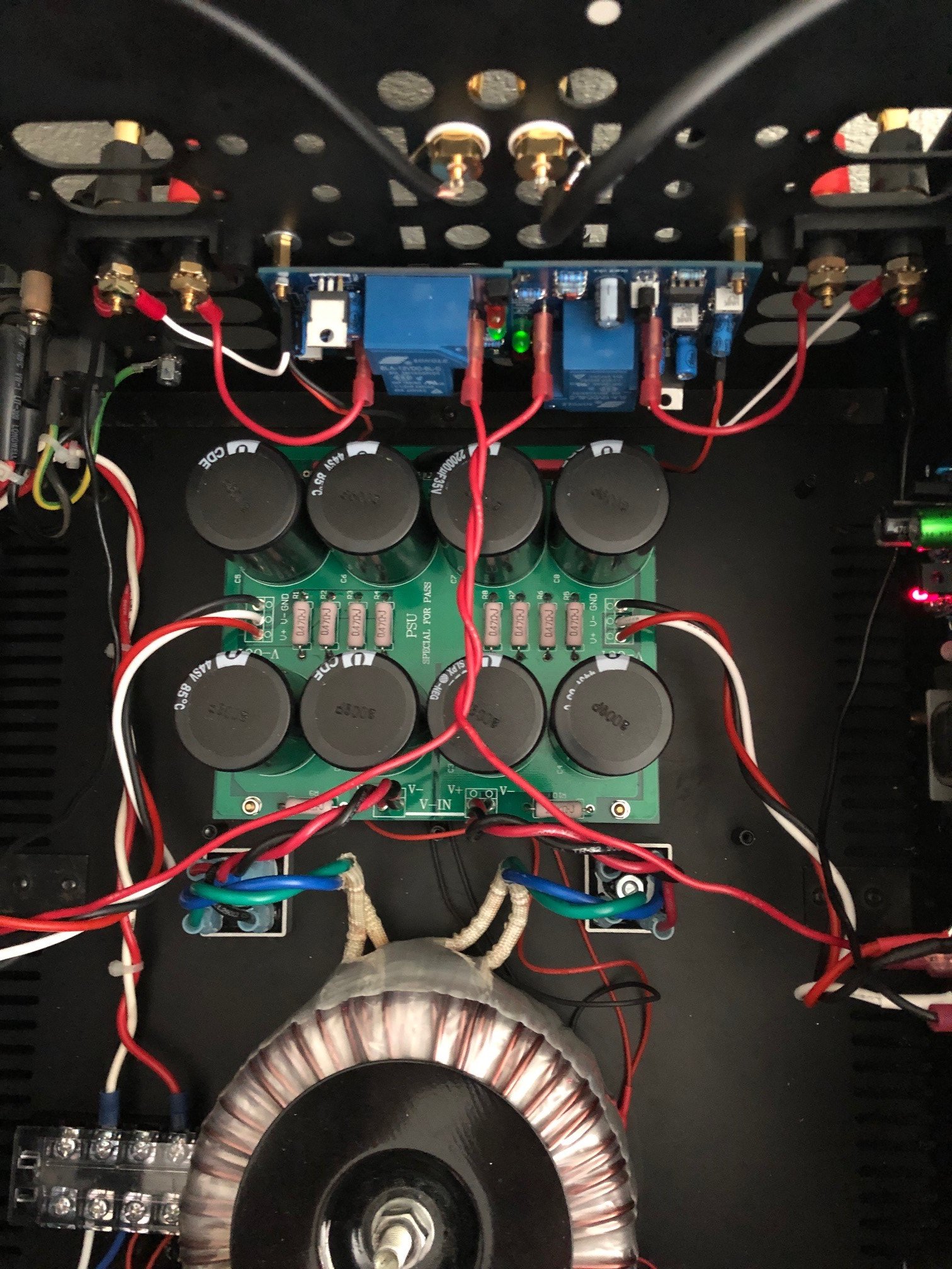

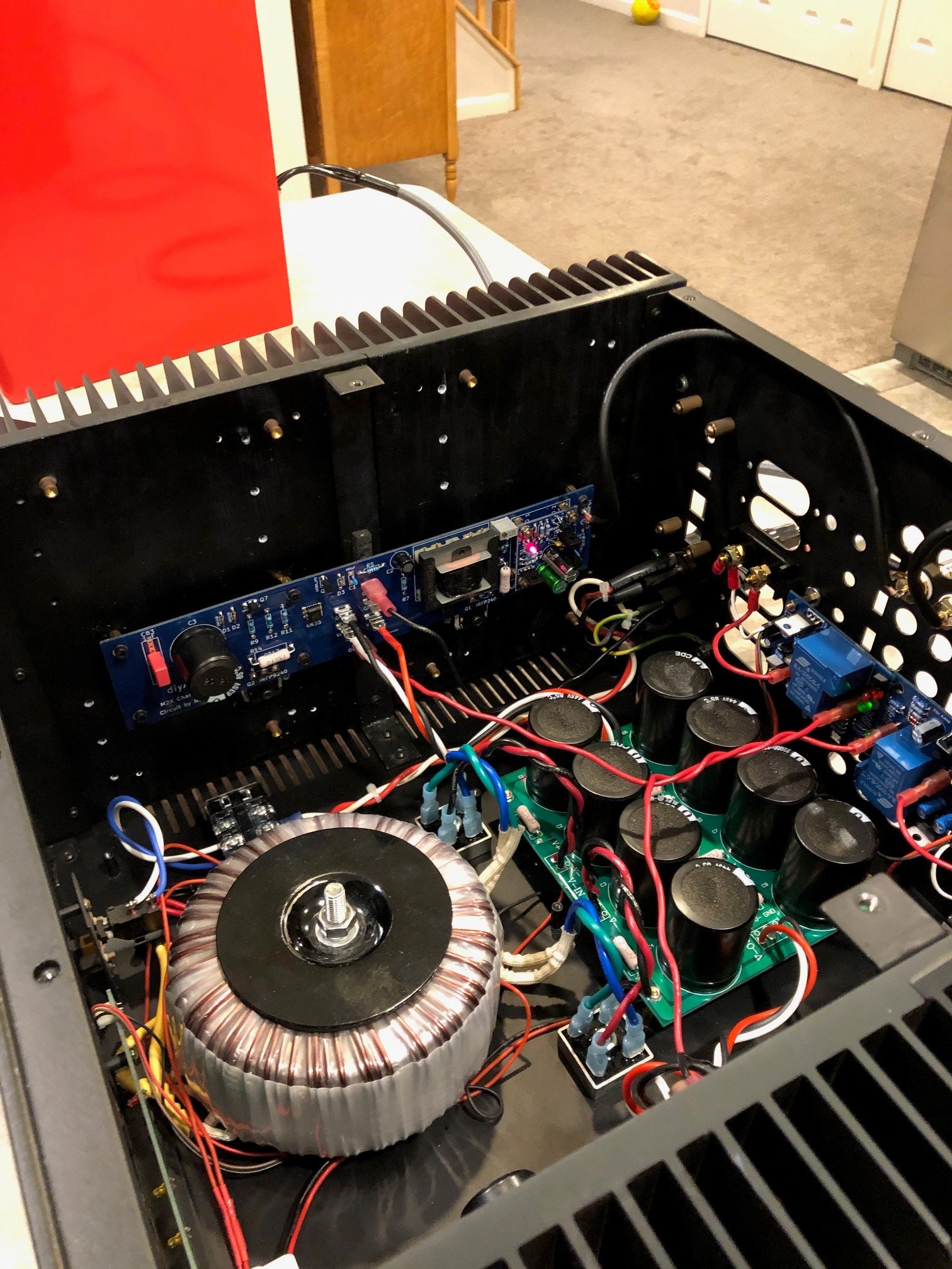

My new build is going well. I didn't use the work-around to get more flexibility setting DC offset. Both channels are stable; but one can only be tweaked to +0.12v. Sometimes, it will dip to +011v. The other can be zeroed in, no problem.
Would you live with +0.12v?
I'm not sure if this is odd or not, but I couldn't find 37k resistors. I ordered a pair of 37.4K. Since it's going through a POT, I assume this is fine - no?
Does anyone think I may harm my speakers with the +0.12v offset? I don't want to stop listening, but I will if there's concern.

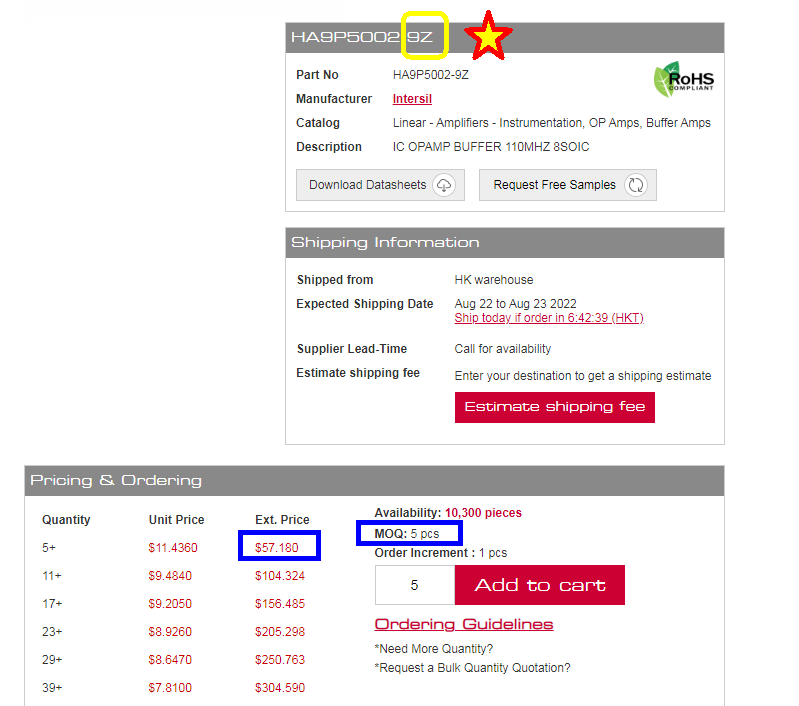

---well, small problem, apparently the Renesas HA9P5002-5Z is out of stock everywhere, unless I want to buy 960 units from Avnet and they have no ship date. Is there a good substitute that you guys know of, or am I going to be enjoying Ishikawa for over a year to get parts for Norwood?
I loved the Ishy too, I have a tinnitus thing and with my chain, I perceived it more sibilant than with other options. Before you change you need to give the Ishy a chance, it was my fav until I tried other options. I also need to put it back in since I have changed my chain. One thing I have figured over the years it that there is no one best, either for the chain, or for the music played.... it's all up there, and it's up to each of us to find our own key. Hint: Sometimes that's just a mood or mood modified, so check what others have said, but listen for yourself; Too many people put stock in what others have said, but they don't have your two ears and brain.... Find your own bliss.
JT
The HA9P5002-9Z is the same chip but spec'd for an even wider range of operating temperatures. Octopart.com tells me it is in stock at Win Source. I check their site and, yes indeed, it is in stock. Minimum Order Quantity is 5 pieces so perhaps Norwood builders may want to arrange themselves a little Group Buy or a pooling of resources.

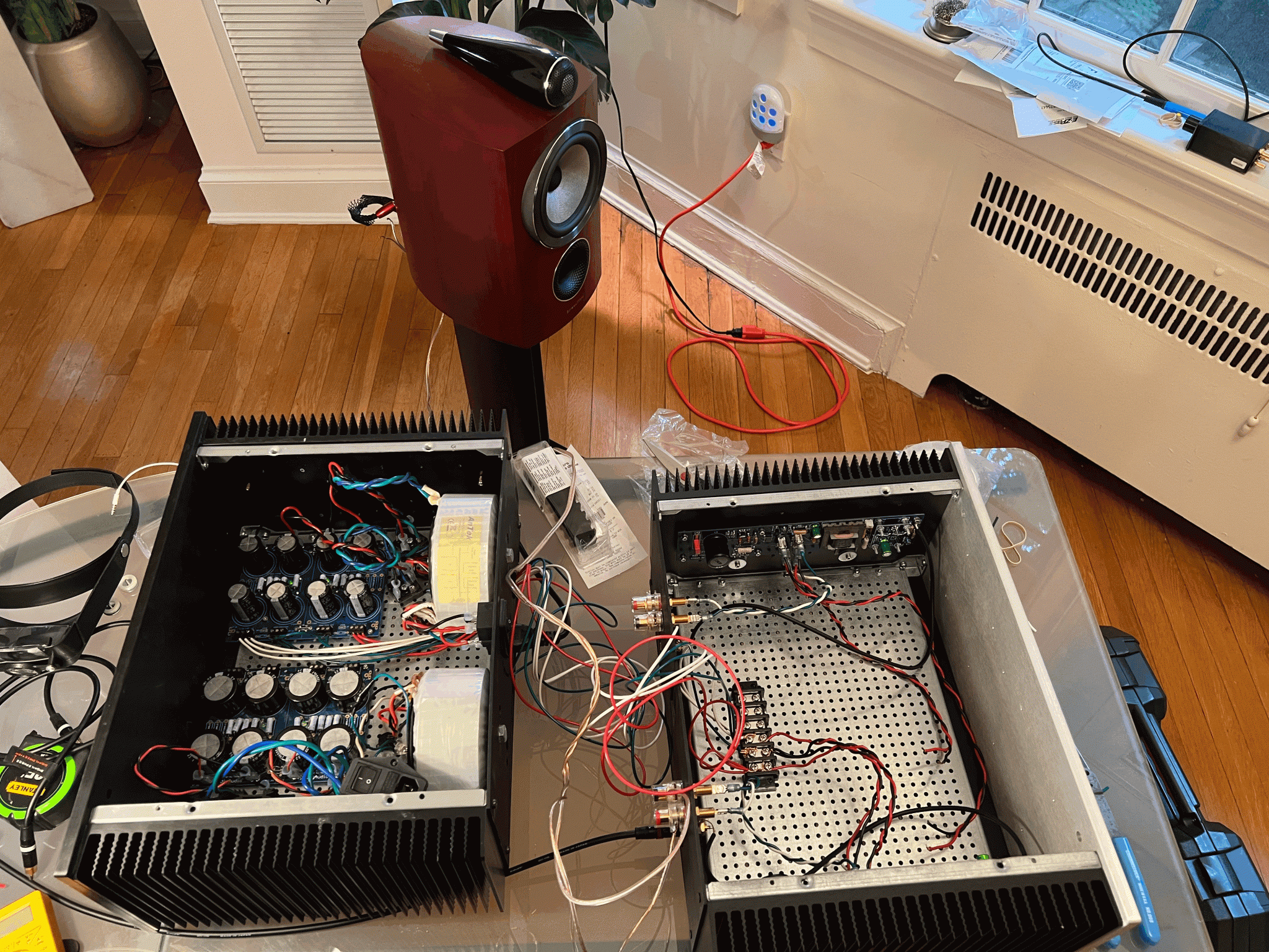

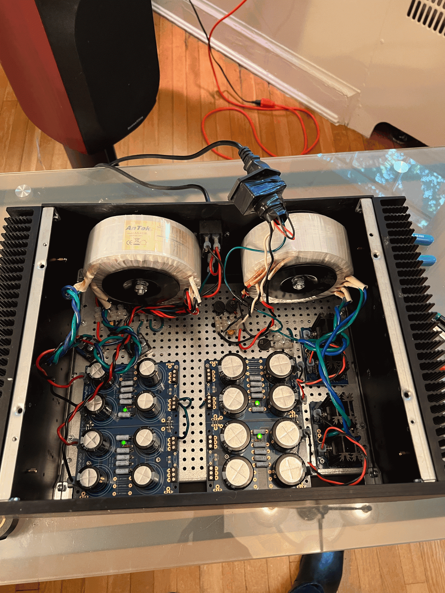

I know the wiring looks out of control... I only had 16awg stranded laying around - so I ran 3 lengths for each power connection.
I've been listening to the dual-mono setup for about an hour now, and I'm surprised how much of a difference it made to an already fantastic amp. I'm looking forward to finding connectors and cabling to do this correctly. If anyone would like to share their experience doing so, that would be great; though I have seen a lot of posts while searching.
I'd especially like a recommendation for a good PS case. It seems a waste to use a 4U that could easily become a working amp.
