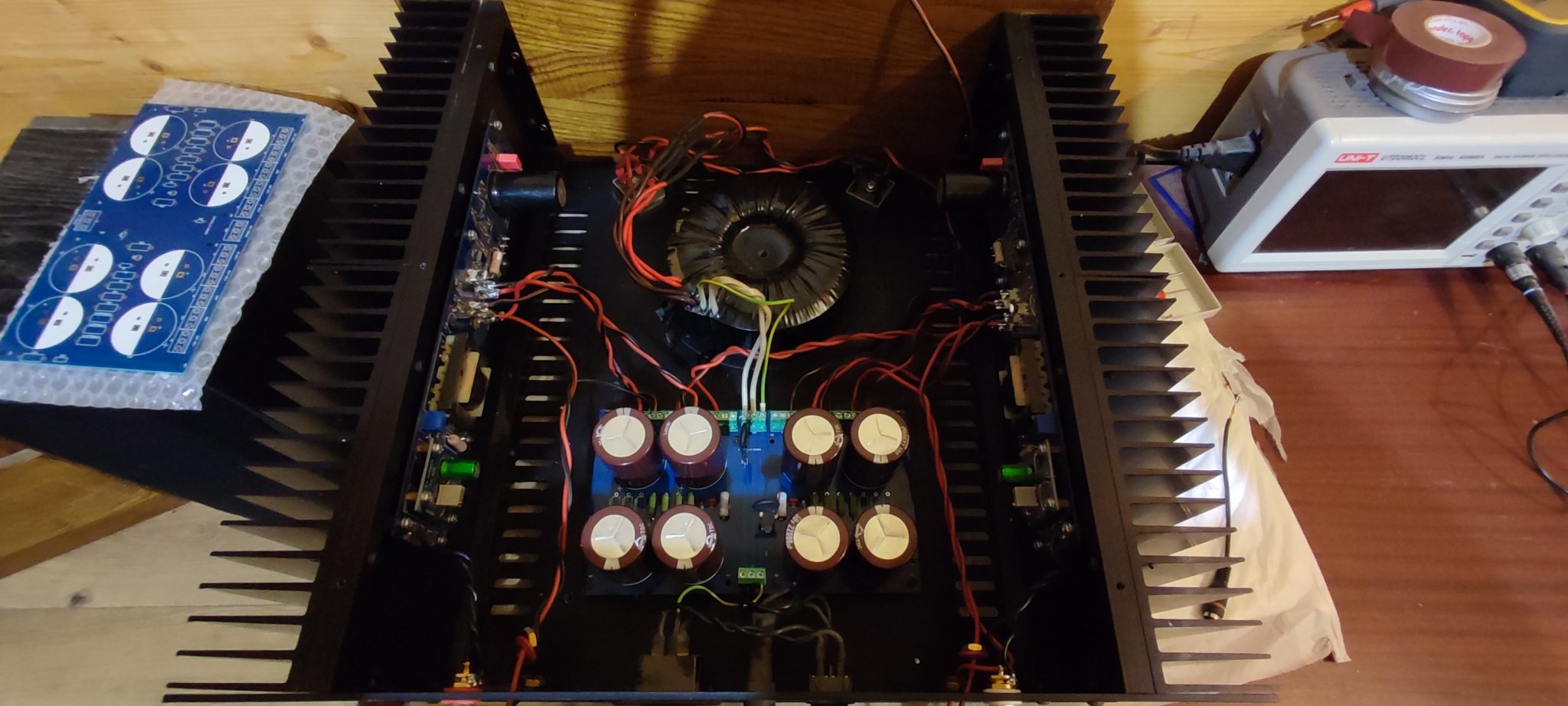

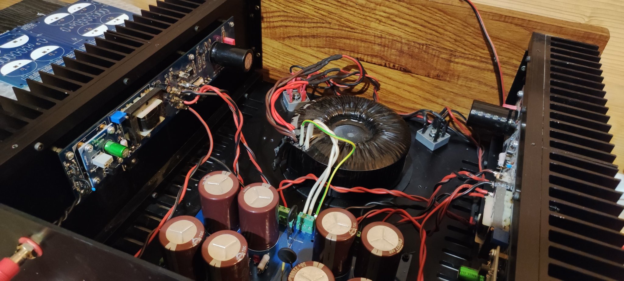

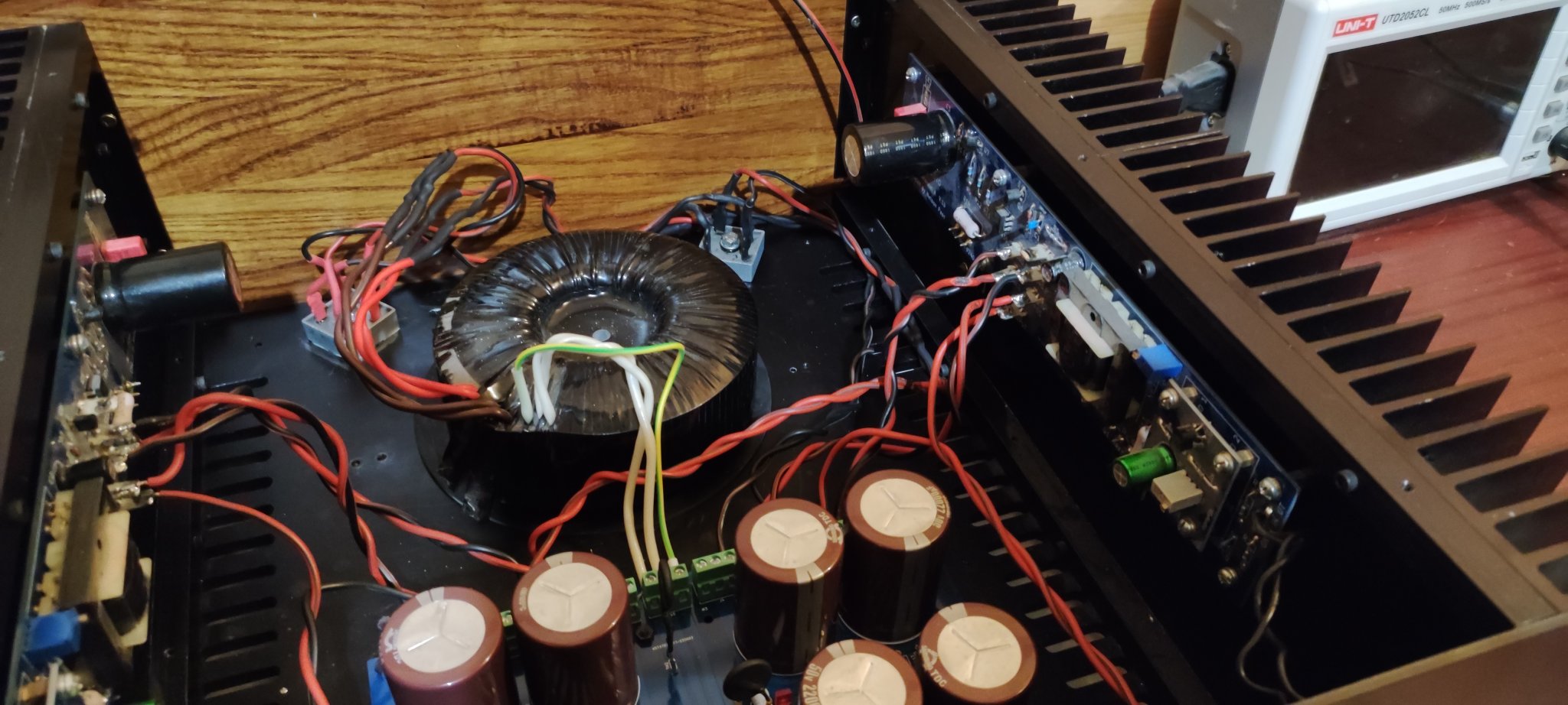

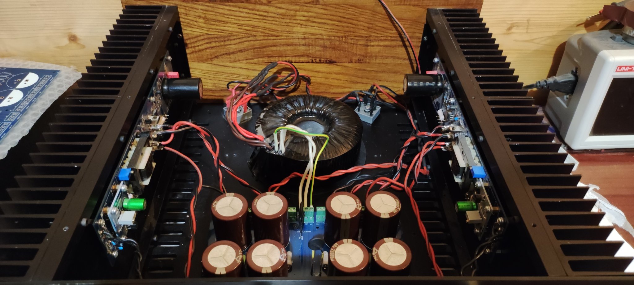

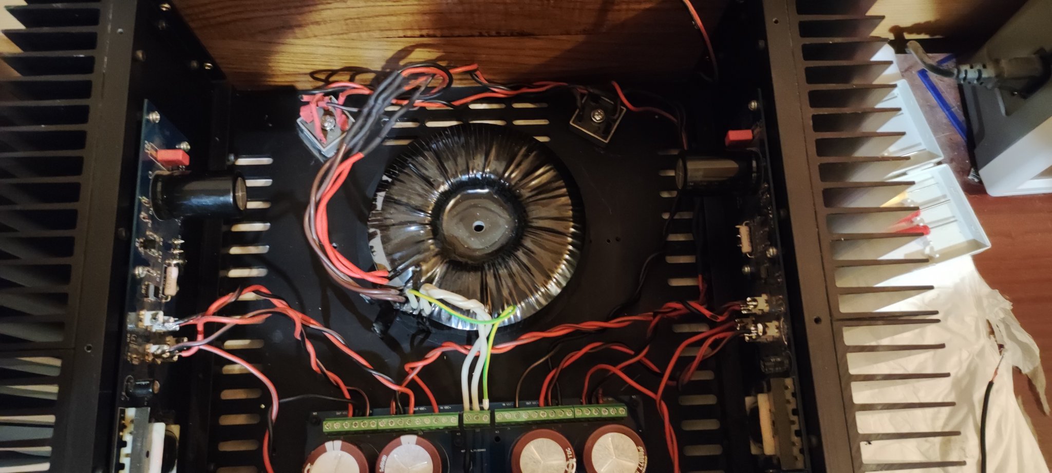

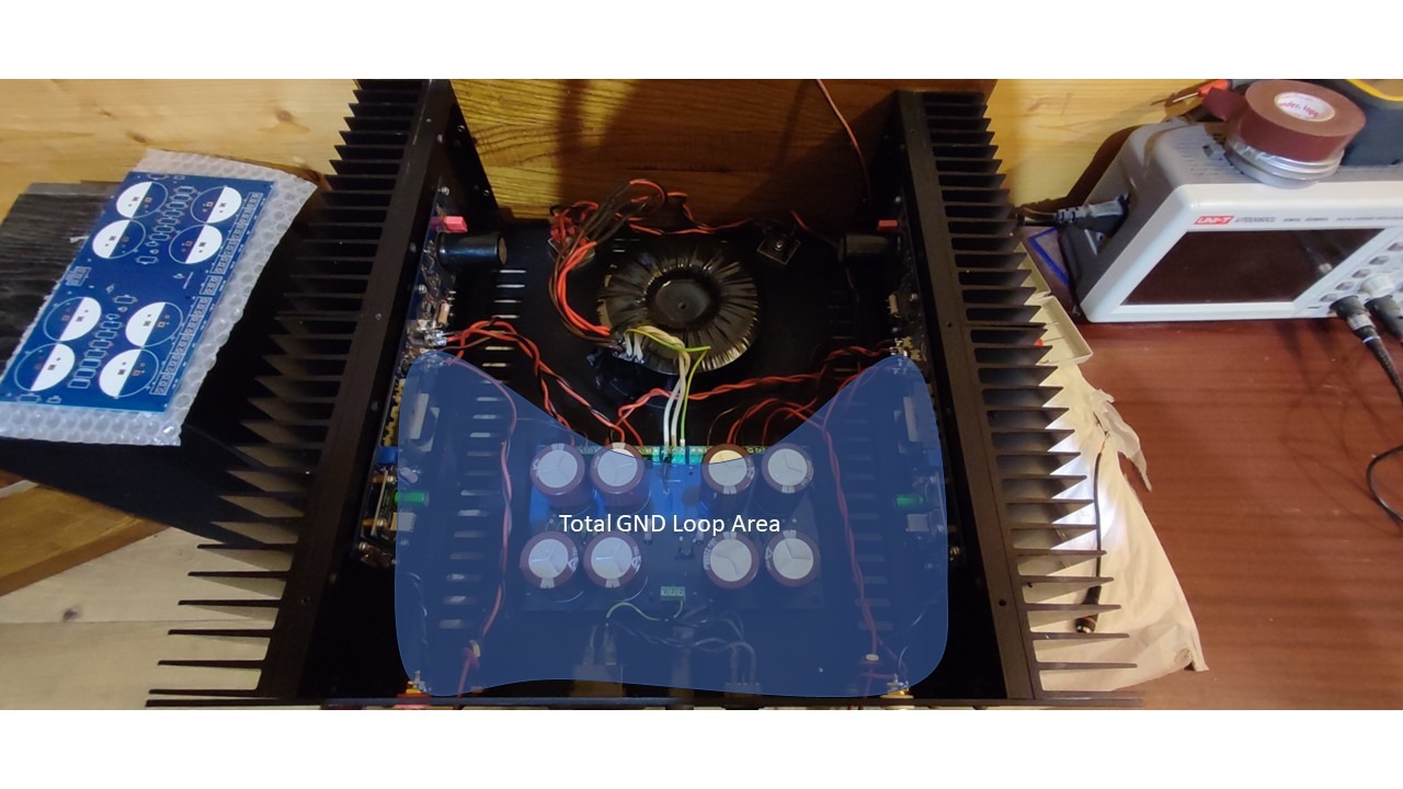

I'm almost done with my M2 build with one slight problem. When connecting a phone or Chromecast Audio to inputs I get a lot of hum, whereas when nothing is connected to inputs, M2 remain silent, no hum at all. Is this related to cross channel ground loop ? How to solve it ? I've already tried different wiring paths with no effect.

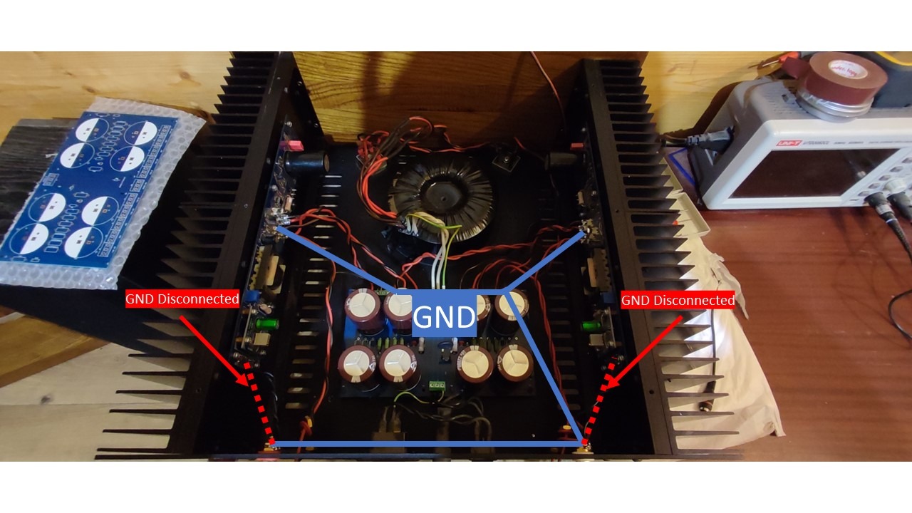

So, I managed to find solution to my cross connection ground loop. I've disconnected input GND signals from ampboards. Then, connected both input grounds together and connected them to star GND on my PSU board. I do not know if it is a correct aproach but that resolved my hum problems.
I'm trying to sort this out in my head.connected both input grounds together and connected them to star GND on my PSU board
As it stands now, the source device output grounds are now connected to your PSU ground.
Having them together probably isn't doing anything different 'looking back' at the source, as they likely are connected together there anyway.
However, now I don't see how your L,R channel boards will have a proper reference for the incoming signal. Perhaps it doesn't really matter, as the signal is all AC and any DC difference should be filtered out.

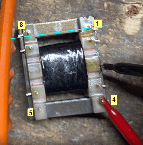

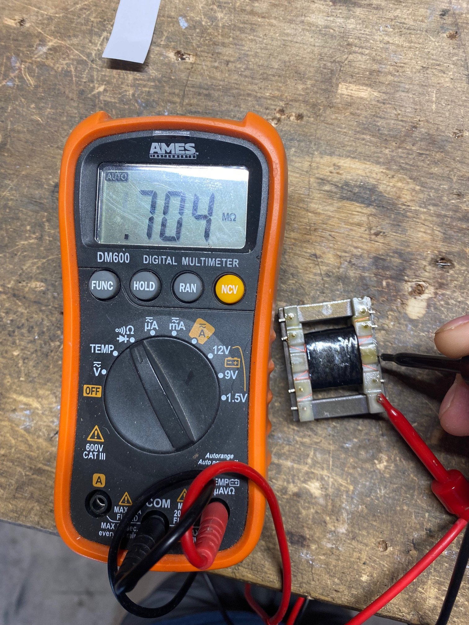

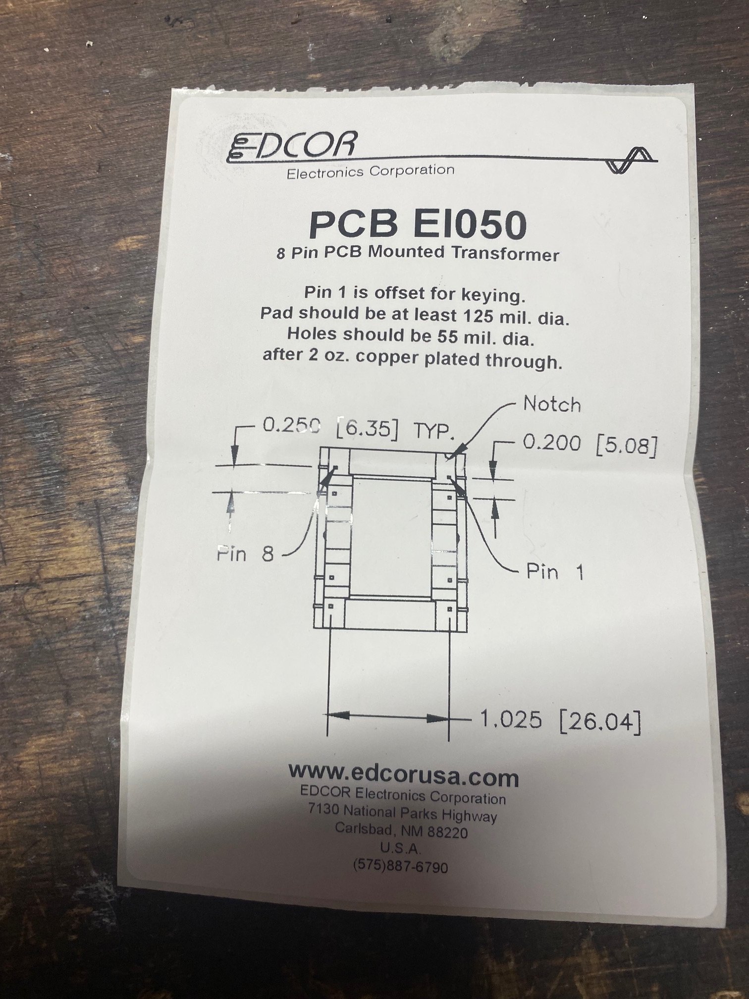

quick question about the Edcor transformers. I just received a pair in the mail and put some copper EMI tape around the transformer. After taping them both I checked continuity of each pin on the transformer and realized pin #8 (does appear to be used) shows resistance between the body of the transformer. I checked all wires of the transfomer and confirmed none of them are touching the emi copper tape.
I removed the tape to confirm it was not causing the problem and still showed pin #8 has some connection to the body of it. Should this be a concern or just move on? I checked and the other transformer does not have the same continuity.

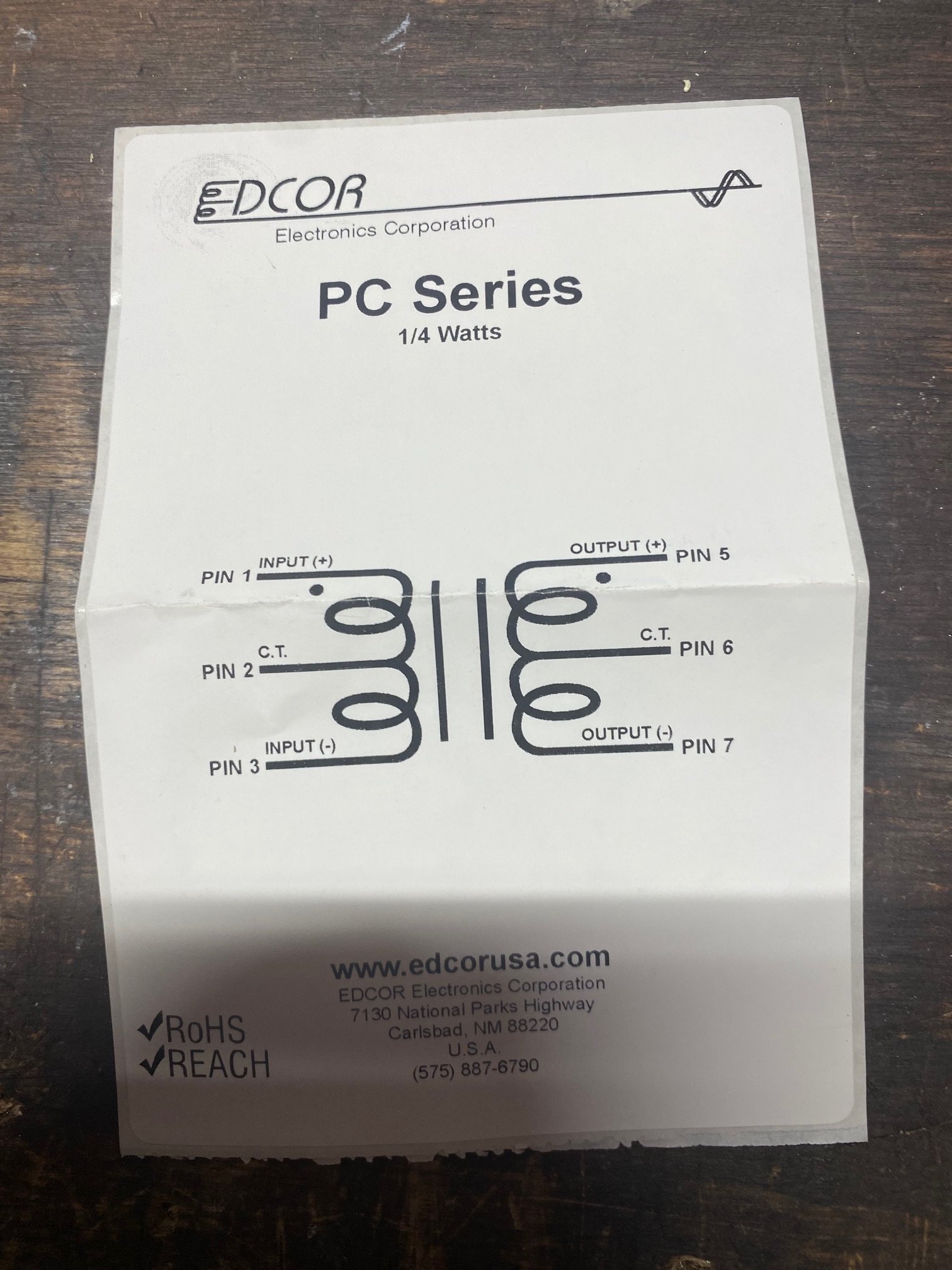

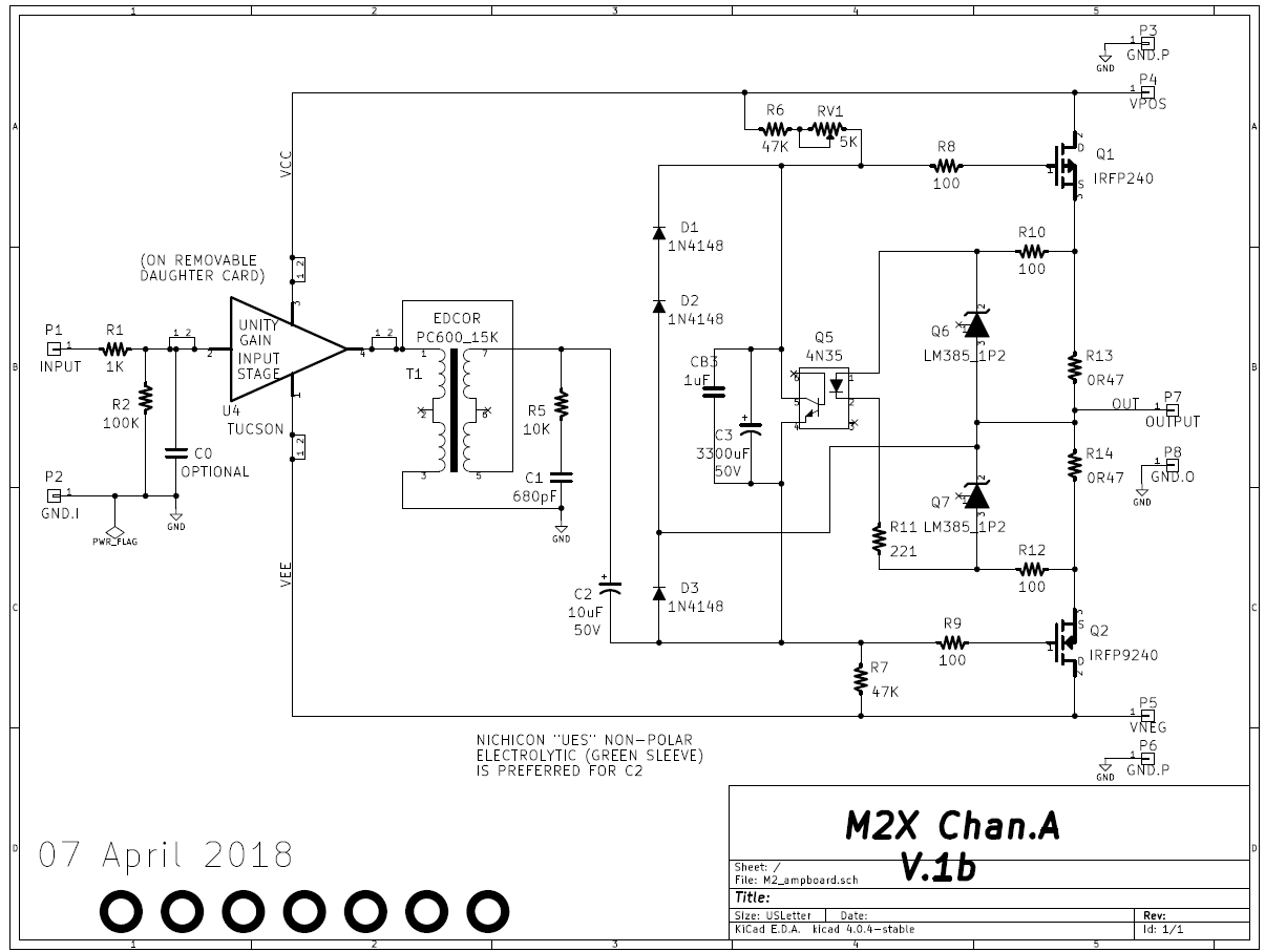

Looking at the m2x schematic and the schematic of the transformer, Pin 8 does nothing. Can I proceed on?
Edcor pin 1 is offset for keying. In your photograph, copied below, that's at the upper right. Your ohmmeter probes are connected to the Edcor metal frame {black probe}, and Edcor pin 4 (not pin 8) {red probe}.
At the moment I happen to have two Edcor PC600-15K transformers in my lab, so I repeated your experiment. I used my ohmmeter to measure (A) the resistance from Edcor metal frame to Edcor pin 4 ; (B) the resistance from metal frame to pin 8; (C) the resistance of a 1/4 watt, 1% tolerance, 1 Megohm resistor. I did these 3 measurements on both transformers. In all cases the 1 Meg resistor measured 1.007 megohms, and the Edcor metal frame to pins 4 and 8 measured Off Scale (>20 megohms).
Thus: my results didn't match yours. I found open-circuit from the not-connected pins, to the Edcor metal frame.
Perhaps you'll be comforted by this little tidbit: pins 4 and 8 are not connected to ANYTHING on the M2X PCBs. You can verify or refute this claim yourself, experimentally. Just buzz out each of the M2x amp channel PCBs with your continuity tester. You'll discover that neither Edcor pin 4 nor Edcor pin 8, are connected to any other signal nets or power nets on the M2x PCBs. They are floating, Not Connected. They affect nothing, and nothing affects them.

yes. thank you, Mark, for the correction. Pin 4 is the one I was testing. One transformer shows open between pin #4 and the metal body. The other shows a rising continuity. I will just mark the transformer and see how it performs in the circuit. I do see neither pin 4 nor 8 are used in the m2x schematic which should allow me to move forward with the build! Thanks!!
Hi, I am not sure if this is the correct place to start a question but I'm currently working on the M2 amp. My input stage and main amps behave in an unexpected way. I give it 25V and set the power supply's limiting current to 0.1A. At first, the current is stable but after 30 seconds the current begins to spike and in order to compensate for the spiking current the voltage drops, can someone explain why? Should I be concerned?
when current is stable:
When current spikes:
Have a quick look at post #3355 of the Official M2 thread. Each of the amplifier channel boards ramps up its current sloooooooowly, as (R6 and R7) charges capacitor C3. The asymptotic final value after hundreds of seconds, is Vfwd_Q5_LED / (R13 series R14) which is around 1.3 amperes per channel for the push pull MOSFETs. Then add the worst case (biggest possible) Input Stage supply current. One point three something amperes per channel.
