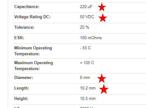

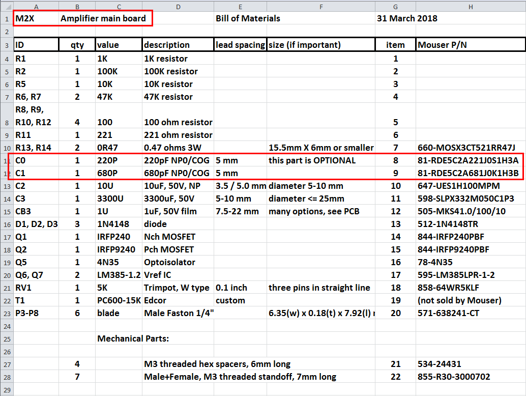

Norwood's "C6" has four critical parameters that you need to match exactly, to ensure (a) it fits properly on the PCB, and also (b) it functions correctly in the circuit. I've marked those four parameters on the sales page of the Panasonic capacitor (Mouser part number 667-EEE-FT1H221AP ) from the Norwood BOM.

Mark,
Thank you for pointing the significant parameters. Quick search with those on both Mouser and Digikey comes up empty, will keep digging though.

The 'mini' 8mm diameter for the Panasonics and rough equivalents seems to be OOS in most of my usual places. I can't seem to find my spares, or I'd happily send you some. I have 8 'somewhere'. :rofl: If they turn up, I'll PM you. Good excuse to organize my SMD parts.
I checked the pad dimensions and space around the part, but I came up empty when trying to look for something else (in stock) that might fit from other manufacturers. Others may have better skills, or perhaps can find some in their spares bins.
Last, but not least... TTI seems to have plenty of stock (>100k parts). Their MOQ is 500 for a standard order though. There is a special note to call them for the cut-tape MOQ of 10, so maybe you could get lucky. 😀
Patrick
Thank you for looking. I did some more digging last night using Mark's critical values and found something at Digikey that meets that criteria that while out of stock should be restocked in the next 2 months.
https://www.digikey.com/en/products/detail/panasonic-electronic-components/EEE-FT1H221GV/10290480
When I placed my order they showed enough restock to ship in 1 month, today its showing roughly 2 months. Ordered 10 to be on the safe side, so hopefully I'll have some extras to share if needed in the future.

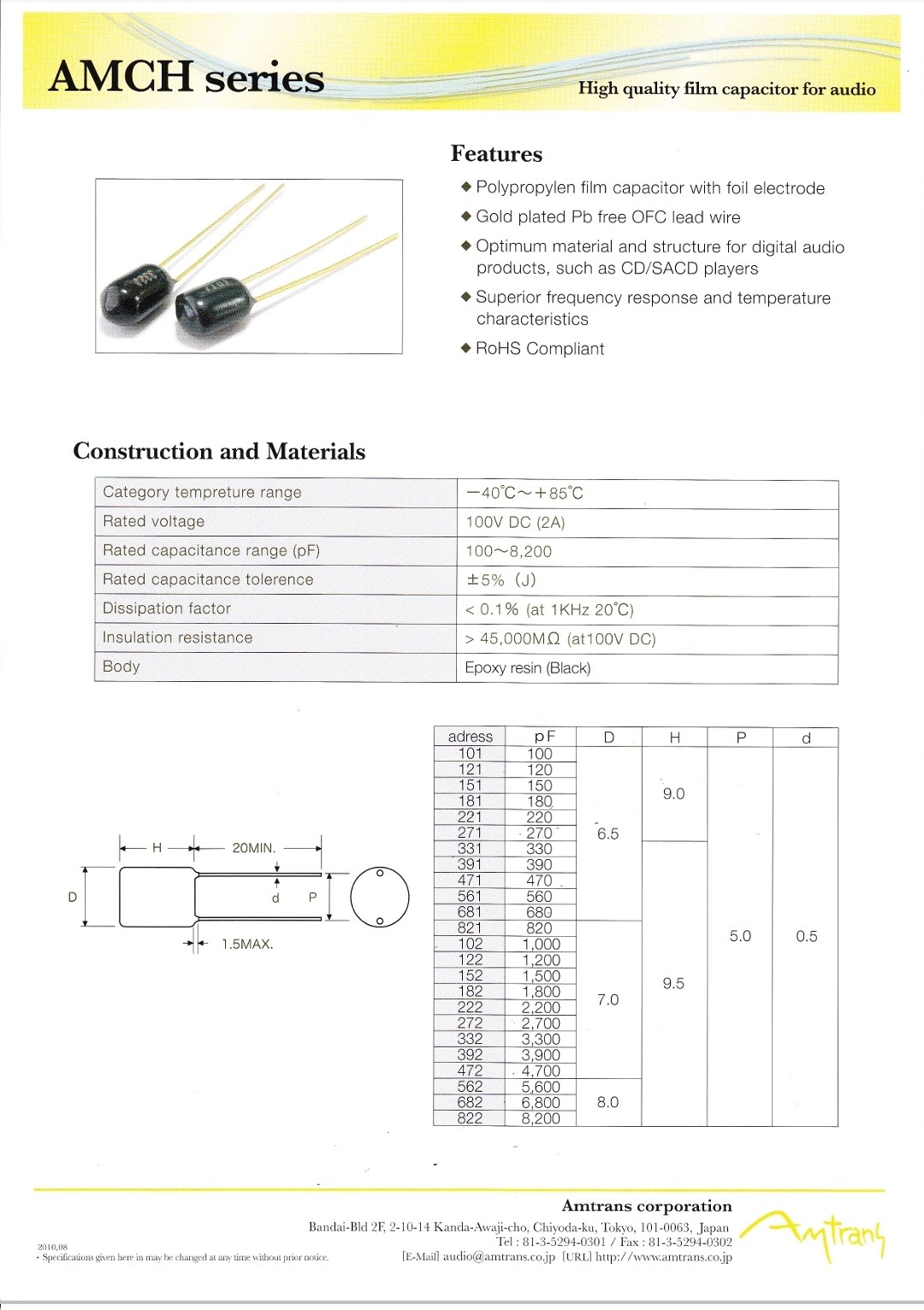

I'm starting to order the parts for an Ishikawa M2 and I'm having trouble finding a reliable seller for the Murata NP0/C0G caps (I live in China and counterfeits are everywhere). However, I've found Amtrans caps for the same values at a shop I trust.
My beginner question is: how important is it that the caps are NP0/C0G and ceramic, and why? What difference would it make if I went for the ones I found? (See attached screenshot of the datasheet)
Thanks for your time 🙂
