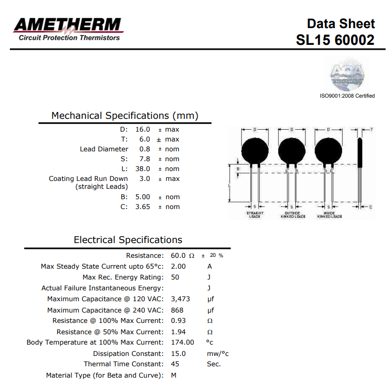

Quick question to the community. Since I use the D-Sub connectors on my daughter cards, it takes me all of 30 seconds to swap them out. I forgot about the thermistor surge protectors and blew a fuse by turning on the amp without letting it cool much.
What is the recommended delay between turning off and turning on the M2x? Thanks in advance.....
Depends on which inrush current limiter part you've installed. For the one I've installed in my M2x (here's more than you'd ever possibly want to know) , I pause for 2 x 45 = 90 seconds during a "hot restart". See datasheet below, 2nd line from the bottom. >89 seconds works well for my M2x and I haven't blown fuses.

Thanks Mark, I'm using CL60 type, I forgot which brand.Depends on which inrush current limiter part you've installed. For the one I've installed in my M2x (here's more than you'd ever possibly want to know) , I pause for 2 x 45 = 90 seconds during a "hot restart". See datasheet below, 2nd line from the bottom. >89 seconds works well for my M2x and I haven't blown fuses.
