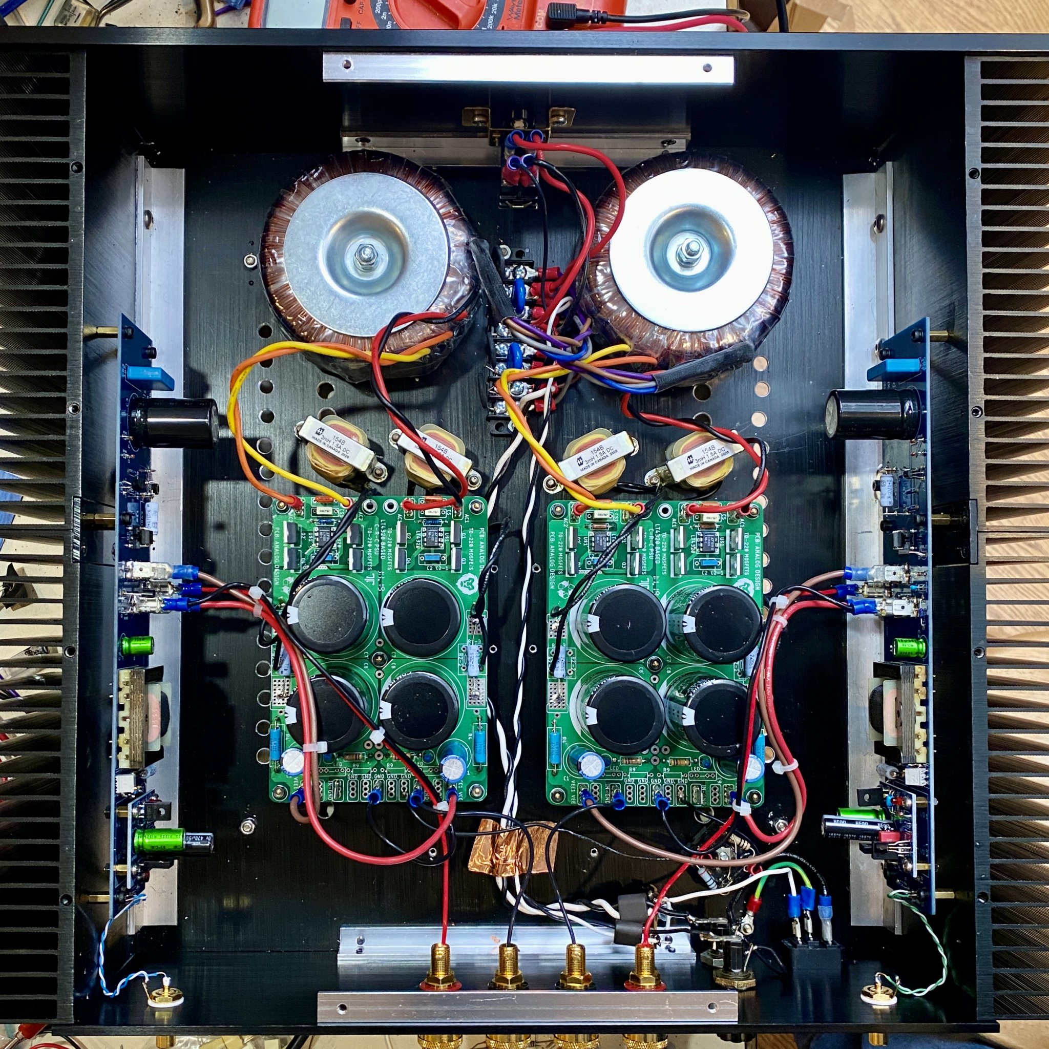

My rebuild of the M2x is currently in progress. I've attached a couple photos to show the prevous configuration and where things currently stand.
The original build used a single 400VA transformer inside a steel case, with the store's 'Universal' PSU board, a set of 22,000 electrolytics and discrete diode bridge rectification. This did have a noticeable amount of 120 Hz hum with my ear close to a speaker, but was not really noticeable when listening to music. I did try several measures to reduce hum and improve stereo separation, with mixed results. Probably the best improvement was replacing the conventional diode bridges with synchronous bridge rectifiers on separate boards (after removing the diode bridge portion of the PCB).

The M2x Revisited
Now I know why our Zen Mod loves this amp so much. The differences between the shared supply and an optimized dual-mono supply are striking. This amp now shares a peer relationship with my Aleph J and F6. My big old Vandersteens disappear completely with the best recordings; no mean feat. The recorded soundscape fills the entire back wall of my listening space, though it stays midway between forward, and laid back. The amount of articulation and detail are surprising, especially with a newer variant of Marauder / Tuscon FE cards. (more later)
I began with the Mtn View cards, which have been one of my favorites in the M2x. These remain smooth and easy to listen to, while benefiting much from the cleaner power. The revised amp still needed about 20 hours of run-in before it really started sounding great, and the single-ended Class A nature of Mtn View helped with that. The newer Marauder variant has a level of detail that is likely to be merciless with un-thoughtfull recordings.
Given the sound of the revised amp, I will maintain that the Edcor transformer leaves nothing to be desired. As ZM has been saying all along, this is a special Haiku of carefully selected components.
The Triad power transformers are performing better than I anticipated, maintaining almost 19V AC under load. This may be helped by a tweak I made to the synchronous rectifiers on the PSU boards. I switched to the IPP040N06N which have a lower total gate charge than what I was using previously. They seem to be more efficient, as I'm loosing less voltage in rectification. I've also switched to a CLC configuration of 33mF, 3.0 mH, 33mF + 2200uF. The chokes are Hammond 154B, which run cool and collected with 1.3A bias current, despite looking small. I took the precaution of bypassing the chokes with 2.2Ω resistors to reduce any back EMF during power up and power down. The result is set of very strong +/– 25V power rails and a silent background for the music.

Tungsten,
You've inspired me to build the dual mono PS for my M2x! I was leaning towards building a standalone PS to deal with my 60 cycle noise. The noise is barely audible at idle, so I haven't been that motivated. But with the sonic benefits you describe you've pushed me over the precipice and I think I'll go completely dual mono in a separate chassis. Appreciate your feedback on your mods! Keep us posted as your impressions continue to form.
