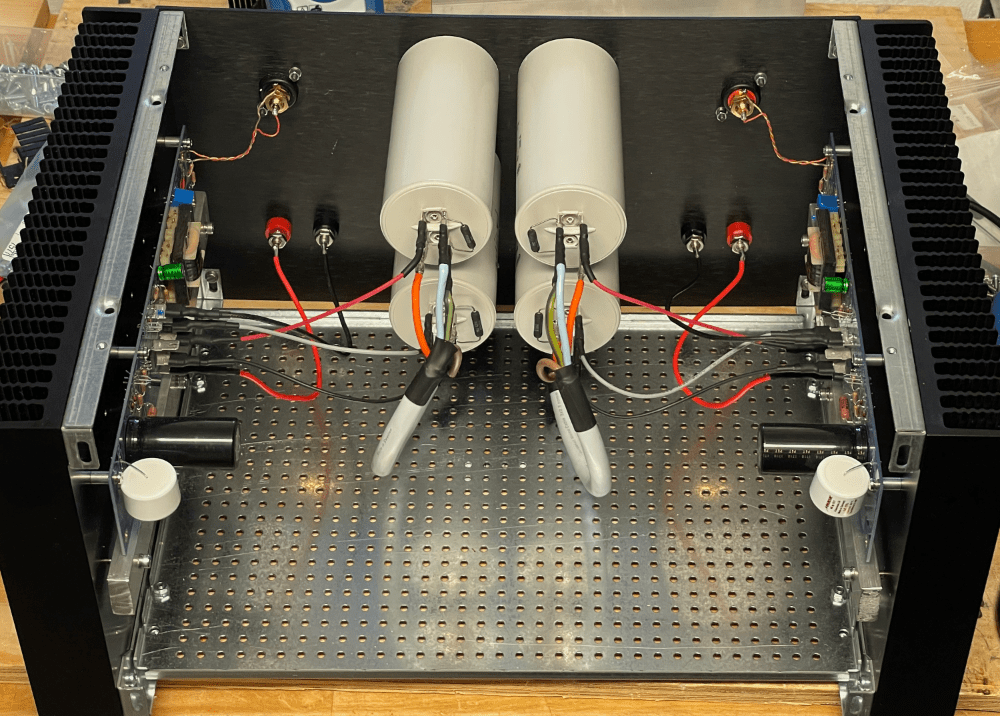

I have the parts for building a new dual-mono PSU in my old M2x. It was the only one of my FW clones that I built with a common PSU shared by both channels. While I tried several things to improve supply decoupling for the individual channels, it never had the same wide and detailed soundstage that my later builds had. Hopefully that will improve once I get around making the changes. After that, it will be time to try a couple new FE cards.
Some forum readers may have noticed that I am a loud proponent of dual-mono power supplies for new DIY builds. My experience with the M2x is why that is.

I'm interested in the dual mono PSU you mention. My current M2x build is the single PSU, single chassis stereo version. I have some background 60hz hum at idle that I have not addressed. Its barely noticeable. Neither my tranny or autoformers are shielded. You've got me thinking about a different layout with the PSU in a separate chassis. If I go that route, I may build dual mono PSUs. A couple questions for you. Do you house the dual mono PSUs in the same chassis? Or is your layout a monoblock, with each channel and PSU in a separate chassis? Any feedback on either style? Also, do you use a separate tranny for each mono PSU, if they share a chassis? I appreciate your inputs!

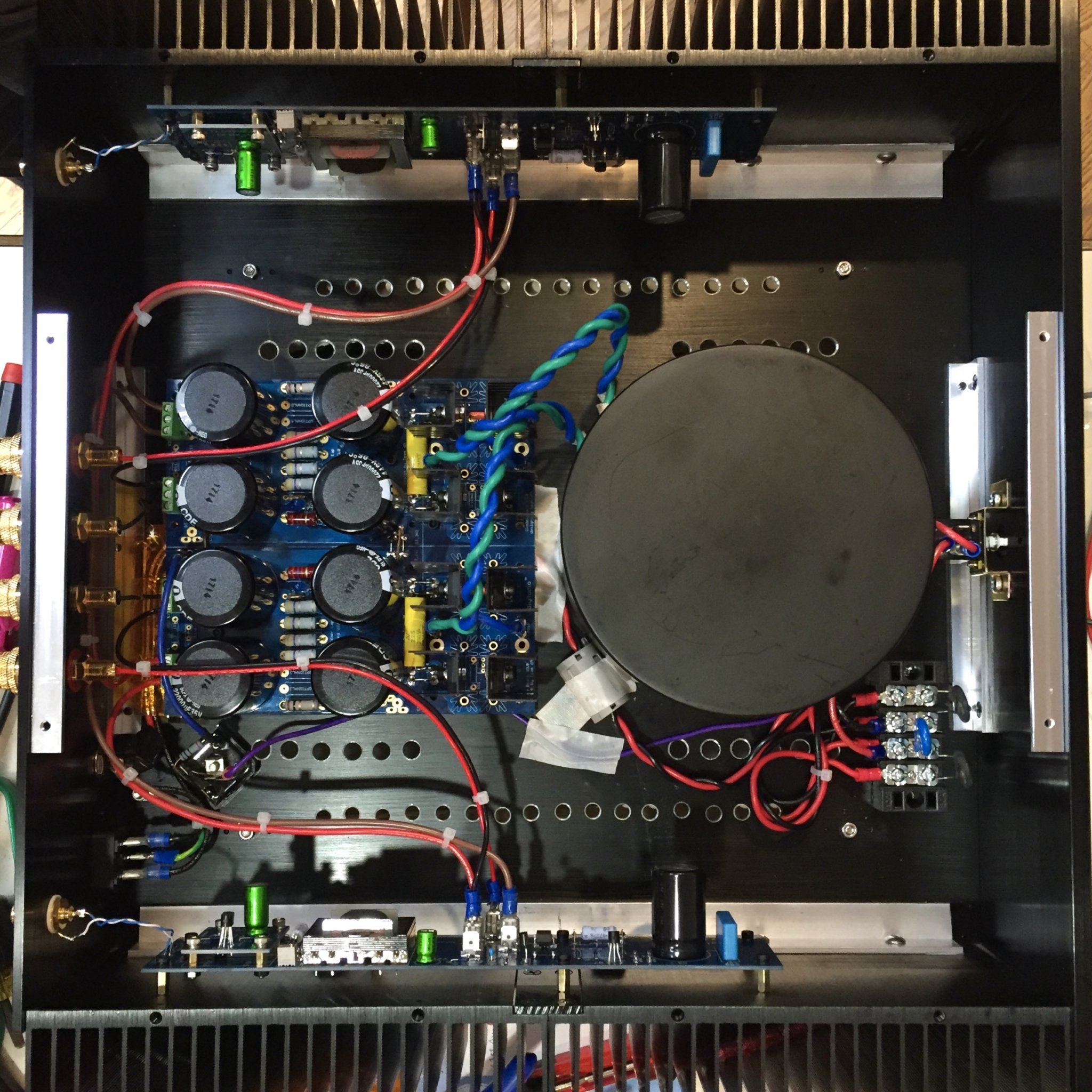

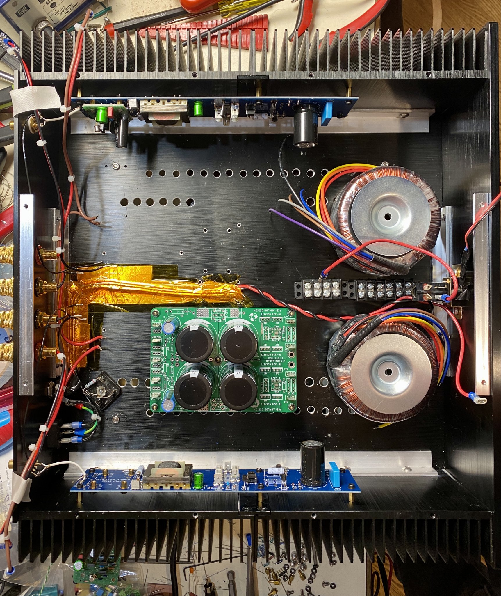

My rebuild of the M2x is currently in progress. I've attached a couple photos to show the prevous configuration and where things currently stand.
The original build used a single 400VA transformer inside a steel case, with the store's 'Universal' PSU board, a set of 22,000 electrolytics and discrete diode bridge rectification. This did have a noticeable amount of 120 Hz hum with my ear close to a speaker, but was not really noticeable when listening to music. I did try several measures to reduce hum and improve stereo separation, with mixed results. Probably the best improvement was replacing the conventional diode bridges with synchronous bridge rectifiers on separate boards (after removing the diode bridge portion of the PCB).
The new configuration will use a pair of Triad Magnetics 160VA VPT36-4440 transformers and two custom PSU boards that incorporate synchronous rectifiers and other features that I requested. The new PSU boards have a set of 33,000 uF electrolytics supplemented with 2200 uF on the output and 2.2uF film caps after the rectifiers. The component placement study in the second photo shows there is more room to move things around. I'm hoping that the smaller power transformers produce less magnetic interference. The initial listening tests will determine if more work is needed to reduce hum.
Note that the channel boards are placed toward the rear of the amp, in an attempt to reduce magnetic interference between the power transformers and the Edcor signal transformers. This chassis is 2.5U high (105mm internal) by 400mm deep, 365mm wide. Overall, I find it somewhat simpler to build a dual-mono supply in the same chassis as the rest of the amp. This approach worked well for my Aleph J and F6 builds. It is now time for the M2x to be brought up to date. When it came to build a linear PSU for my VFET lottery amp, an external chassis was necessary, as well as an umbilical power cord between the two. That also worked very well, as my VFET amp is completely silent when no music is playing.
The new chassis being introduced by Modushop will be worth considering if you want to try separate mono chassis. Otherwise, the closest single chassis would be the Dissipante 3U, 400mm deep.
