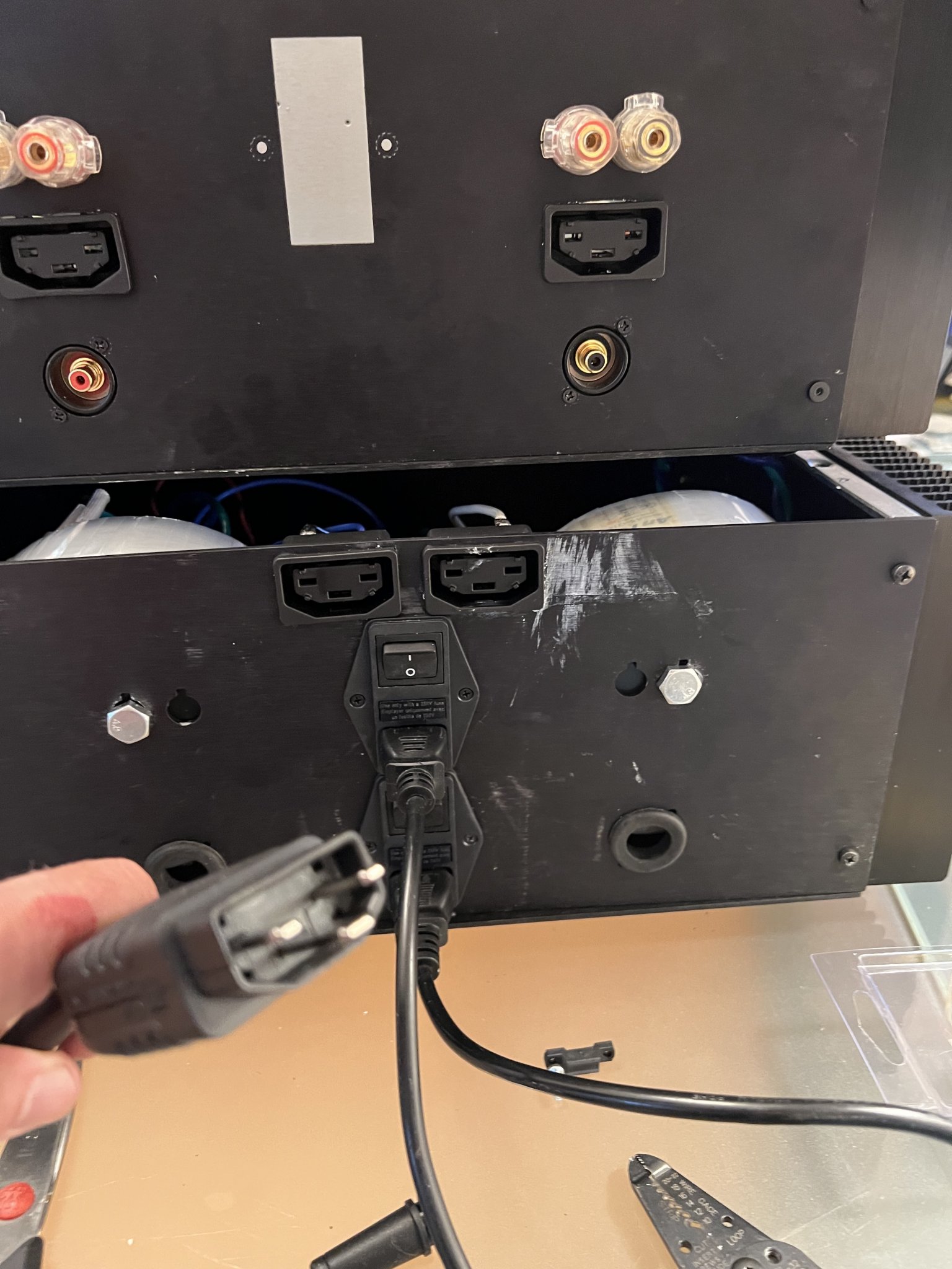

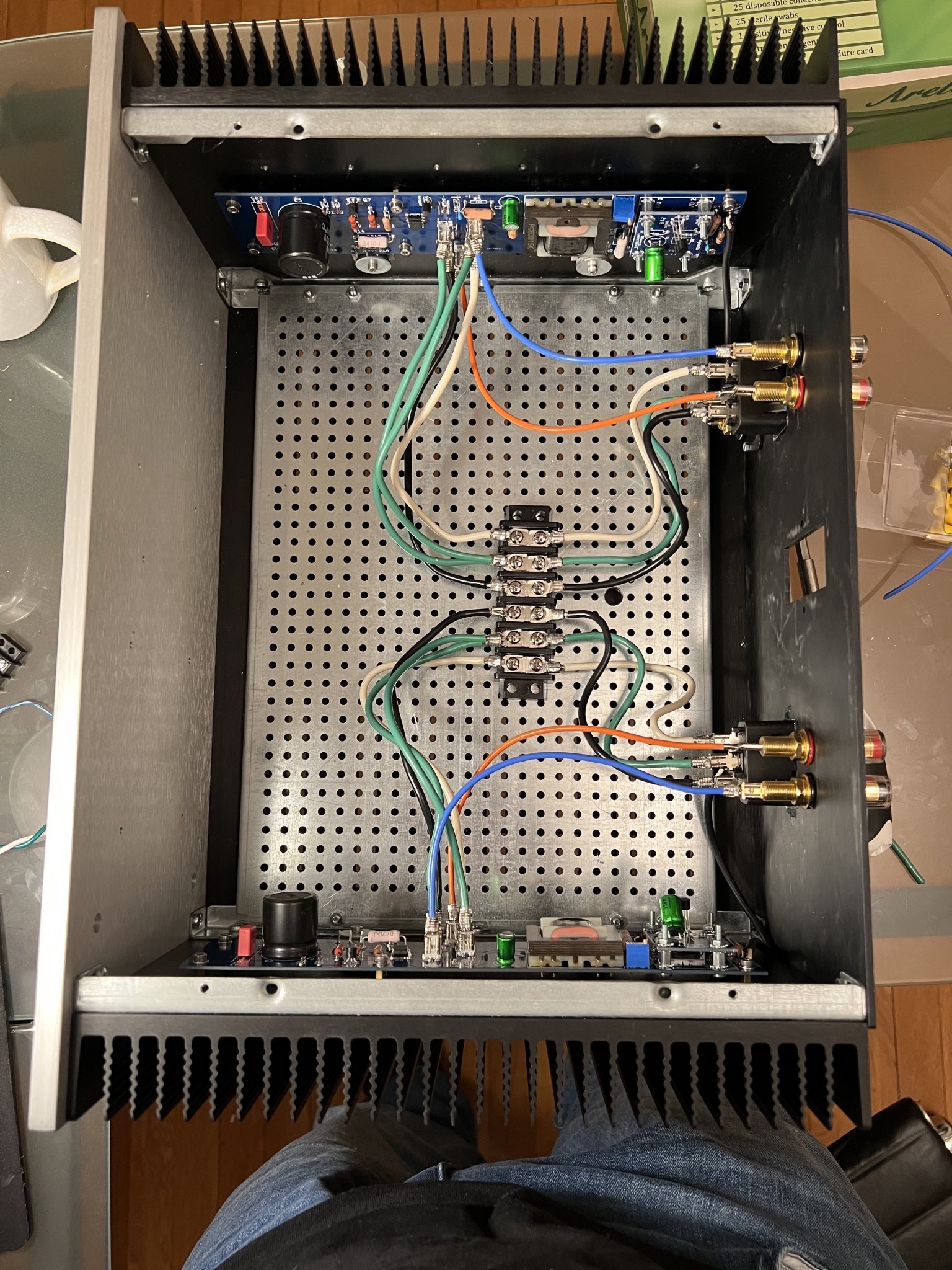

My external power is complete, proving my metalworking skills aren't improving with time 🙂 The IEC/DC parts worked well.
I'm measuring a 0.3V difference in rail voltage between sides (+/- 23.2 vs +/- 23.5). Is that unusual? I've never run dual-mono before; so I have nothing to compare with.
It sounds fantastic. M2x is my all-time favorite. I'm looking forward to trying the other input buffers!
Good job on the top view photo. Very often those include the photographer's shoes or bare feet.
@Mark Johnson my composition could definitely have been better! @sov Thank you. I'll read about that.

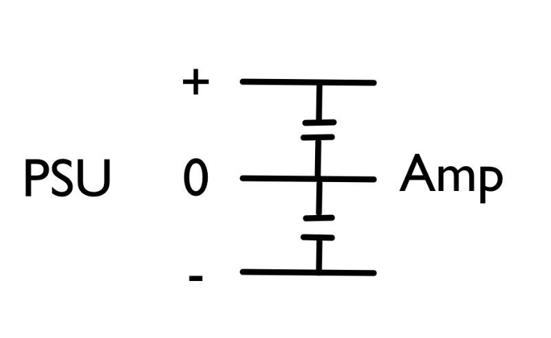

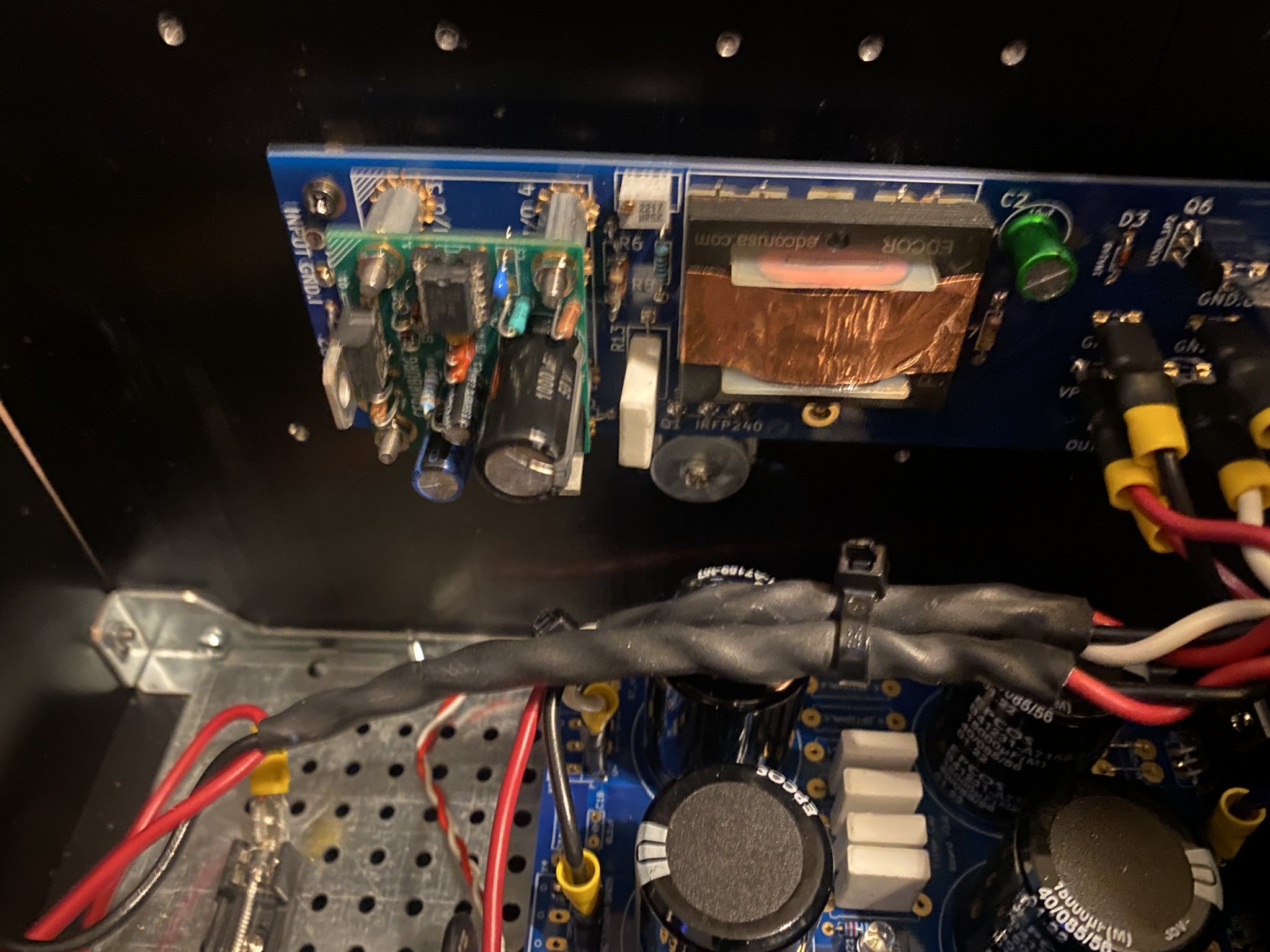

SOV: Interested to know how those caps are wired in, and what the make/model/part number these are. Thanks!@ppinto1 Once I got the advice from Mighty Z to include motor runs in amp chassi. Now I include them where ever the power goes.
Thanks for that info!Ducati motor run or other motor run 60-100uF with a bleeder 1kR.
what's wrong with having 33mF per rail too?
motor runs are cherry on top, but without local 33mF there is no top
Why not get really extravagant and make that 100mF per rail? Just how many joules are required (per rail) for this 25w/8R amplifier and how much Power Supply Ripple will be acceptable?
Do you mean 33mF local in the amp chassis, additionally to the cap bank (with 33-47 mF) in the PSU?![]()
And the bleeder resistor in the PSU only?
