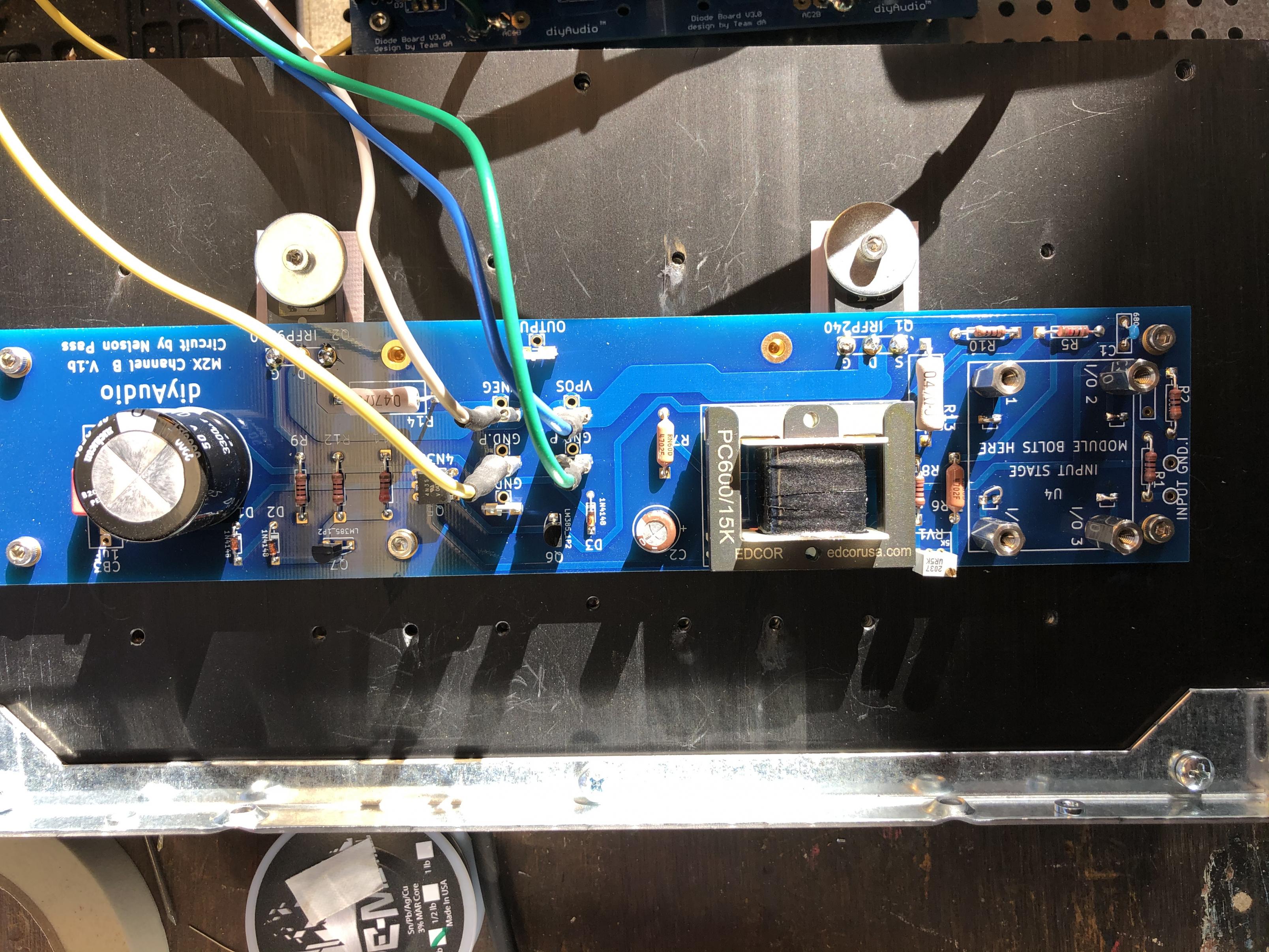

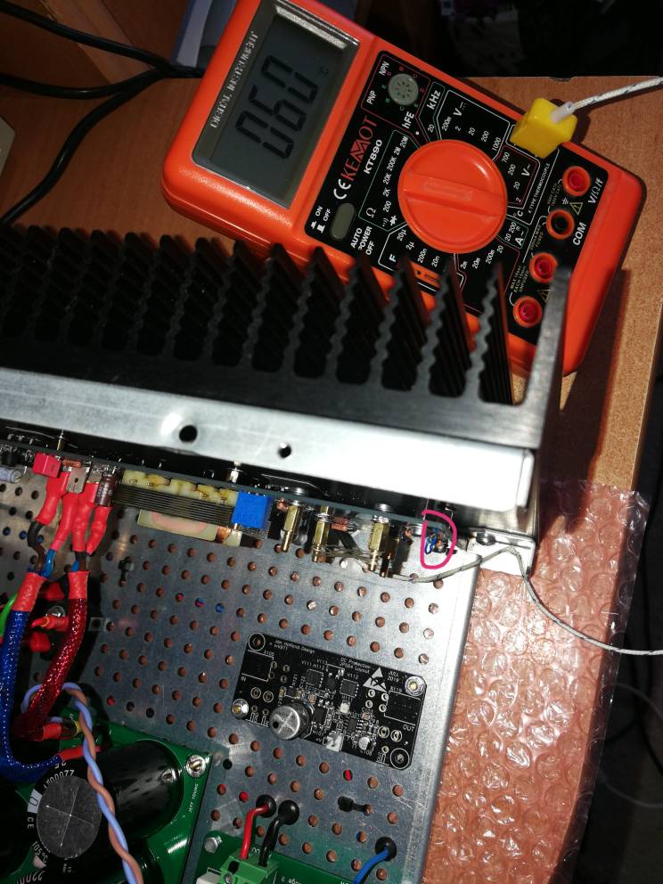

I hooked up one amp board without IPS and put my DMM contacts on v+ and P.gnd and switched on. Voltage started at about 26v and dropped steadily, reaching 24v in about 10 seconds. About then my transformer developed an audible buzz (rather that a hum) and I noticed a faint trail of smoke that appeared to come from the Edcor. I switched it off at that point.
10 secs to reach steady state sounds too fast. 😱
V was still dropping when I switched it off. The smoke from the Edcor was my priority at that point. What’s a good time to steady state as I work on this issue? Thanks.
@jfuquayIf you do all three of these actions before powering up an M2x amp channel card
- completely remove the input stage daughter card
- short the IPS daughter card input (bolt #2) to the IPS daughter card output (bolt #4) with many figure-eight wraps of copper wire
- insert a shorting plug into the RCA input jack, which connects INPUTSIGNAL to GROUND
then you won't force destructive amounts of DC into the Edcor transformer's primary coils.
I strongly recommend that you use your DVM, in "continuity tester" mode, to become absolutely convinced that you've correctly identified bolt 2 and bolt 4. Studying the schematic of the amp card (mother board) below, you can see that only one of the four bolts has electrical continuity to capacitor C0. Eureka and congratulations, you have found bolt #2! Now devise a similar plan to identify bolt #4.

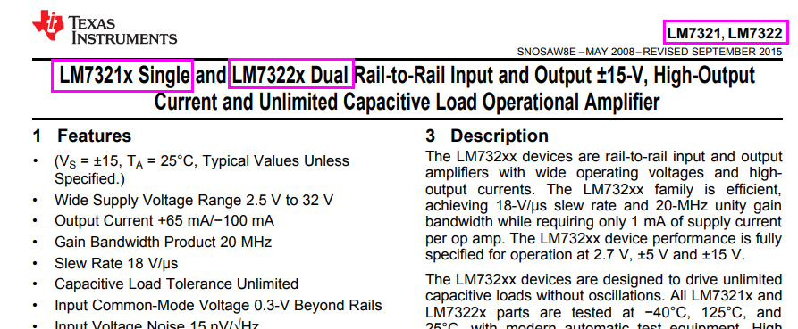

It appears that the LM7321 is a single and will fit nicely on the IPS7?
Cultivate the practice of always downloading and reading the datasheet. Here is what you type: LINK
The top 1/3rd of page 1 of the datasheet is shown below. It tells you that
if you want to plug into the "SINGLE" socket of IPS7, you should buy ___________(part number here)____________________
if you want to plug into the "DUAL" socket of IPS7, you should buy ___________(part number here)____________________
