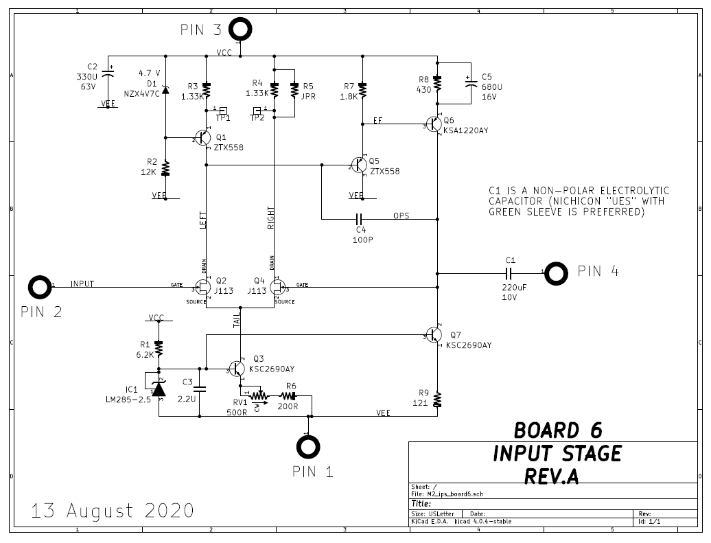

I have not built the Norwood although the concept of using a high current low output impedance buffer embedded in the feedback loop of an opamp to drive the Edcor transformer seems to hold great promise. For the latest development in this arena, I refer you to the current issue of audioxpress magazine, March 2021 and the article by Michael Steffes on his design for a compensated inverting composite amplifier based on the TPA6120A2.
Except that you also happen to LOVE the IPS6 ... which is a transconductance amplifier. Like all other transconductance amplifiers, IPS6's output impedance is extremely high. And its output stage is decidedly low current, in fact it's constant low current. Q7 is a CCS thanks to the constant DC voltage at its base (from IC1).

Thank you for the response AVDG!
I am just curious if you compared the two, hence the question. I had and I found that they are quite identical, except for me the Norwood is a bit "smoother" which makes the IPS6 a little "cleaner".
One thing that I noticed with my IPS6 is that it has a thump during power up and power down of the M2X (using HX9KPXG). I am not sure if its the card but I do not have the thump using the other 6 cards (except Cedarburg as I have not built it yet). I completed the fine tuning routine (took me about an hour) and I was measuring +-5 on L and +- 7 on R range.
I bought another pair of IPS6 cards and will assemble it and try if it will behave the same but before doing that, I will investigate the J113 and confirm matching from the built pair.
