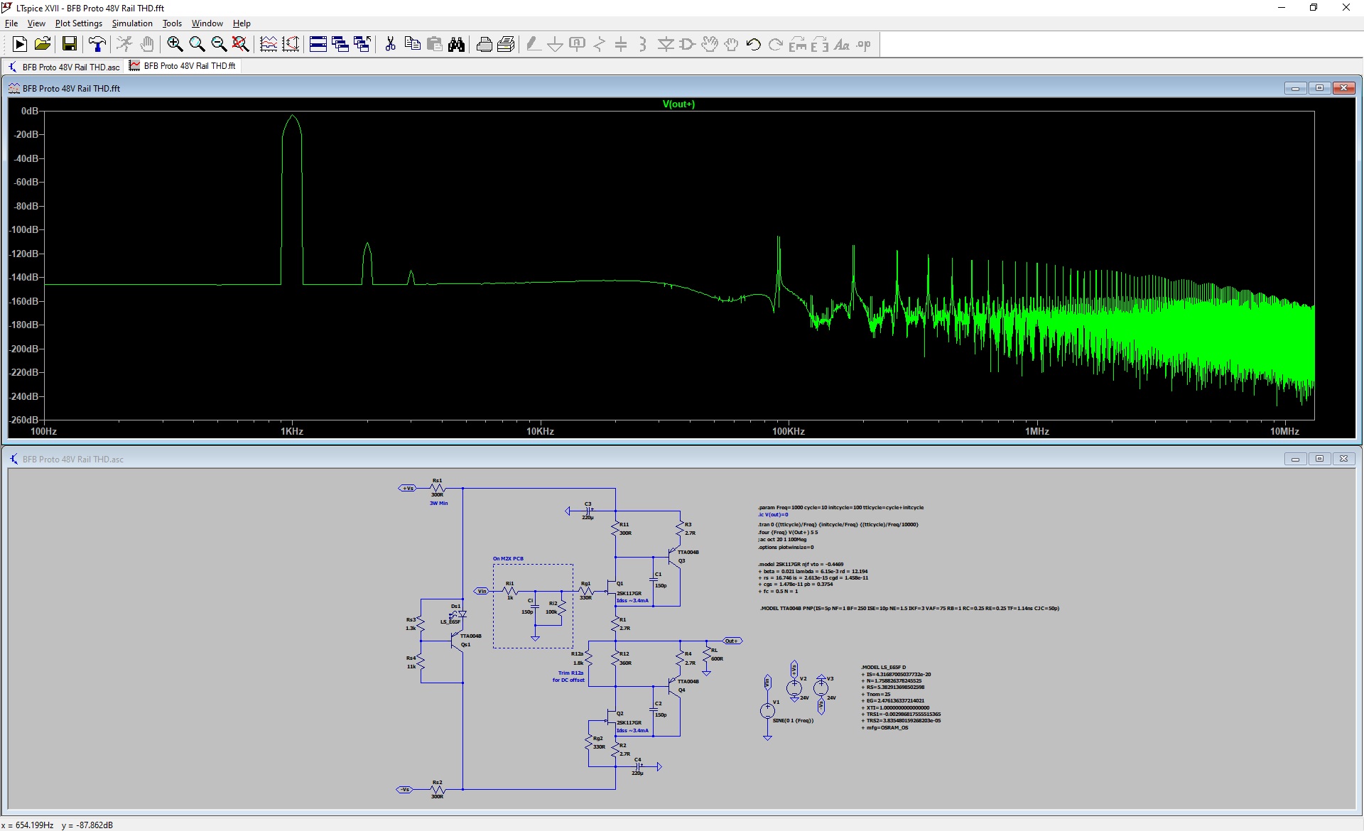

with 2SB649 more precise model

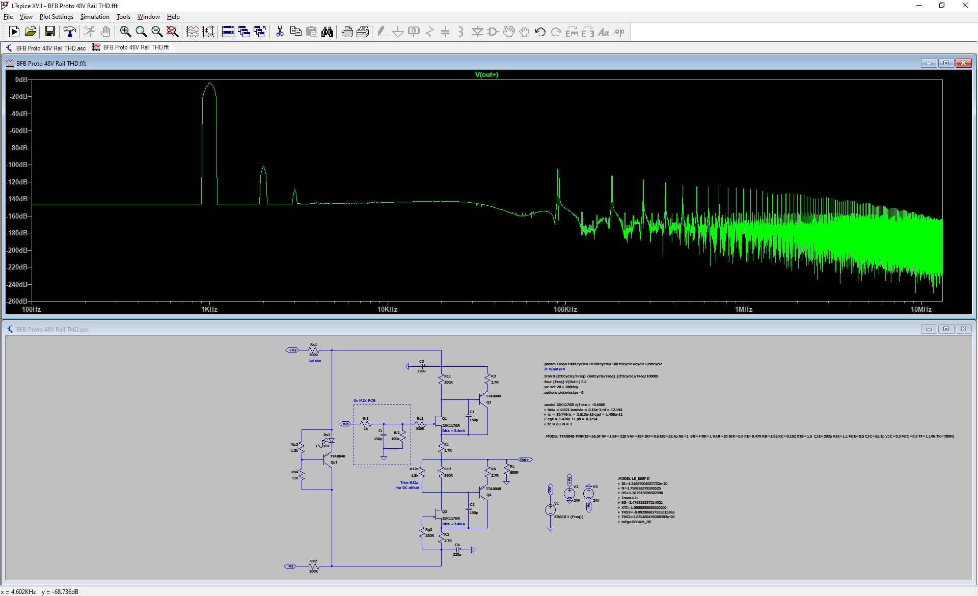

increasing vout to 10V
with TAA004B
Harmonic Frequency Fourier Normalized Phase Normalized
Number [Hz] Component Component [degree] Phase [deg]
1 1.000e+03 9.784e+00 1.000e+00 -0.07° 0.00°
2 2.000e+03 1.129e-04 1.154e-05 -90.06° -89.99°
3 3.000e+03 2.113e-03 2.159e-04 1.70° 1.77°
4 4.000e+03 1.368e-04 1.398e-05 91.47° 91.53°
5 5.000e+03 2.679e-04 2.738e-05 -175.70° -175.63°
6 6.000e+03 5.318e-05 5.436e-06 -86.72° -86.65°
7 7.000e+03 4.556e-05 4.657e-06 3.25° 3.31°
8 8.000e+03 1.166e-05 1.192e-06 86.48° 86.54°
9 9.000e+03 8.037e-06 8.215e-07 -151.64° -151.57°
Total Harmonic Distortion: 0.021854%(0.026769%)
with 2SB649
1 1.000e+03 9.791e+00 1.000e+00 -0.07° 0.00°
2 2.000e+03 2.686e-03 2.743e-04 -88.97° -88.90°
3 3.000e+03 1.302e-03 1.330e-04 3.90° 3.97°
4 4.000e+03 5.882e-04 6.008e-05 92.27° 92.34°
5 5.000e+03 2.915e-04 2.978e-05 -174.17° -174.10°
6 6.000e+03 1.513e-04 1.545e-05 -85.59° -85.52°
7 7.000e+03 7.892e-05 8.060e-06 4.63° 4.70°
8 8.000e+03 3.857e-05 3.939e-06 93.94° 94.01°
9 9.000e+03 2.096e-05 2.140e-06 -164.75° -164.68°
Total Harmonic Distortion: 0.031269%(0.034882%)

Circuit design groups in semiconductor companies routinely simulate random mismatch of devices on an IC, to get a feeling for what happens when two desired-to-be-identical transistors, do not wind up being perfectly identical. One experiment along those lines might be to use 2SB649A first model for one of the transistors, and 2SB649A second model for the other transistor. Besides the usual Monte Carlo approach of varying the base depth and the emitter area according to some probability density function, then simulating a few thousand random examples to estimate their effect upon circuit performance.

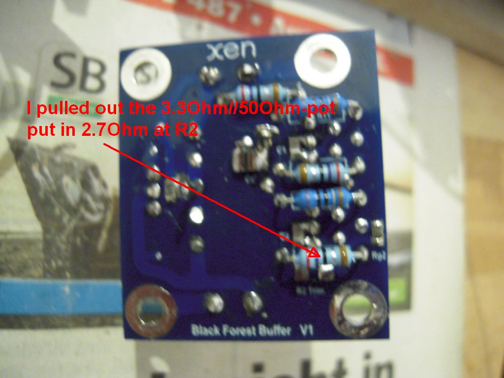

Good evening,
I made some progress with the Black-Forest-Buffer:
I have made a lot of tests yesterday and this evening. I tried to dial in the DCoffset on both bufferboards. It was pretty easy, to get it below 10-15mV.
DCoffset was fluctuating a bit.
Then I've got the tip from Patrick to put the R2 and parallel R2trim-pot(bias resistor lower half) out and to solder a 2.7Ohm resistor in.
And voila! Very low offset (3mV and 1.8mV on the other board).
So, my matching of the JFets and the TTA004 can't be so bad?
Some pics from my 'journey'.
Greets
Dirk

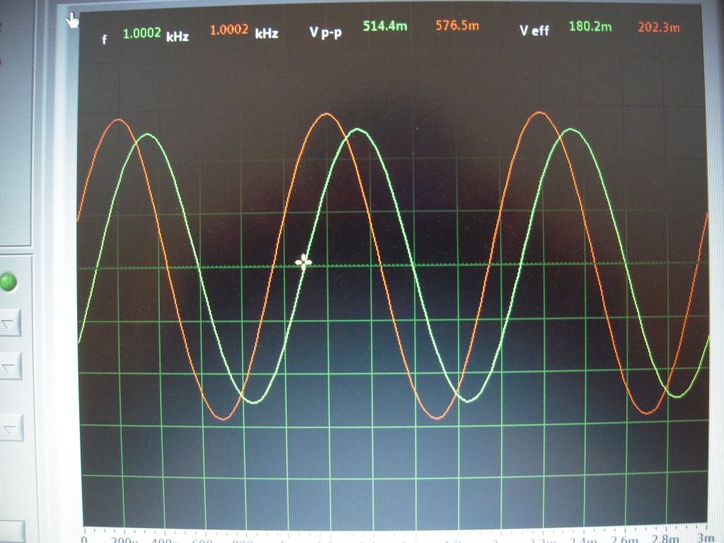

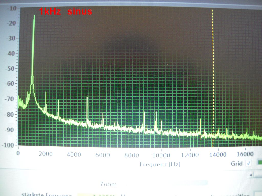

M2X - BlackForestBuffer
I also made a 'fast and dirty' measurement with my simple PC-oszi.
I have sent a 1kHz - sinus at circa 0.6V through that little thingie...
I know - this is not a professional measurement. Please be patient with me
Greets
Dirk
