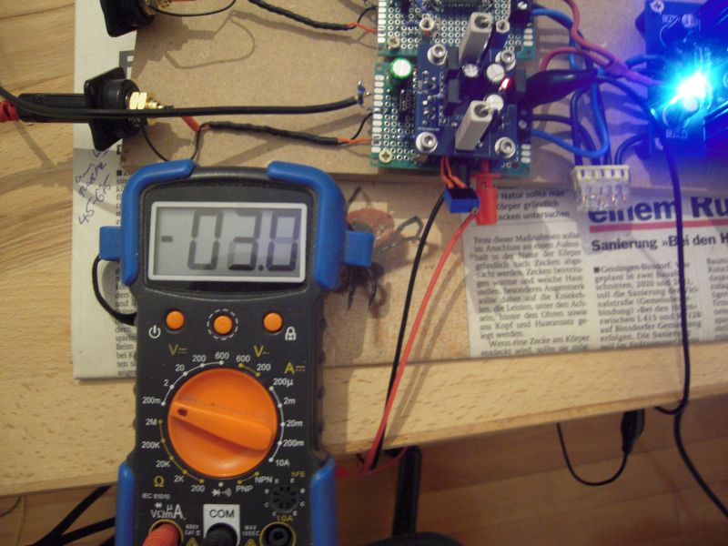

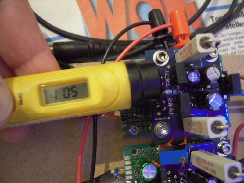

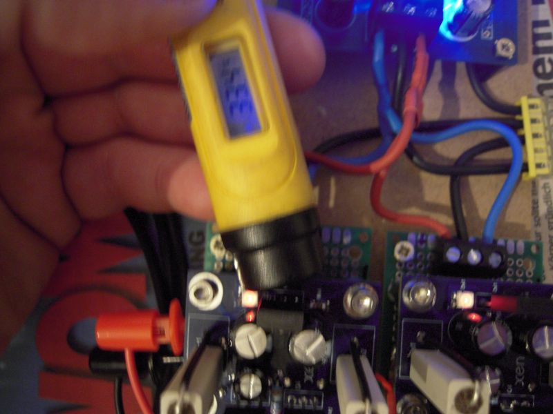

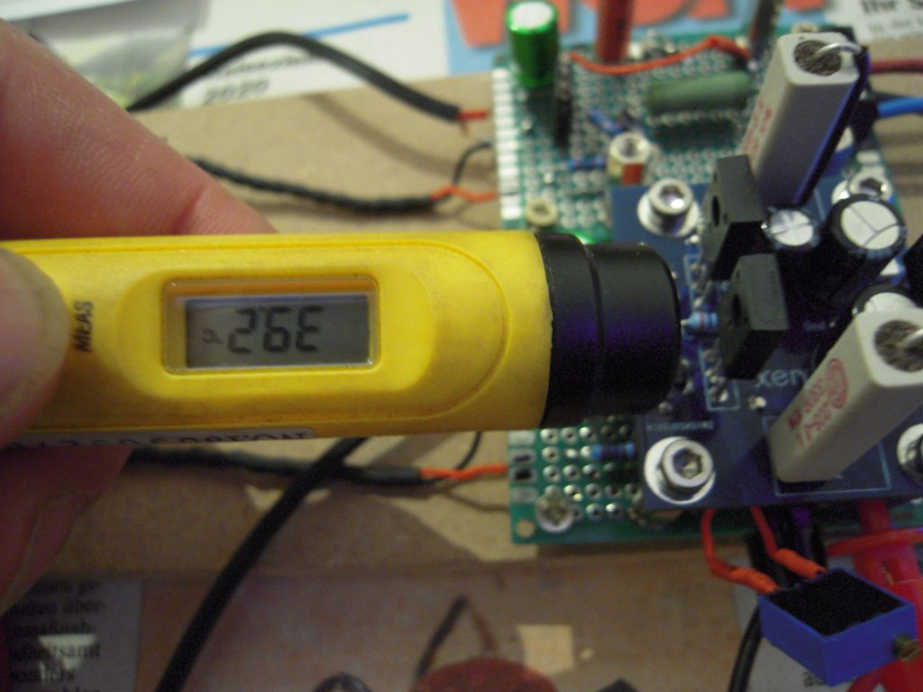

I have made some tests with the M2X-Black-Forest-Buffer:
DCoffset has settled in to around 3mV.
Temperatures are at around 40°-43°C at the TTA004s (Q3/Q4)
TTA004 (Qs1) is at around 30°C.
The Jfets are difficult to measure , but are at around 35°-40°C
Greets
Dirk

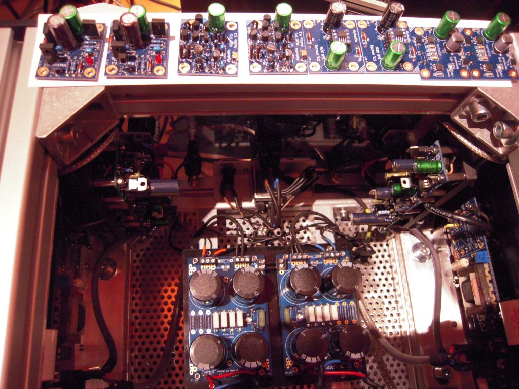

Hello Ake,
I have built and listened to many M2X-daughtercards till now.
The only statement I can surely make: they all sound really good!
There is no 'bad' daughterboard. They have different characters.
Some are a little bit better. But that strongly depends on your listening taste.
And the rest of your setup.
Sorry, I can't say - this is the best!? Or: you must built that! 🙄
Built them and make your own experience - it is a nice hobby...😀

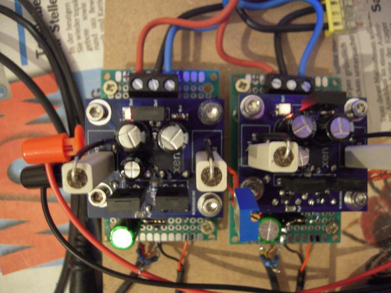

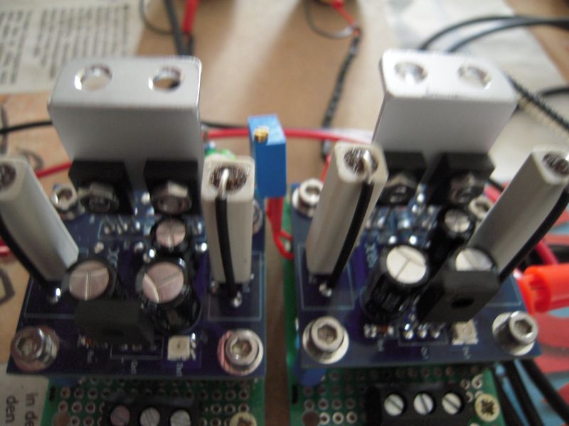

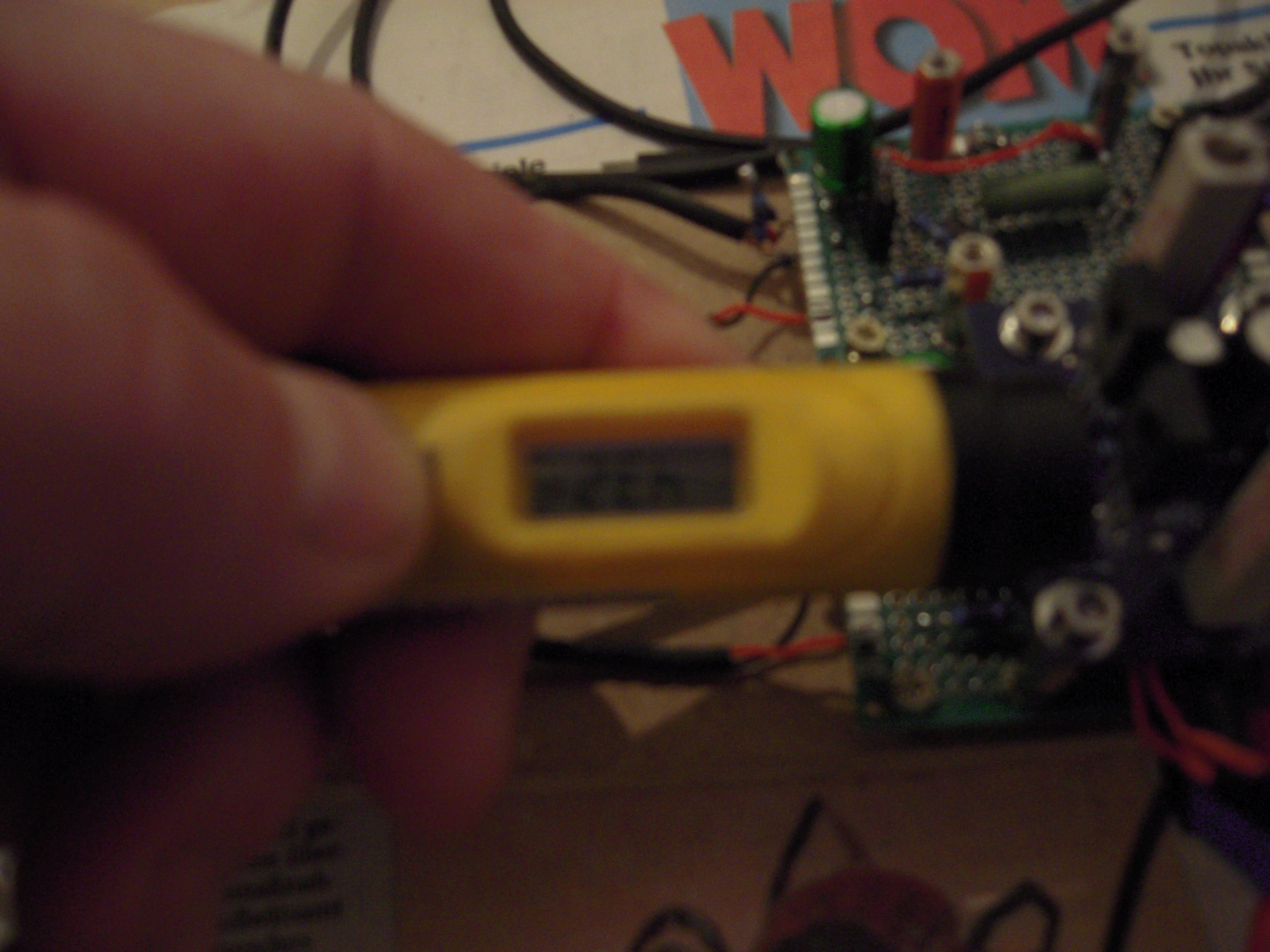

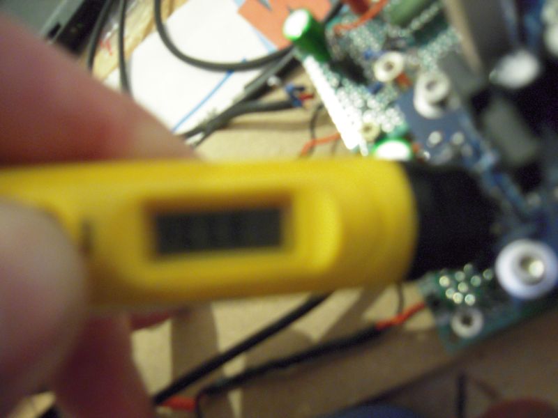

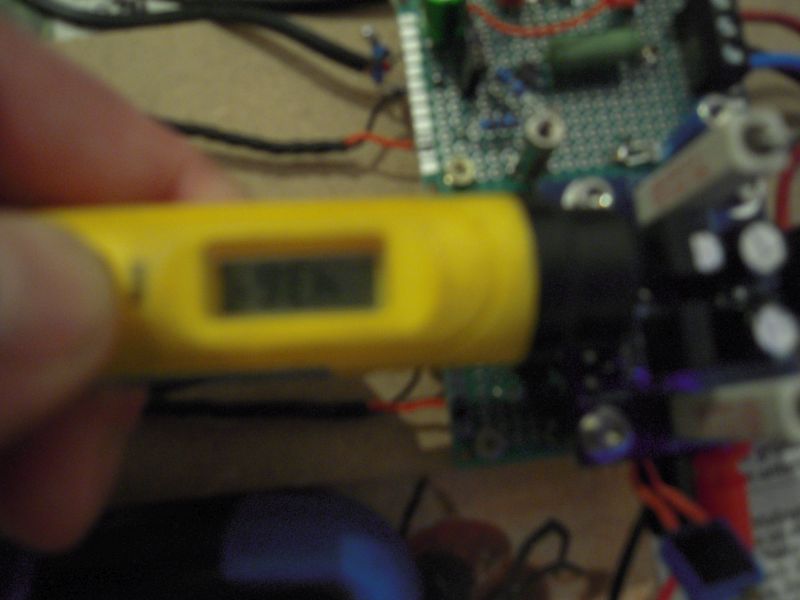

M2X - BlackForestBuffer
second board is cooking...
runs hotter TTA004 (Q3/Q4) at around 50°C - but i think they will settle in.
I need a break! :drink:= 😀 x fun²
Good night!
Dirk

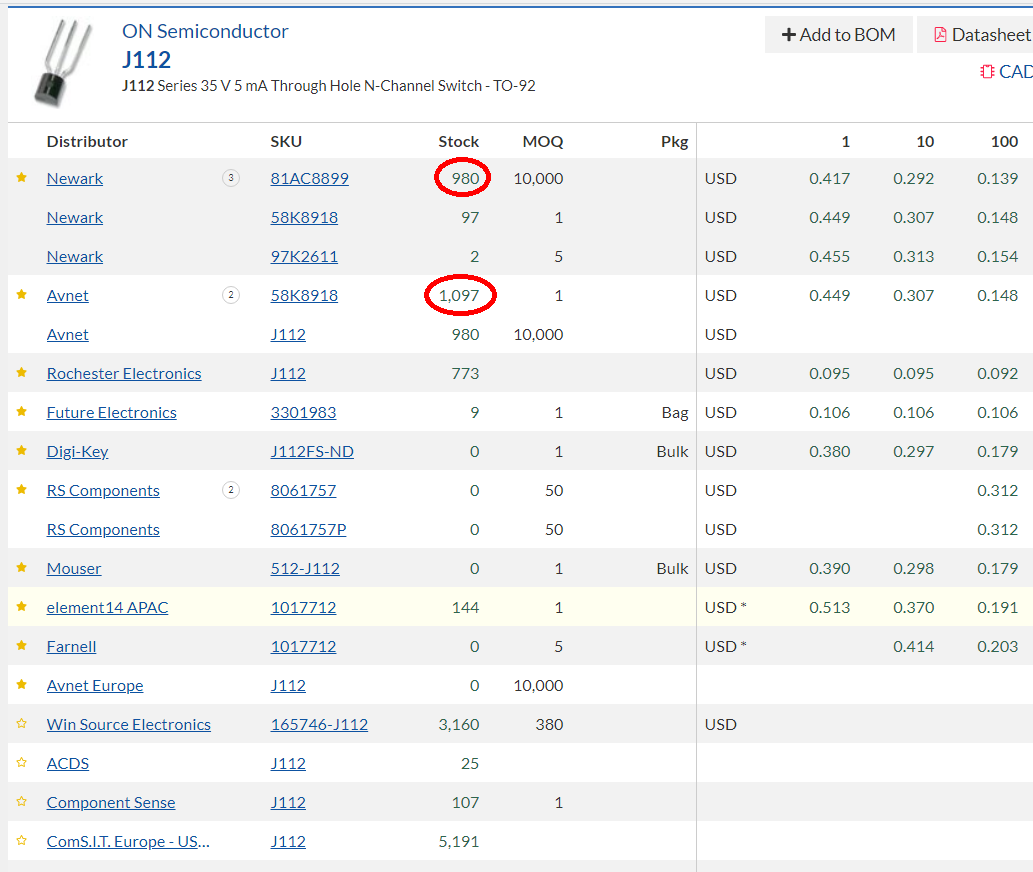

Train your fingertips to type
octopart.com​
and also
findchips.com​
You'll discover that there are tens of thousands of J112's on the shelf, ready to ship out, in surface mount packages. The website findchips.com tells you the magic prefix that goes before "J112" to indicate you want the SMD part. Then mount it on an adapter PCB or else just bodge some wirewrap wire leads.
You'll also discover there are TO-92 (thru hole J112) parts on the shelf at other US distributors, image below.
