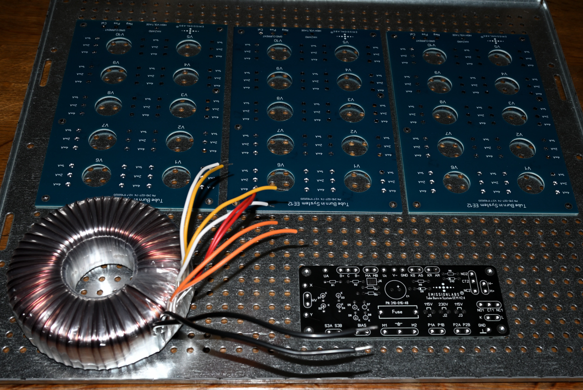

Not been that active in DIY audio this year but have an ongoing project building a tube burn-in tester for ECC81,82,83 and those double triode types input tubes. Not because I really needs it but because it could be fun. I have a 300B SE amp that use ECC83 as input tubes. And why I build it in the largest configuration to be able to burn in 30 tubes in parallel....I don't know either.....other than it looks good.....

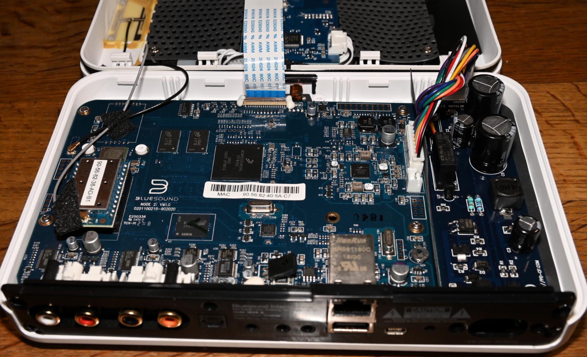

Also upgraded the PSU in my Bluesound Node 2i streamer/DAC so there is no SMPS inside the chassis. I did not expect any change in sound but I must say....."it did something"......so I can recommend this upgrade. On paper the new PSU is much more quiet than the original.

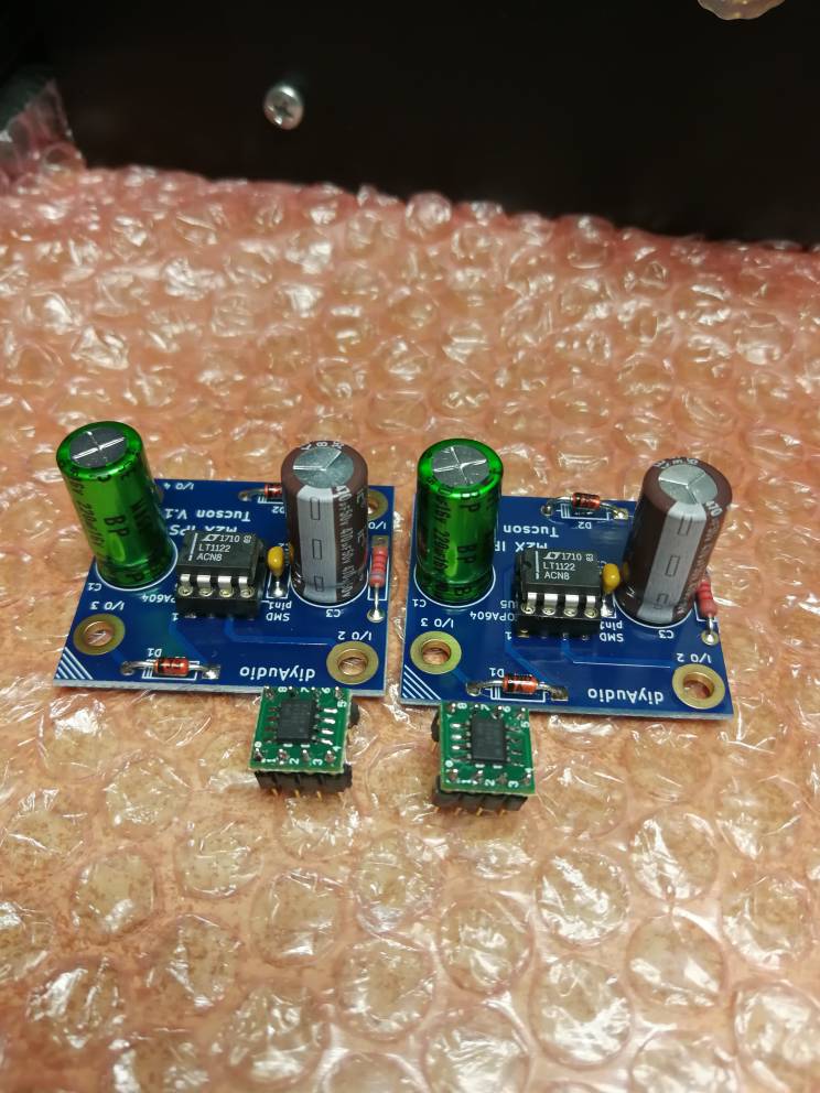

these work great—I think you can find them a lot of places—Mouser carries them—not sure about the EU...
SparkFun SOIC to DIP Adapter - 8-Pin - BOB-13655 - SparkFun Electronics

Thank you!
I found some PCBs from Germany at Ebay. They are PCB only so need to find the SIL pins also.....maybe I already have some.
The PCBs has two "fingerprints". SOP8 on one side and TSSOP8 on the other.
I have decided to solder them on input boards so I will not install DIP8 sockets. I have multiple sets of IPS7 boards.
