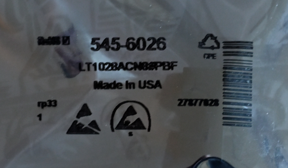

I received some components today for IPS7 and Cedarburg input boards. A surprise again that still some silicon is "Made in USA".
The LT1028 opamp has printed that they are made "locally"?
In California maybe?
The two other opams are from Philippines.

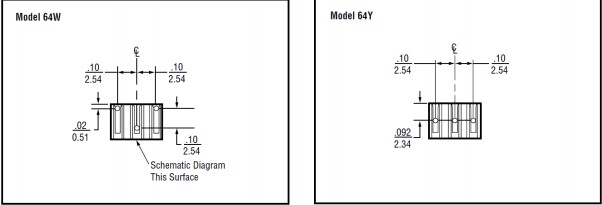

The 5k trimmer part number for Mouser is incorrect - does not have the pins in a single line, they are offset - part#858-64WR5KLF
According to the datasheet "64W" is offset and "64Y" is in-line pins. Snip from datasheet is below to confirm. The correct part# should be "858-64YR5KLF"
also - I missed the suggestion to change R6 to 37k and RV1 to 20k, went by the BOM and ordered before carefully reading all the notes in the zip file - my bad! Would it be sacrilege to add these as "alternative R6 and RV1 - see notes" on the BOM?
I guess it's good the trimmer was wrong (maybe), because I would have to order again anyway, and now I'll order the 20k version and revised R6.
These alternate part numbers are:
KOA Spear 37k - "660-MF1/4DCT52R3602F"
Alt. RV! - "858-64YR20KLF"
