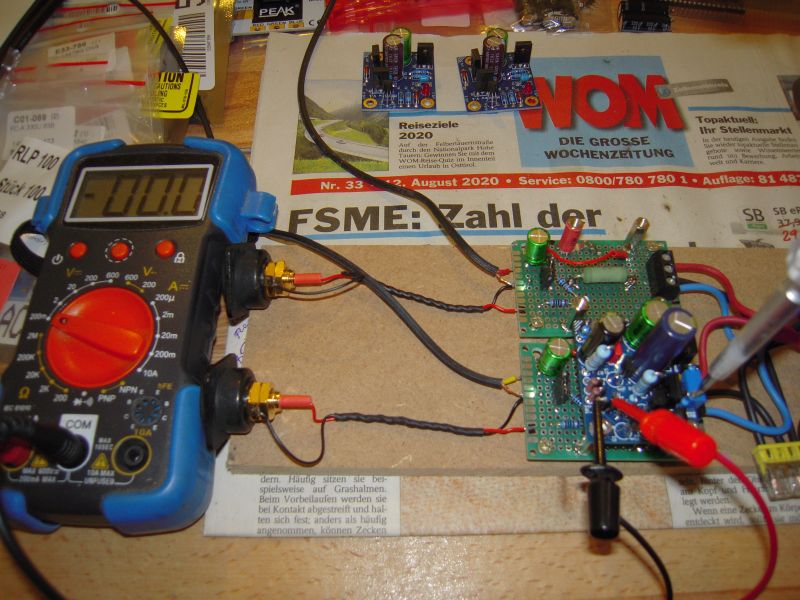

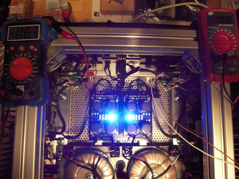

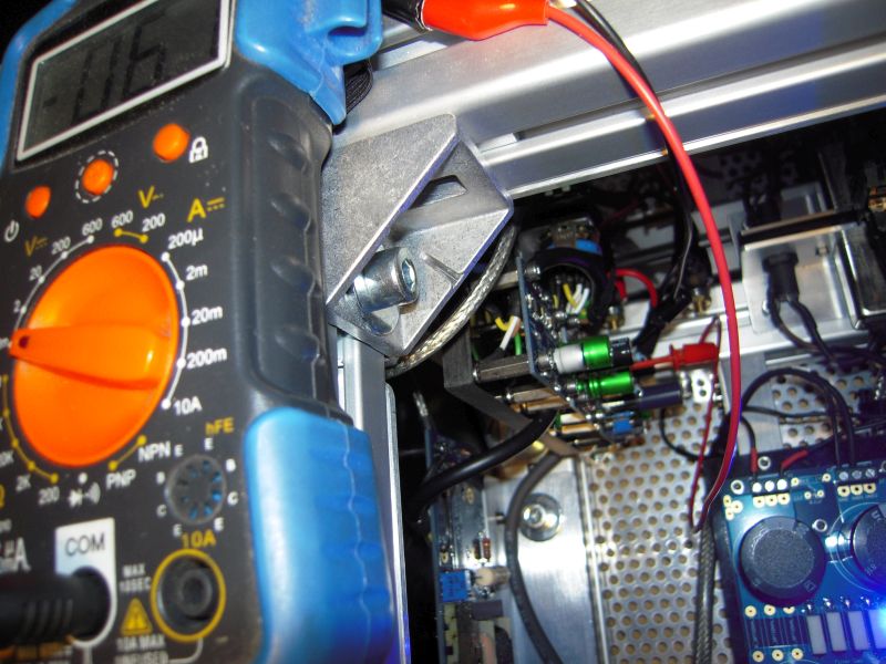

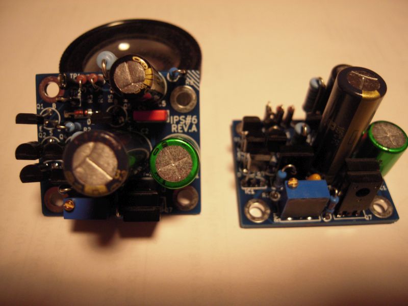

IPS6 - boards stuffed
Hello M2X-builders,
I've got the rest of my parts for the IPS 6 - boards. Stuffed them yesterday.
Some adjusting - first on my 'test-rig' than in the amp.....
No listening yet - I can't tell you how it sounds..... 😕 later 😀
Thanks to Mark Johnson for a new inputboard!
Thanks to Ake for the group buy of the pcbs!
Greets
Dirk

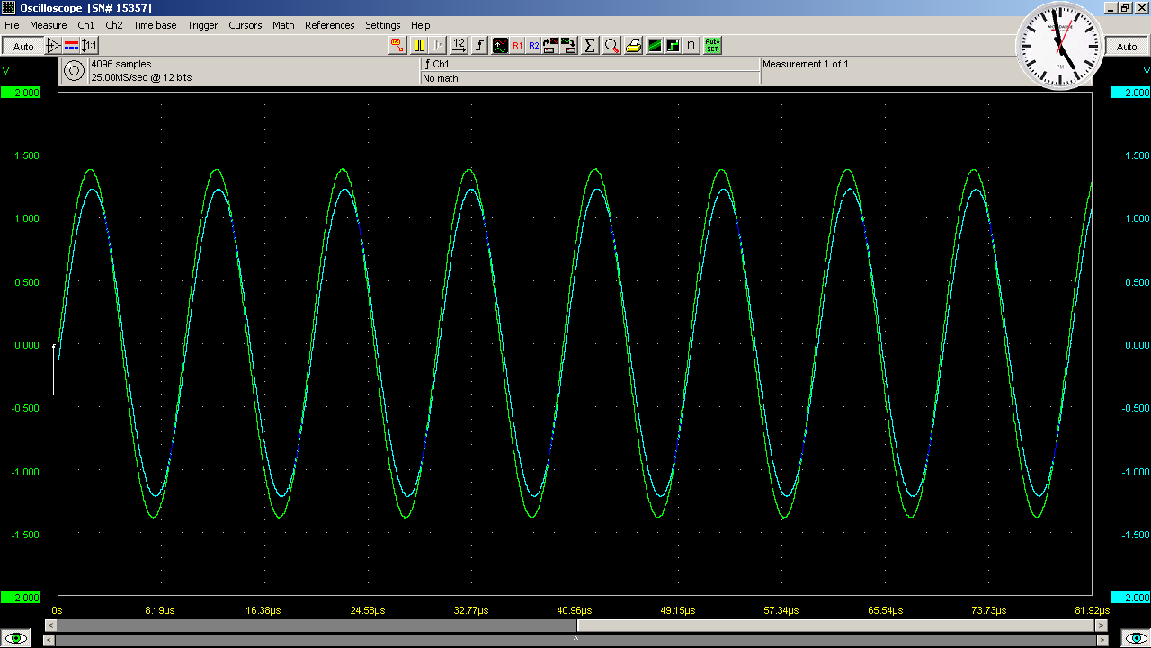

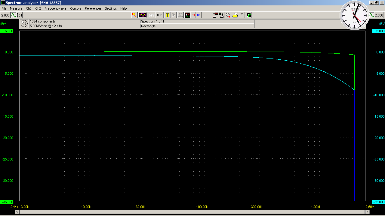

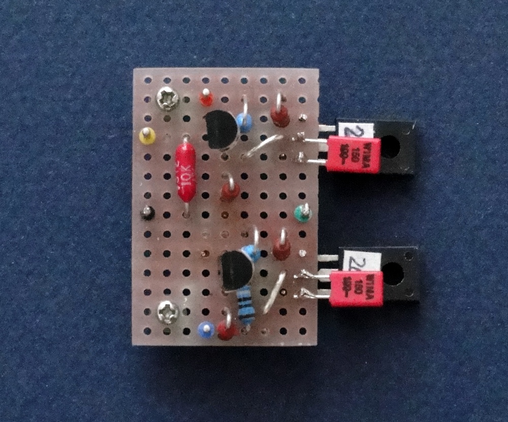

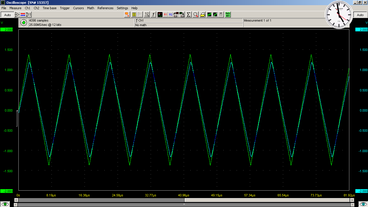

Black Forest Buffer Proto
I was curious myself how this would work in reality.
So a quick & dirty Vero proto using what I had in the drawer.
The bandwidth is way beyond 2MHz (my spectrum analyser limit).
But it is also very good at picking up HF noise, from LED lamps, laptop SMPS, ..., etc.
So I put in an RF filter at the input, and also two caps at the BJT to enhance stability.
The schematics attached is as built, with 30mA bias.
Also attached frequency response, 100kHz sine, triangle and square, after all the above measures.
QED, 😉
Patrick
QED, 😉
Patrick
to EUVL
Hello EUVL,
measurements look nice! 😀
I still have a few matched Toshiba TTA/TTS 004. I think I should try this?
Greets
Dirk
Hello EUVL,
Greets
Dirk
600R, as in the transformer.
Incidentally, the measurements were made when Ri2 was 10k.
Hence the 0.9x gain.
The buffer itself has a Zout of only a few ohms.
Patrick
Patrick

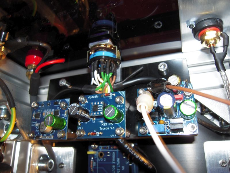

Hello M2X-builders,
That enclosure looks phenomenal!
Could you post some more pics?

Thanks, looks fantastic.
I see you setup a switch for the input cards. That's very cool! It takes me ~1h to change out the cards... 😱
That’s a really neat idea. Food for thought for the next one I build. First one i just finished was destined for the living room but is still in my office/workshop/spare bedroom and I’m loving it so much I’m not letting it go.

@EUVL,
thanks! WRT rail, we could graft your circuit onto one of the rail-stabilized cards like the IPS7 or IPS8.
I read somewhere here that it is important to keep the power dissipation down on the jfets in order to keep the noise down.
What's a good place to buy the authentic 2sk117GR?
Just use 2SK209GR.
It should not be using unobtanium.
I only used 2SK117GR for convenience on Vero.
Patrick
