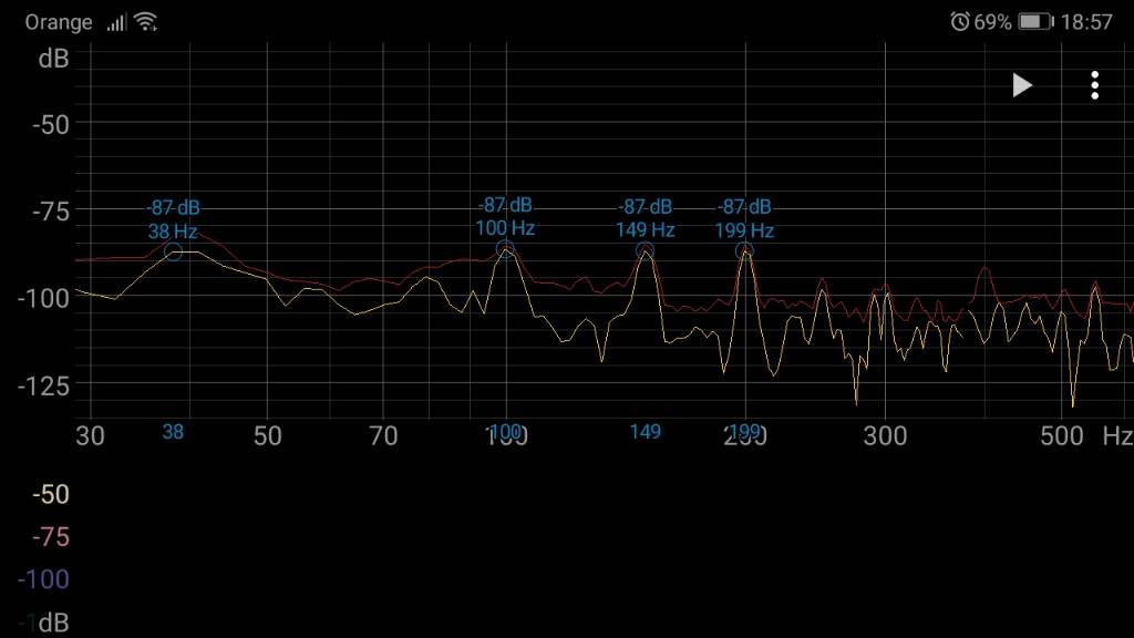

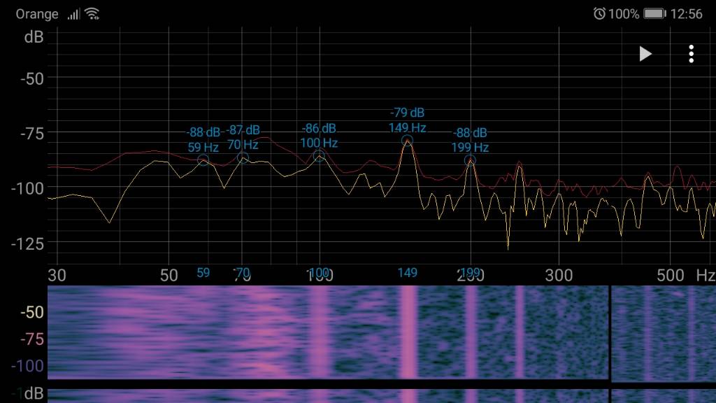

Some time I spent listening to the amplifier with the Ishikawa card. I can't describe music so beautifully, so in short: I'm impressed with the stereophony and the general culture of sound. I can and I want to listen loud and louder without getting tired. Cool.
About the hum, it is heard with the ear in the loudspeaker. Mumetal boxes have lowered the noise of 150hz by a few decibels and is now at the same level as 100hz and 200hz. What else can I do to get rid of this? Let me remind you, that the 100hz ripple from the power supply is at the level of 170mV Screenshot_20210206_185723_org.intoorbit.spectrum.jpgLChn%20przed%20mumetal.jpgszumy%20zasilanie%20plus.jpg

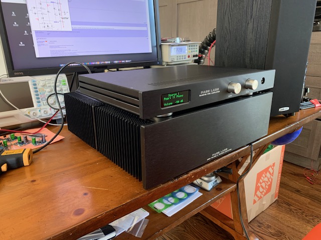

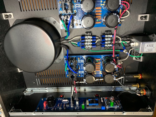

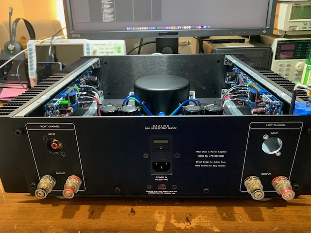

I tried installing all of the boards I have built up so far tonight, just to make sure they worked, and all was good. The Austin ones are currently in there and will stay for at least a month or two. Who knows, they may end up staying in there a lot longer.
Some quick pics from my phone. Apologies for the quality.
