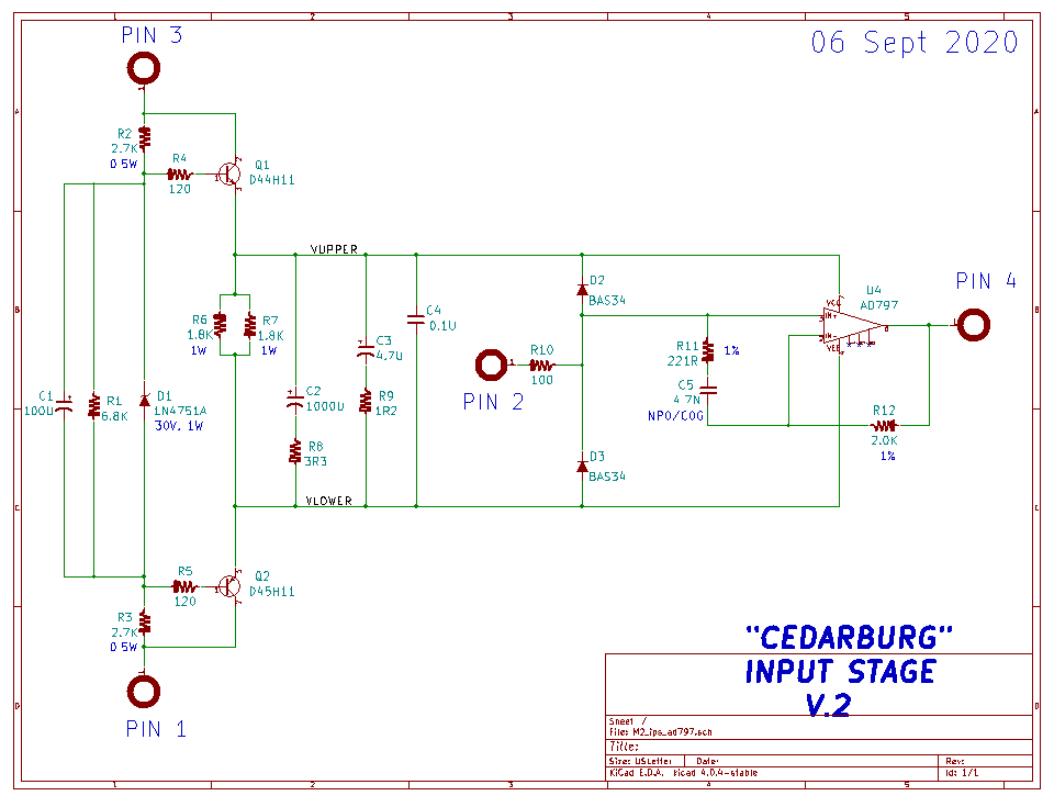

The Cedarburg circuit unveiled here does not oscillate, thanks to the use of Input Compensation: R11,R12,C5. (See Chapter 13, "Compensation Revisited", in the MIT Open Courseware documentation), and also thanks to a relatively elaborate power supply bypassing arrangement. Like all the other M2x input stage daughter cards, Cedarburg functions as a unity gain buffer and current booster, to drive the low impedance primary of the interstage transformer on the M2x amplifier PCB.

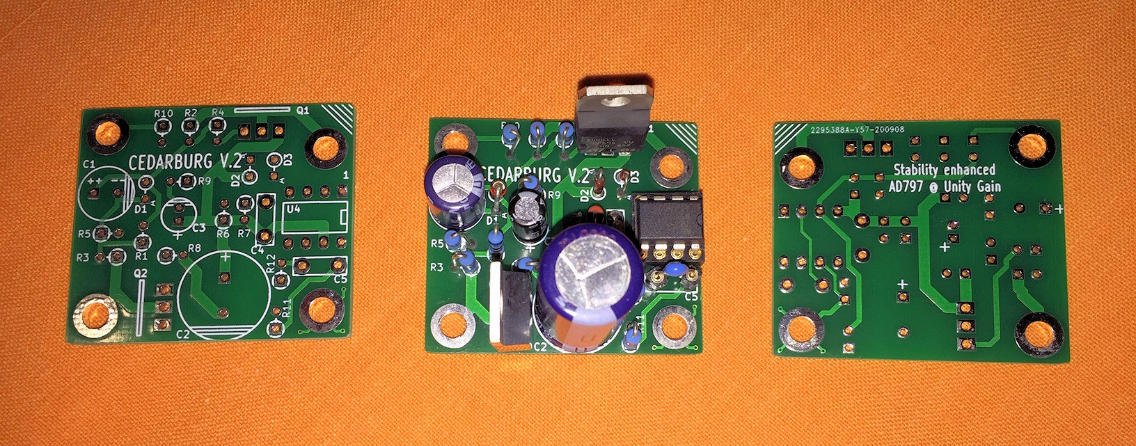

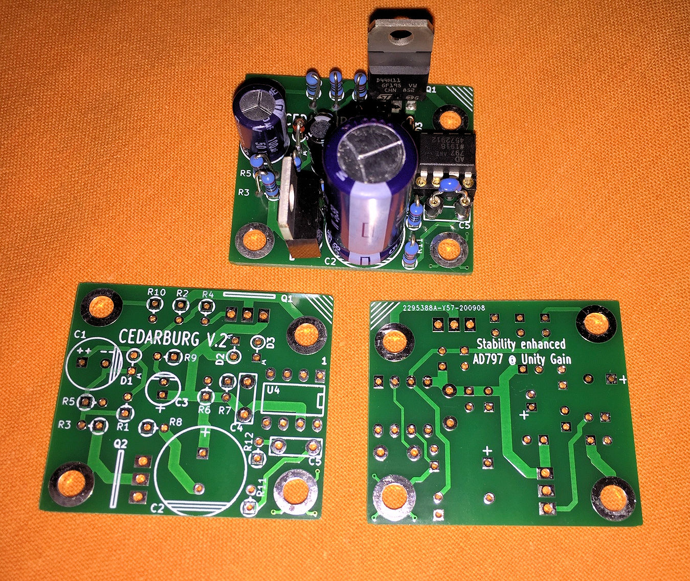

More than half of the components on the Cedarburg PCB are dedicated to power supply management and bypassing. This is because the AD797 is "twitchy" and needs wideband, very low impedance supplies.
D1, Q1, and Q2 regulate the supply voltage (VUPPER - VLOWER), setting it to (30V - 2*VBE), which is comfortably below the AD797's Absolute Maximum Rating of 36V. Bleeder resistors R1 and R6-7 discharge the internal supplies when the amp is turned off; they also establish minimum bias currents during normal operation.

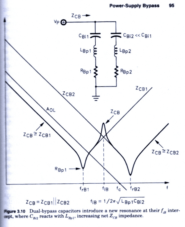

Internal supplies are bypassed by the parallel combination of C2 + C3 + C4, and capacitor self-resonances are damped by R8 and R9. Jerald Graeme of Burr-Brown wrote a book called Optimizing Op Amp Performance which devotes an entire chapter (pp. 73-102) to this phenomenon. One of his Figures is copied below.
These measures appear to have been successful; Cedarburg exhibits no power supply induced oscillation, at least, not in my lab tests.

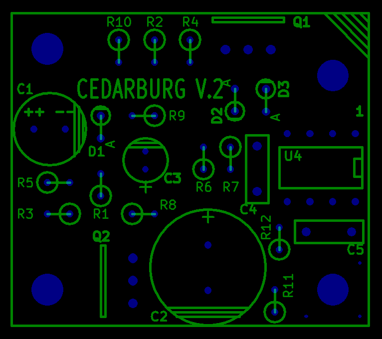

A zip archive of the PCB manufacturing files in Gerber format, is attached below. Also attached are a detailed Parts List and a circuit schematic diagram as a .pdf document.
