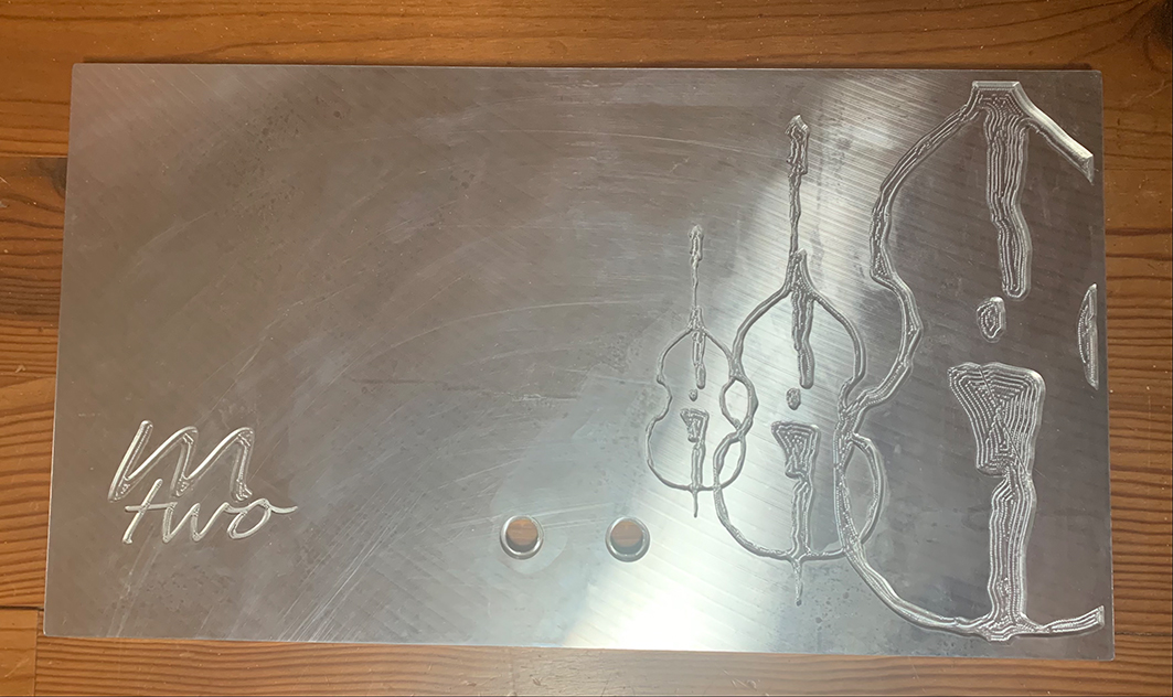

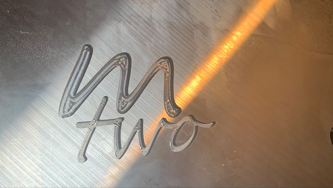

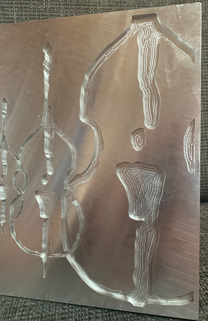

Very artistic, and technically well done.
Although I don't have the tools, talent, or creativity for that kind of work, I did order some Cedarburg PCBs (PCBWay), and the parts from Mouser today!
