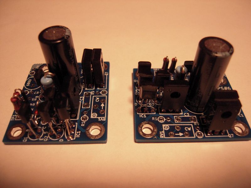

There are 6 sets of boards lefr from the GB (1set = 2 IPS6 and 2 IPS7)
If anyone is intressted.
IPS6 and IPS7 ( for M2x)

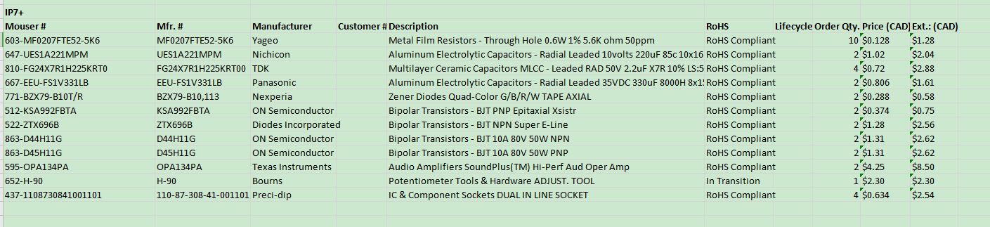

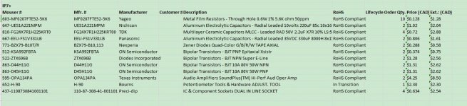

I just learned there is a mistake in the IPS7 parts list attached to the post #3408:
Mouser part for the sockets indicated in the list is 110-87-304-41-001101, but this has 4 pins in total, not 8. The correct part should be 437-110-87-308-41-001101.
Had to learn it the hard way - looking at the part in the pack from Mouser. IPS7 for my M2X will have to be delayed until I get the right ones 🙁
Thanks for catching that. The wrong part number was on my soon to be ordered BOM.

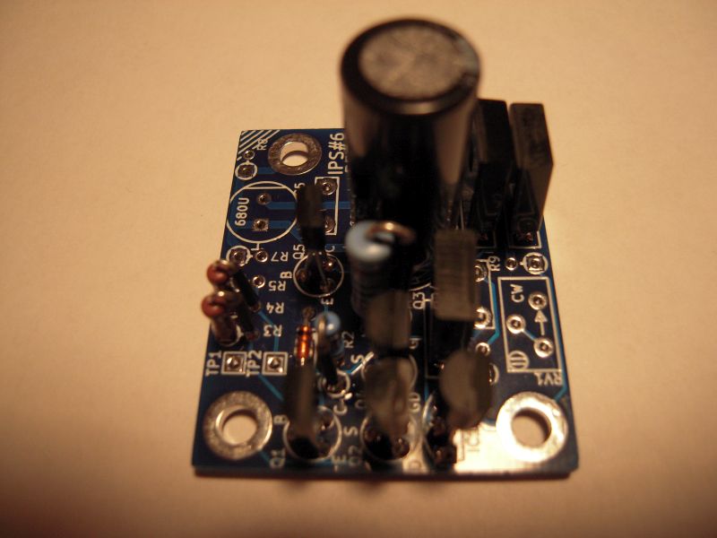

IPS6 - the start

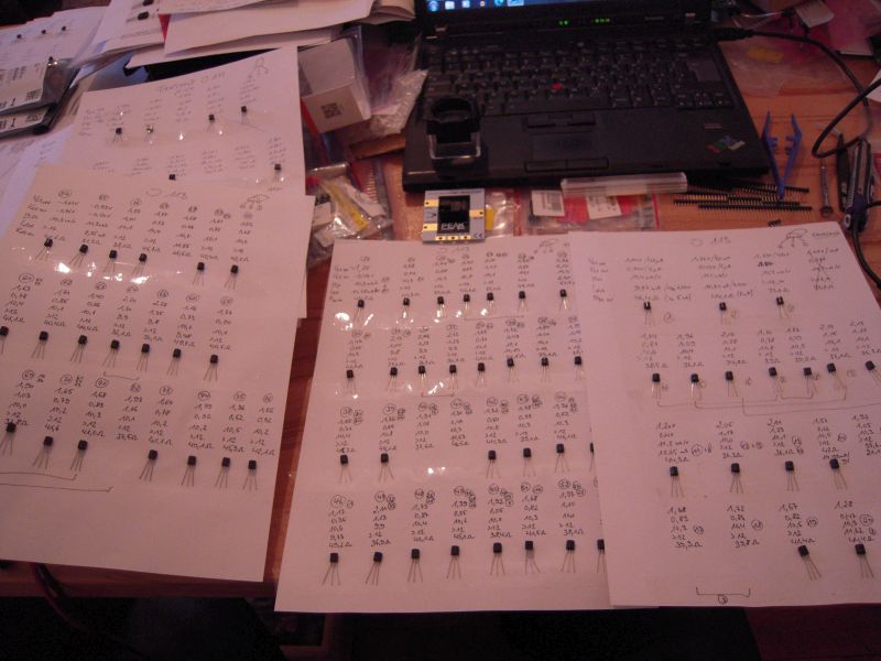

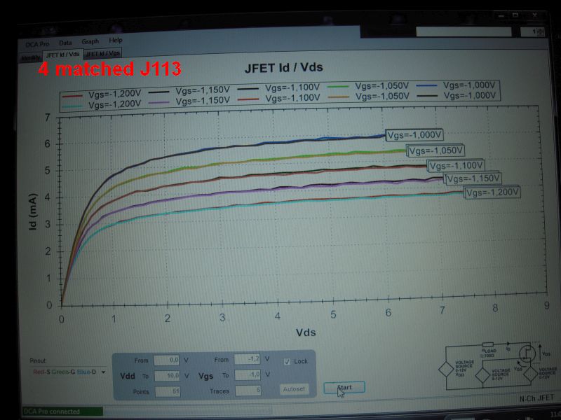

Hello,
today I played the 'matching' game. 4 nicely matching J113. Matched the output BJTs (PNP-NPN) and from Left-channel to Right_channel.....🙄
And slingin' the hot iron around beautiful legs.... 😉
Greets
Dirk 😀
